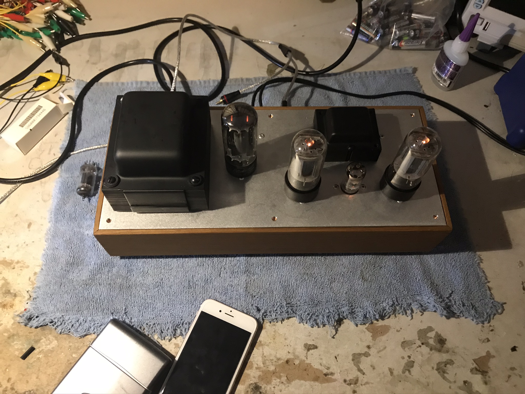

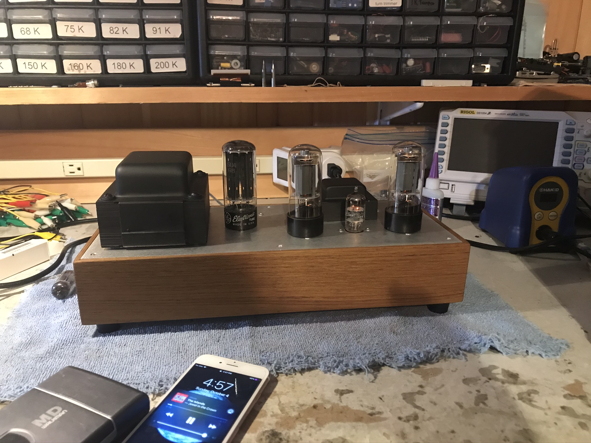

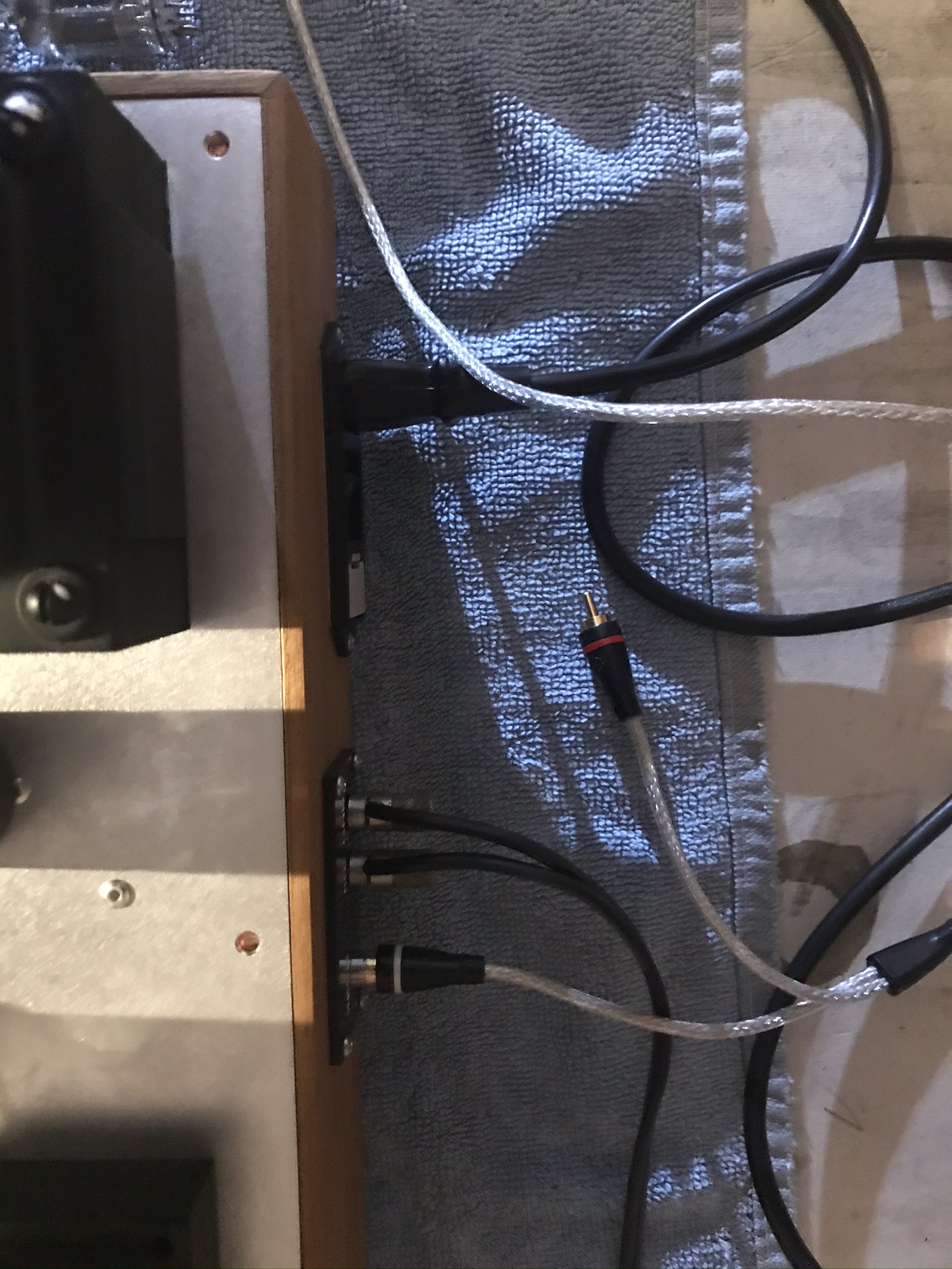

Wow, it's been a really long time since I've posted about this! Well, I finished it! I think it looks awesome. My dad made the case, and I think it looks excellent!
The top part is a routed aluminum plate, we cut a template with our laser cutter, and then routed it by hand. The case is made with teak, and the bottom has an aluminum mesh. The inside is covered with copper tape for shielding reasons, and all the metal parts are grounded.
You might notice the tubes that are installed are not 6V6s. Well, as it turns out, my 6V6s are kind of dead. I think I need to buy a new matched set, so in the mean time, I was experimenting with 6L6s. Sounds good to me! Also, disregard the 12AT7 that's installed.
Attached are some photos! Thank you to everyone who gave me advice on this project, I really appreciate it!

Looks nice.
Is your power transformer strong enough for the double heater current 6L6 900mA versus 6V6 450mA ?
