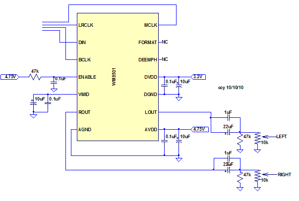

:rain: I added a pot at the output stage, which i might want to drive Headphone/earphone. Do i need to increase the value of the capacitors?
Do this see ok?

Now we are going for a wolf 8501...
Pots in the right place. it doesnt have to be 10k, but it can be since your using 22uf caps, so id stick with the 10-25k mark. You will now have to buffer the output of the pot with a opamp to run headphones. You cant have a pot and run headphones directly at the same time.
i dont have much experience with running an opamp without an negative supply. You would need something that works at low voltage (5v rails) and runs at or below unity gain. Again you could run the opamp directly from usb via a ferrite bead and run it in unity gain. Amb used a AD8656 for the headphone version.
Yes your output would need to be cap coupled and be big like your original design.
Actually in the Gamma 1 the headphone output is from the WM8051 directly so no opamps. The 8051 is capable of driving headphones directly and it runs off of a 5v supply. It's a pretty handy chip.
Then again, the PCM2707 does this too, it just sounds worse. 😀
