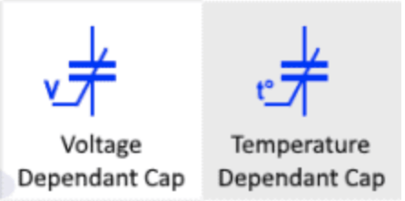

My bad. They are lacking the + for the polarity marking, though. I'm reminded that my knowledge of European schematic symbols isn't as sharp as it once was.
I guess we should start using a parallel combination of these for ceramic capacitors with Y5V dielectric... 🙂

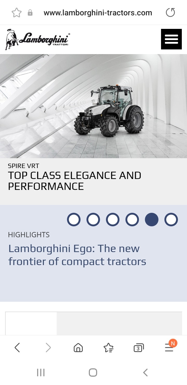

Good catch on the Lamborghini.
Lambo was really a tractor company. The boss used tractor profits (and Fiat parts-bin) to fund & build a sport-car addiction. (Since 1973 the sportycar side spun-out through Chrysler and etc to VW. Lamborghini Trattori still builds dirt-machines.)

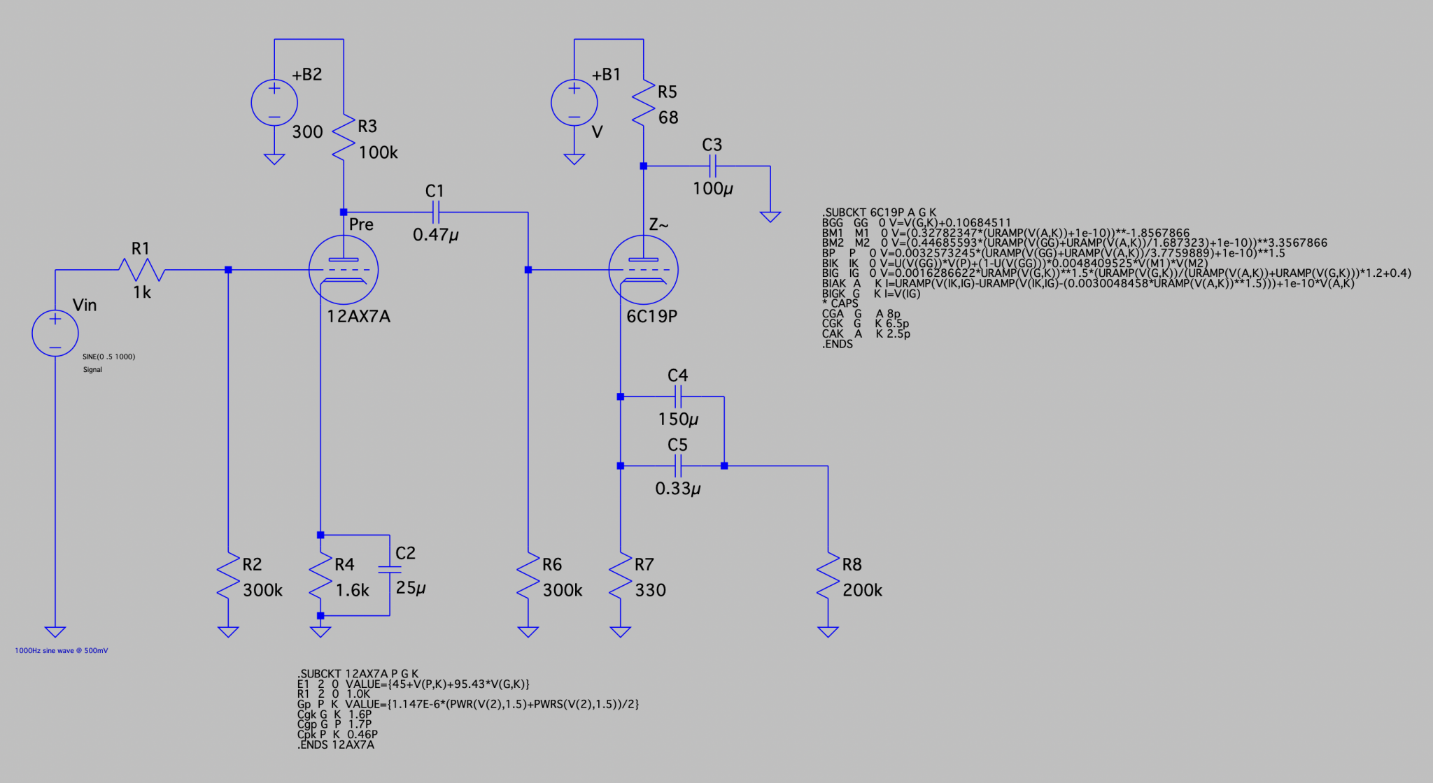

I was wondering, would it be possible to simulate this circuit in something like LTSpice?
I remember trying that tool before and it was quite a learning curve, plus I’m not sure if there good models for the 6C19.
Yes you can. I use it very often. DC working points are pretty accurate. AC sometimes is fine, but sometimes not so much. THD is always on the optimistic side.
LTspice is quite good at telling you what not to do.

Well, I learned enough to make this:
Now, I need to figure out the magic LTSpice directives to make it tell me things...
