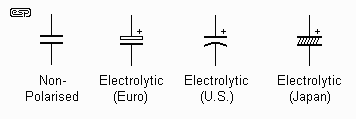

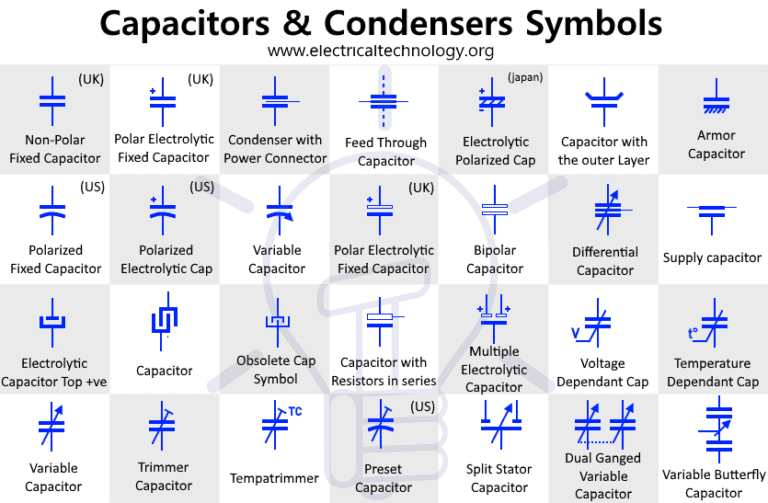

Note that all the electrolytic capacitors on that schematic are drawn with reverse polarity. The rectangle is supposed to be the can (cathode, negative). The line is the positive (anode) terminal.

The capacitors are drawn correctly. The 'fat' side is the anode, at least according to modern drawing standard.Note that all the electrolytic capacitors on that schematic are drawn with reverse polarity. The rectangle is supposed to be the can (cathode, negative). The line is the positive (anode) terminal.

My bad. They are lacking the + for the polarity marking, though. I'm reminded that my knowledge of European schematic symbols isn't as sharp as it once was.The capacitors are drawn correctly. The 'fat' side is the anode, at least according to modern drawing standard.

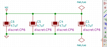

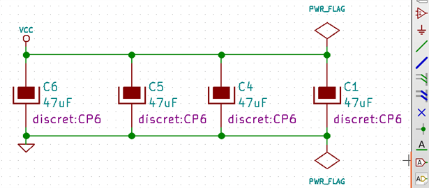

I guess we should start using a parallel combination of these for ceramic capacitors with Y5V dielectric... 🙂
