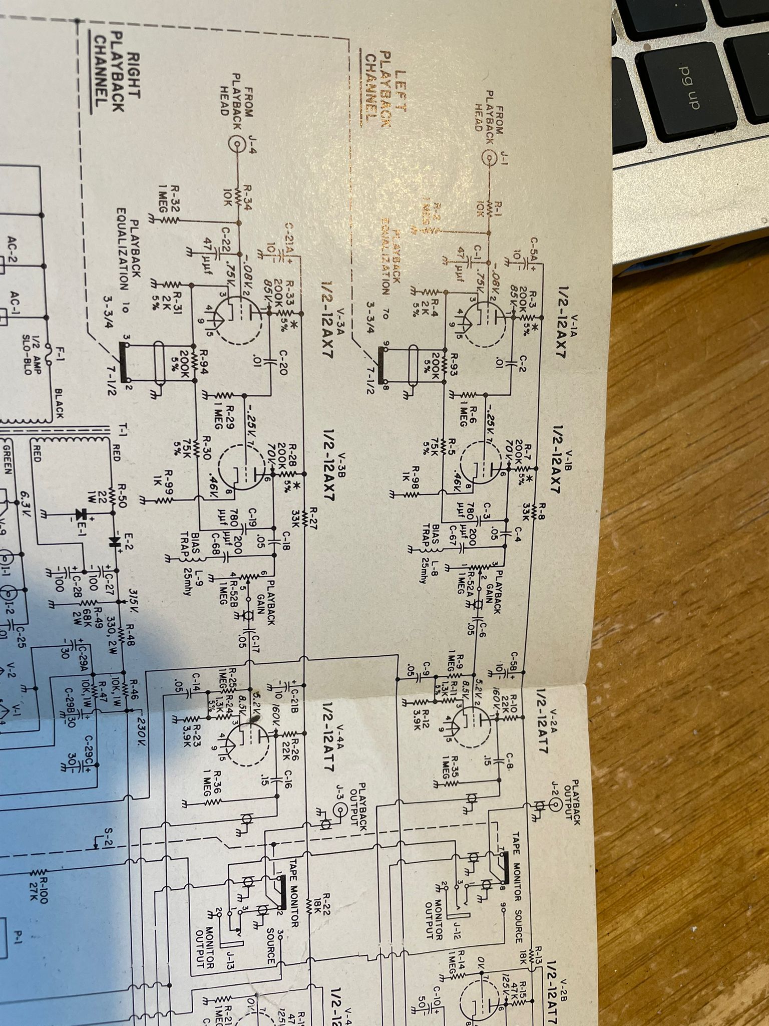

I wonder if someone could suggest a good source of information, either in print form or online is fine, for understanding a particular negative feedback circuit as it applies to shaping an EQ response. In other words I would like to learn how it functions (I have a good idea of the basics) and what the mathematics are for determining component values and how to change them to achieve different requirements. This is the circuit I'm interested in:

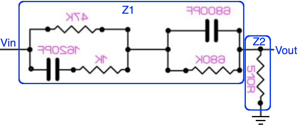

It's actually pretty simple ... in theory. As you've undoubtedly found if you read Lipshitz' paper, the math gets hairy in a hurry. But in theory the feedback network is "just" a voltage divider:
Pardon the mirror image for Z1. So now you can derive the divider ratio as:
Vout/Vin = Z2/(Z1+Z2)
Trouble arises because Z1 depends on frequency and that makes the math a bit complicated. It should be no trouble to play with the divider in a simulator and get some understanding that way, though. Keep in mind that the frequency response of the amplifier overall will be approx. 1/ß, so (Z1+Z2)/Z2, assuming you have sufficient forward gain.

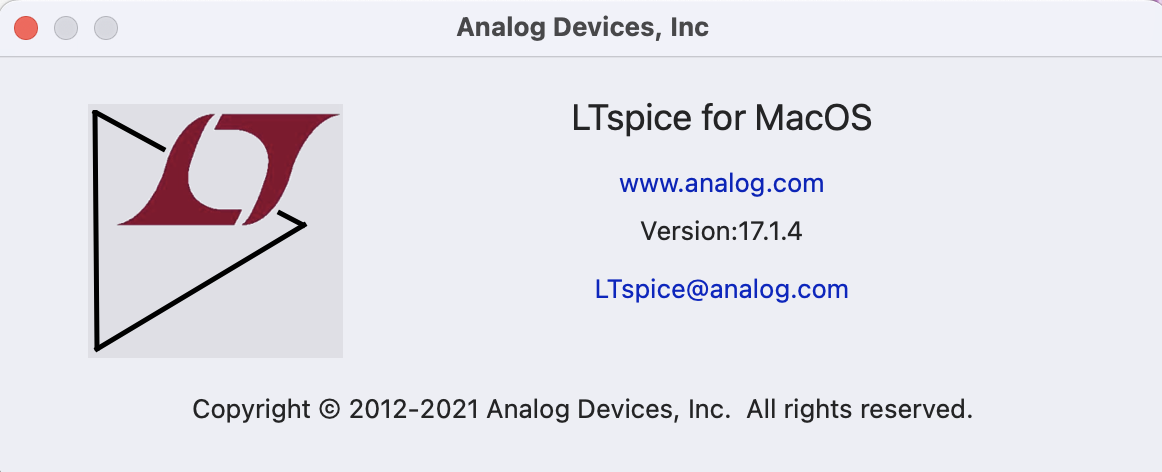

If you're new to circuit simulation, I suggest learning QSpice. I'm thinking LTspice has become abandonware now that the author is with Qorvo.
