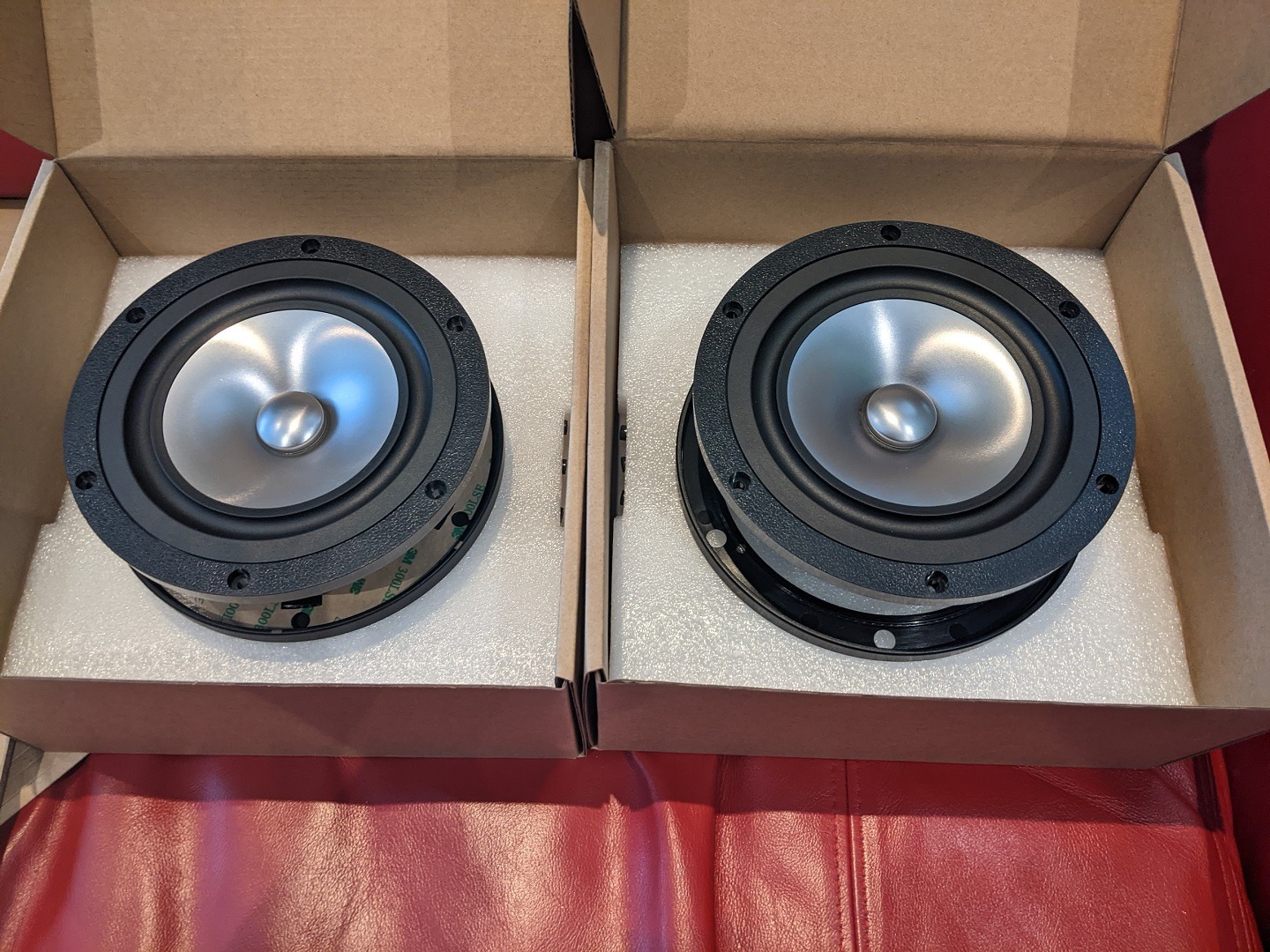

I just took delivery of a new pair of Alpair 10.3M
I'm hoping to Enabl them. One day. I'm slow.
But as a calligrapher, I note that Speedball makes "chisel edged" nibs -- the "C" series I use -- that might help apply a more square "dot" than the "A" style. Bud seemed to feel a square shape is more effective.
The templates look promising. Some guidance to the radius for each row for theA10.3 would be welcome.
Not sure about the best paint to use to produce the optimal amount of applied "solids".
And then there's colour ...
