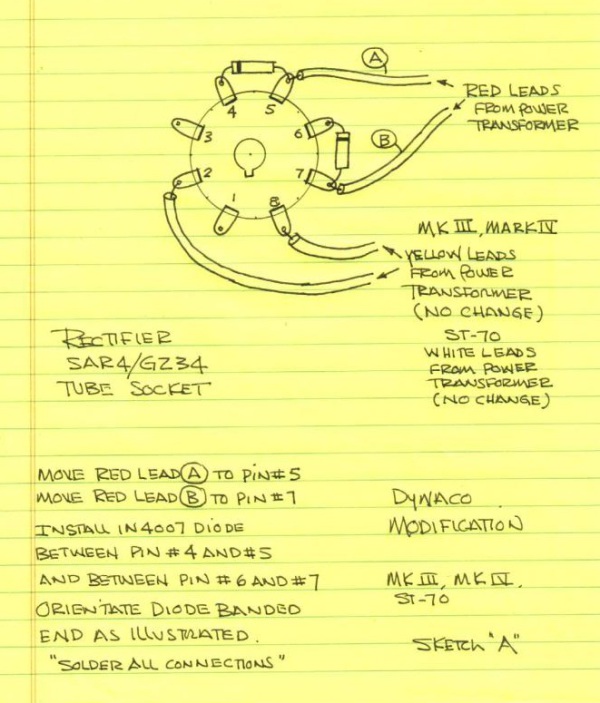

The SS series diode tweak makes the affordable Sovtek 5AR4 (GZ34) an excellent option. The New Sensor product is fully capable of delivering the rated 250 mA. The Saratov, Russia, product can demonstrate a weakness at the top end of the documented voltage range. The SS diodes in series with the plates add some PIV headroom and completely dispose of the matter.
FWIW, I prefer UF4007s over the 1N4007s shown. In spite of vacuum diodes blocking SS diode switching noise, my thinking is that less noise, from the outset, can't hurt and may help. UF4007s cost 41 cents in the U.S. and should be correspondingly low cost in the U.K.
