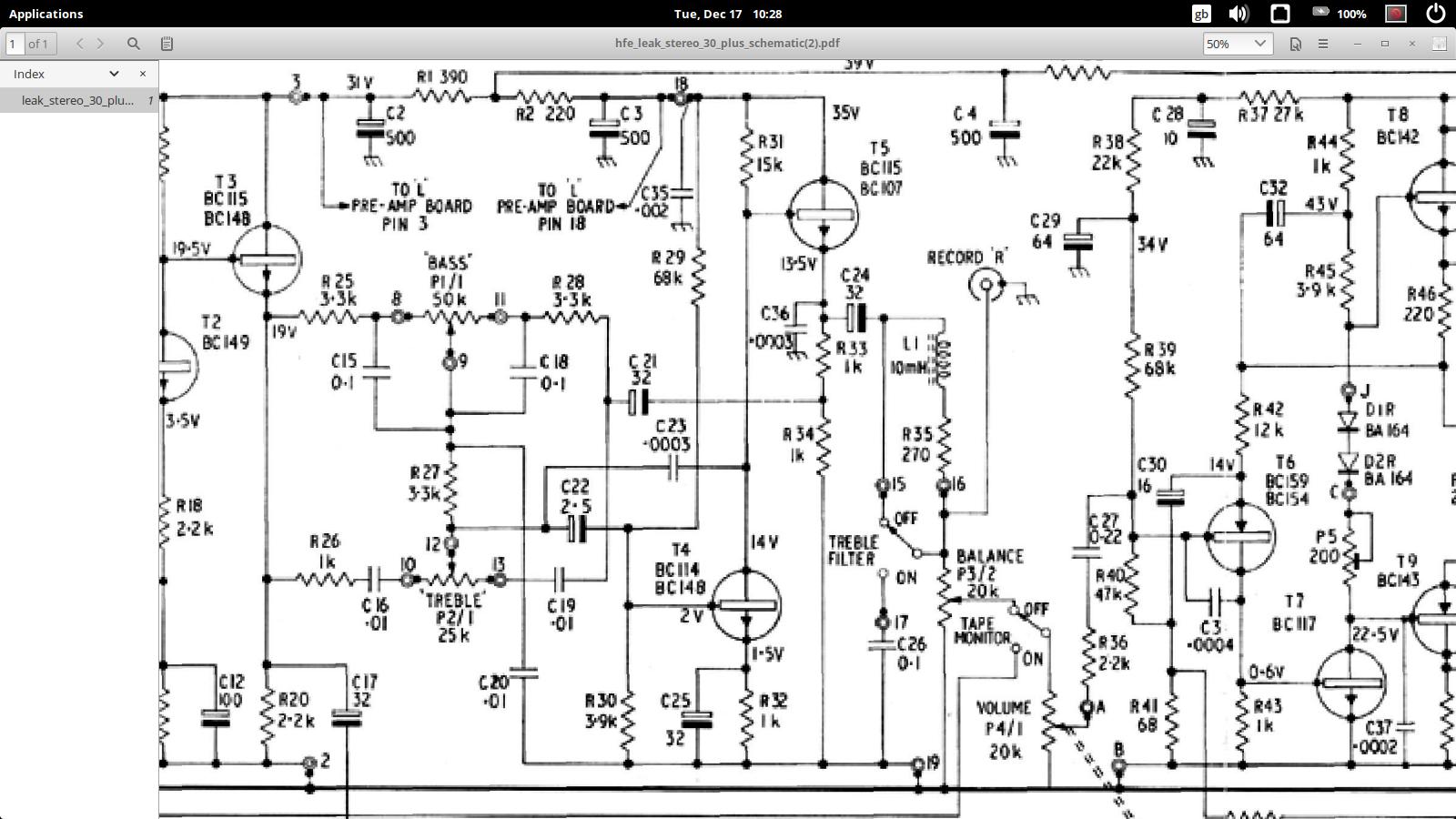

Leak stereo 30 plus L1 coil type?
One of the wires was broken, the inside one / start of the coil, I un-spun it and tried to wind it all back up, but after all that it still measured open circuit, think I got a few kinks in the copper wire, Even trying to sand and re solder the wire is difficult as it very thin. I will order the one I suggested so. They are a great little amp. I have one fully recapped running some very efficient vintage Philips speakers and sounds great. This one is the Wharfedale version, but exactly the same circuit. Thanks for your reply
ok, I checked it in circuit and out of circuit and it's reading 47ohms, looking at the data sheets for the coil I posted a link too is only 8 ohms, would I be able to just put a resistor in series to bring it upto 47ohms? As long as the inductance of the coils match?
Looking at it again, the coil I have is a single coil, not a double one, it has 4 pins soldered but the 2 small wires are only going to two of the pins, So I need a single coil with inductance of 10mH and DC resistance of 47ohms, or if possible a resistor in series. Anyone ever replace one of these on the leak amp?
