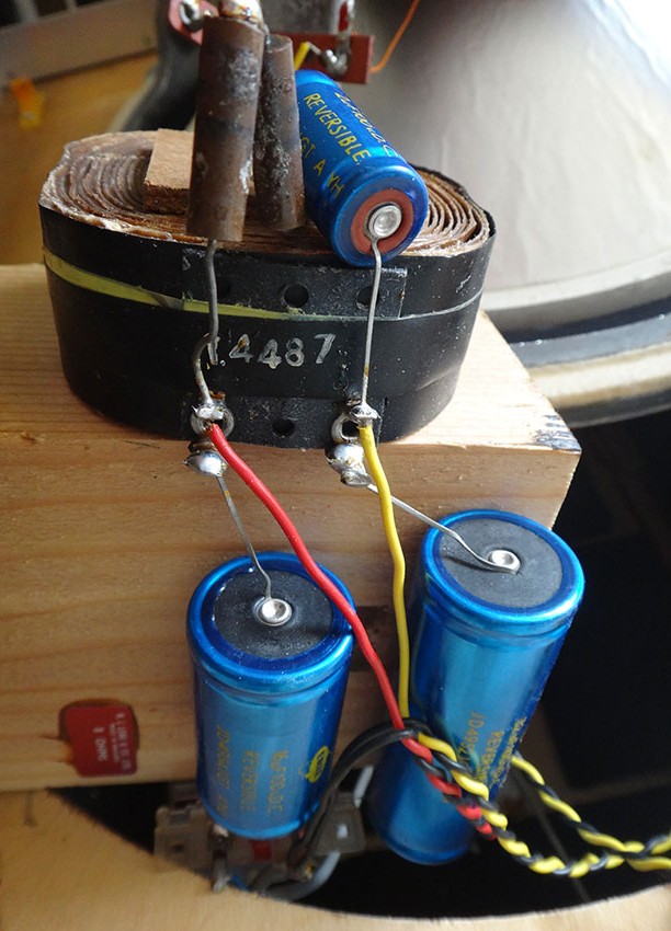

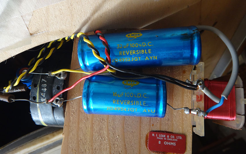

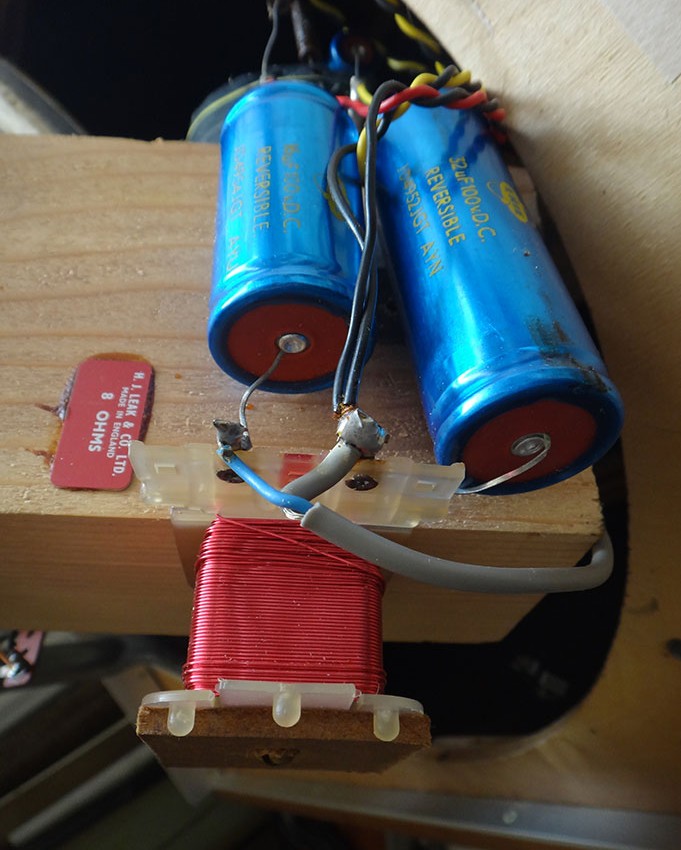

At last, I manage to make some pictures of the cross-over and I also made the drawing or at least what I understand of it (see PDF file at the end) and that's where I need your help.
One side being weaker than the other, I guess I have to change some parts of these croos-over.
For one, the two brown components in serie look to me like resistances but I am not sure, they definetly need to be changed. And then what I have called "black coil" might be a transformer and my drawing of it might be wrong.
The capacitors look good to me but....
You guys swimm with ease in all this, what shall I do ?
