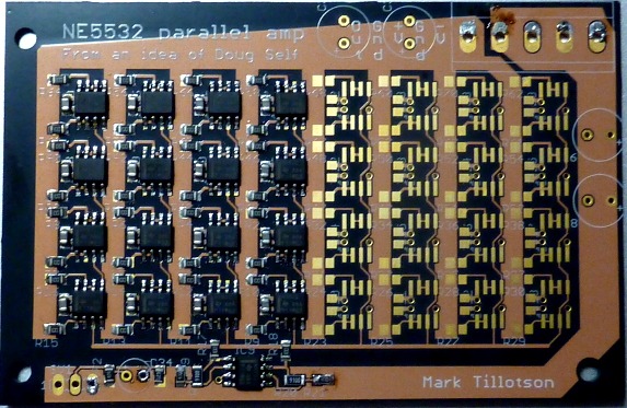

What do you all use when the design has a DIP footprint and the manufacturers and reputable suppliers only have SOIC? I know there are adapters but my eyes are 63 years old and I do not want to buy a rework station.
Unless you already have a pcb with through hole footprints, use SOIC and 1206 footprints.
They are very easy to hand solder, and no special tools are needed.
Just tack solder one lead first to hold the part steady, then solder all the others, and then redo the first lead.

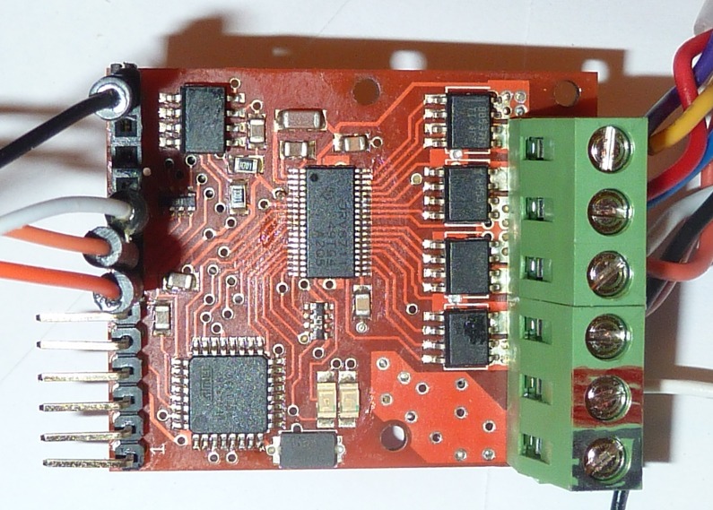

I find the main thing that offers success when soldering surface mount is tons of flux. I use a flux pen to flood the pads with flux, then position the chip, tin the iron tip and just touch it to one corner pin. the solder on the iron tip will flow onto that pin. Make sure everything is aligned, thne hit a pin on the opposite corner. Once two are soldered you can hit each one indivually. Placing a small amount of solder on the iron tip will solder 2-3 pins. I have to use a large magnifyier with a light, I'm 61yo.

I read all and with reflection I realise I got the answers I deserved. I will order a few cheapo* 8 pin SOIC and try my hand.

Sometimes you will get a solder bridge between leads, a bit of solder braid works well to remove it.
Good, the only precaution is that pads on some boards benefit by tinning before soldering.
Always use hot, clean solder tips.
I'm 61 too and my eyes are not great anymore , but I love working with SMD's . I use 2 glasses on top of each other to see well. With an extra magnifier I still manage the smaller TSSOPs and 603's , even the 402's. Tinning those small footprints is not possible , so directly on clean copper. All with soldering iron with small tip. SOIC's and 1206 , 805 are still easy to do.
Second the head mount. I was at my dentist once and he was using this really inexpensive plastic one. He of course also had a precision one that looked very expensive. I think he ordered one of the plastic ones for me and it was around 15 dollars. He said he liked the plastic one for some jobs better than the expensive ones. The other thing I'll do since I only have two hands and just do better when I use solder at the joint is to use one of those cheap third hand things and just use the alligator clip on top of the soic so it does not move. I don't clip it just put it on top of the device to hold it down. I also use a very fine solder (.38mm) and of course a small tip and flux.
