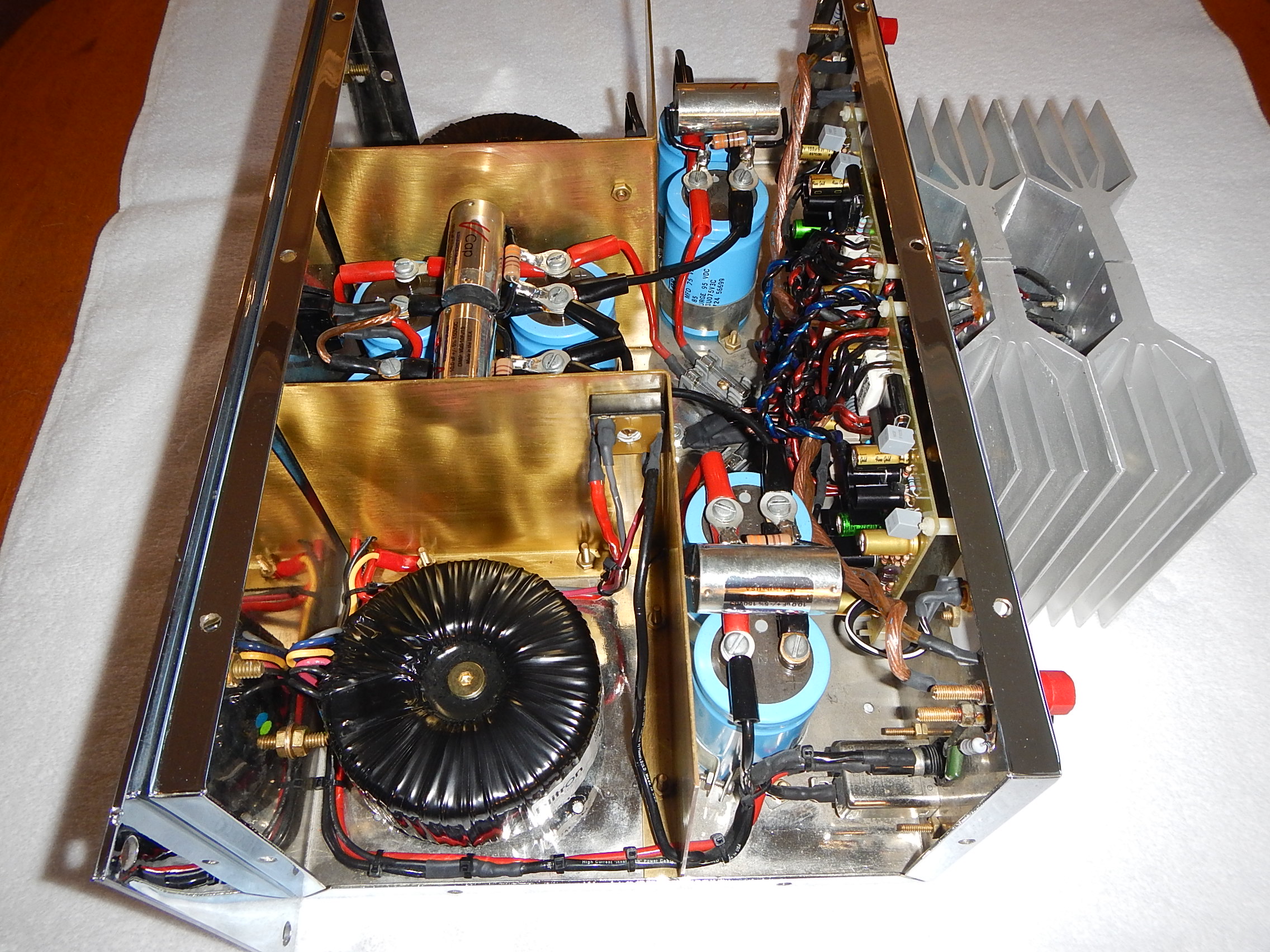

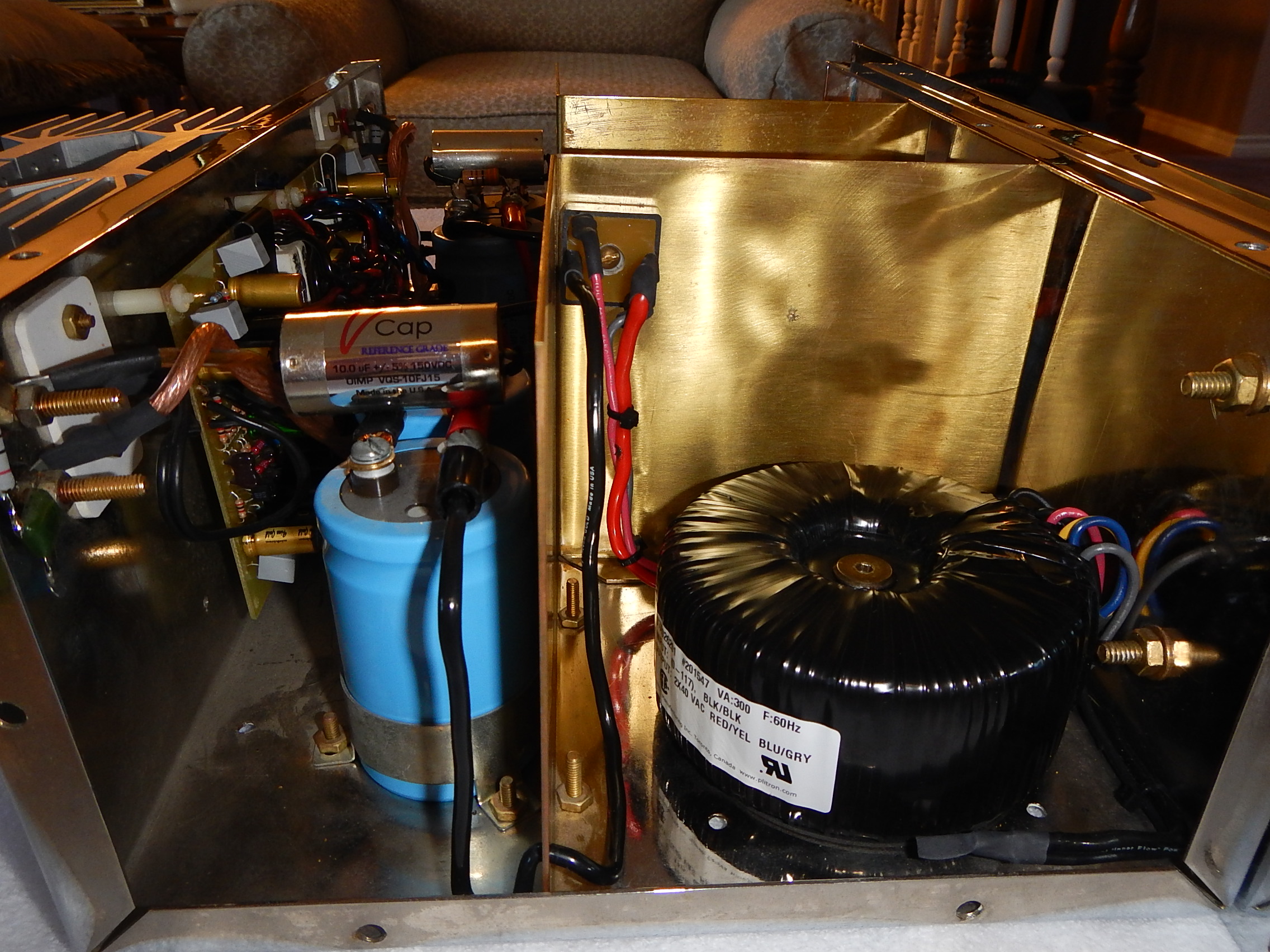

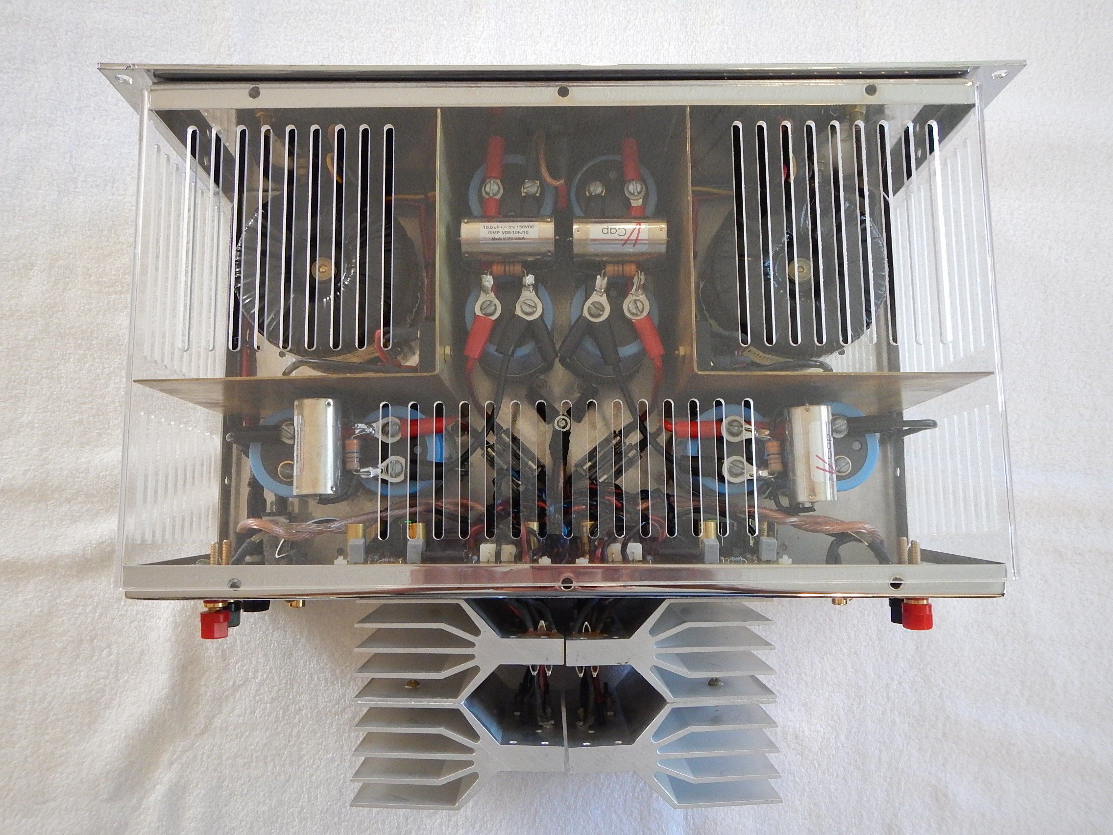

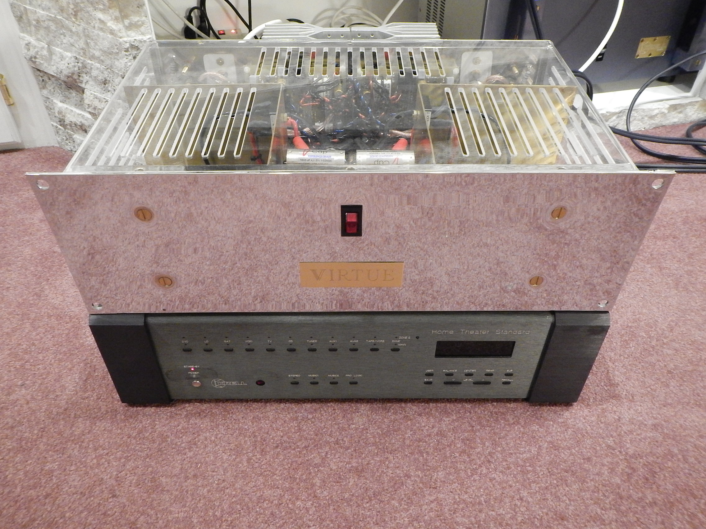

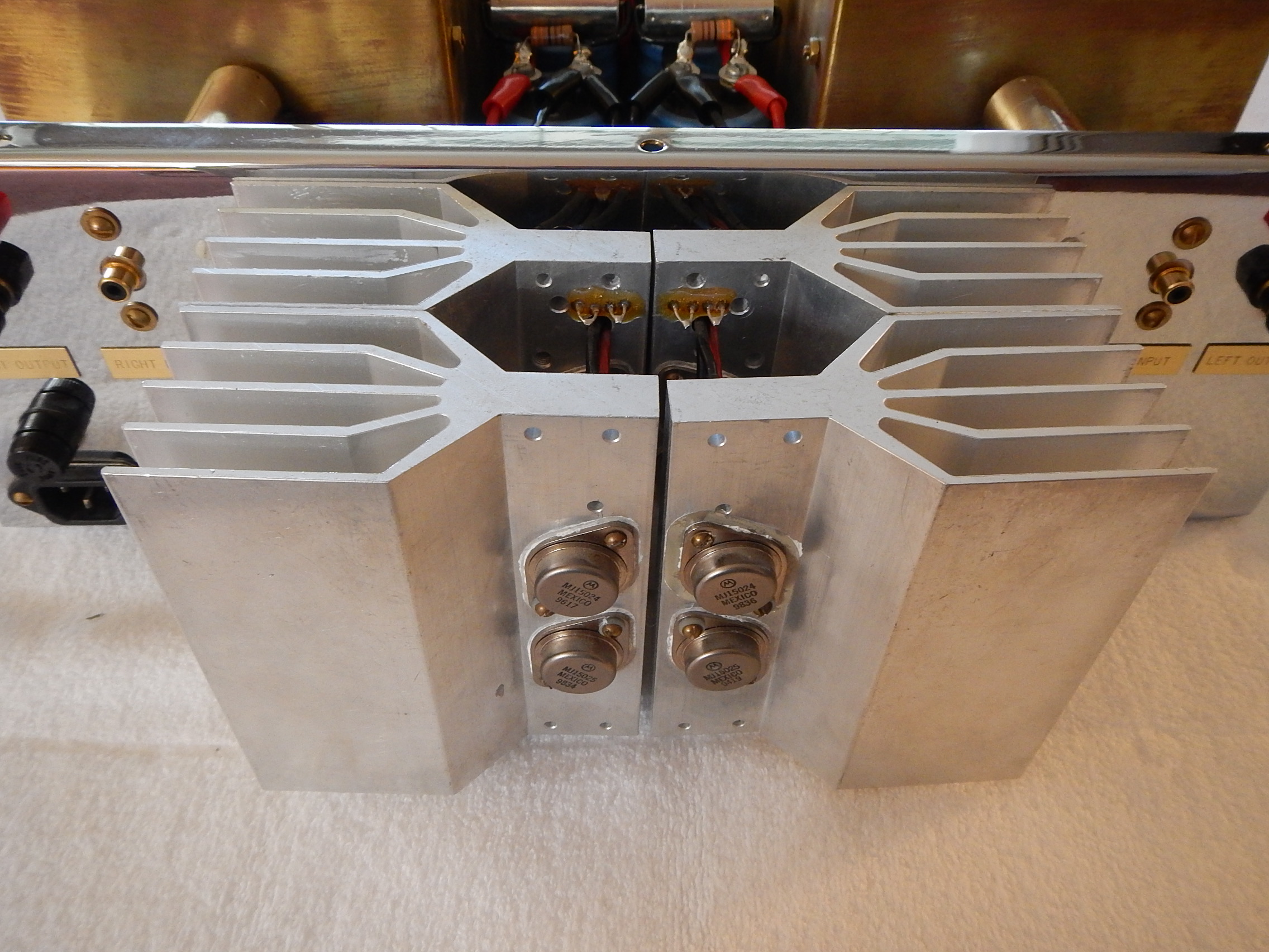

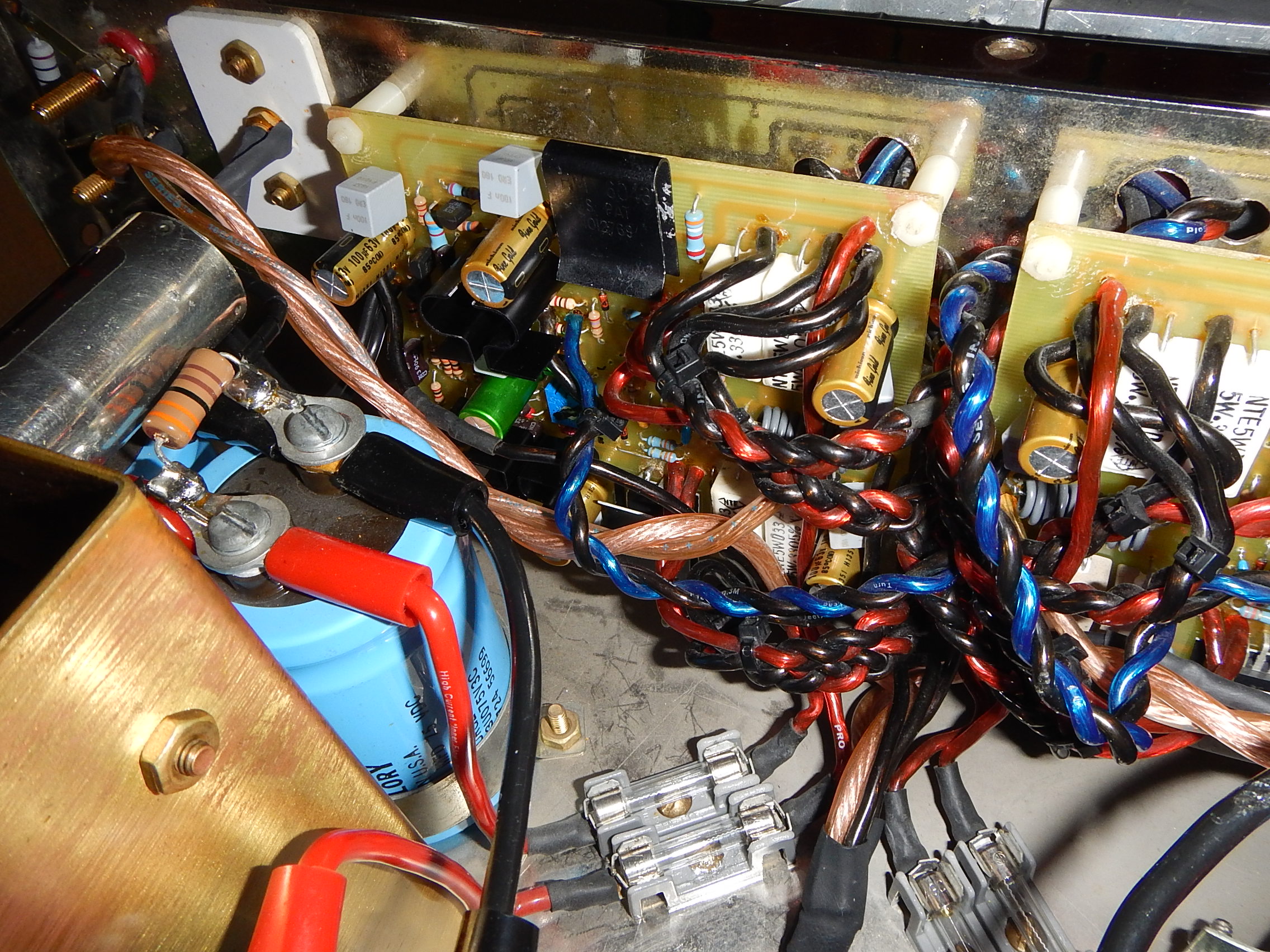

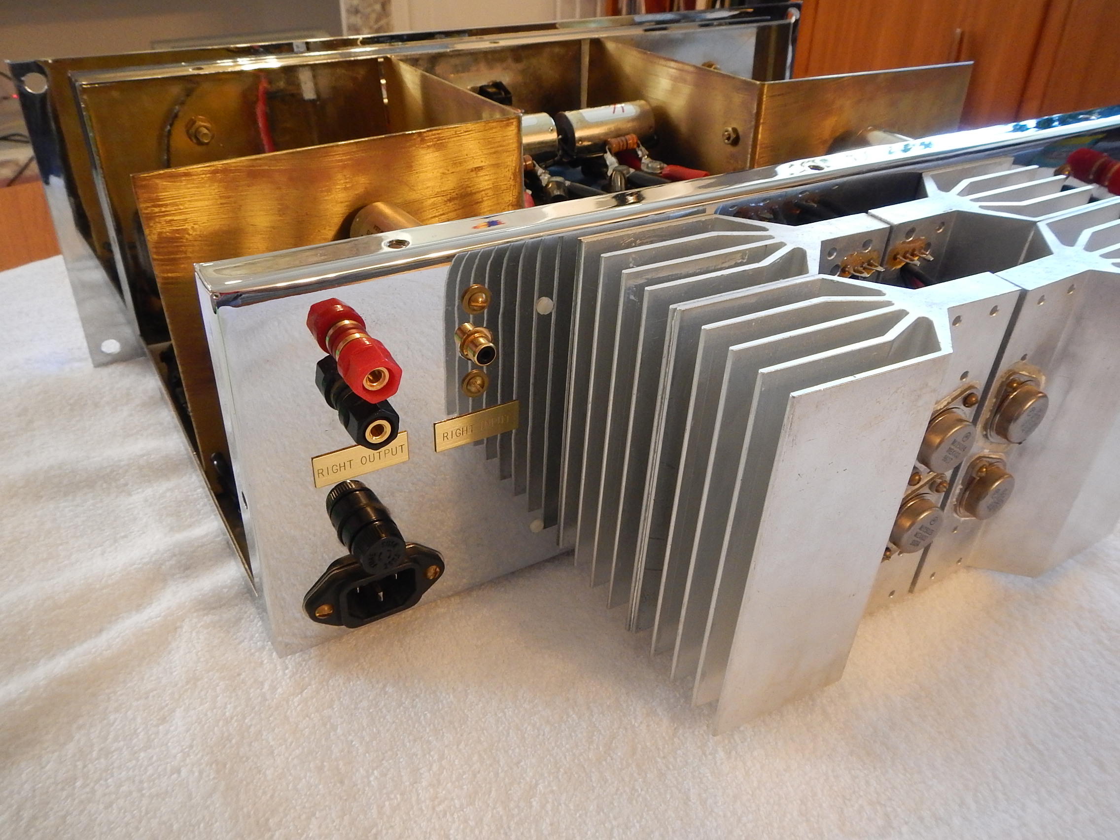

My Low Tim Leach amplifier. 100 watts x 2. Protection circuit by passed. I did not like the sound of the amp for many years and put it on the shelf.
I had huge ground loop issues and thought it was my transformers, so I bought some expensive Piltron coil transformers. It didn't fix the problem. I discovered that I linked both my audio input grounds together, then ran one wire to a central spot. Not good. All must be run separately to a central ground spot. Super silent now.
As for sound. I noticed the treble and mids were fantastic, but the lows were weak. Compared to my Krell KSA 50. So back on the shelf it went.
Over the years, I have been modifying my custom house speakers, for about 20 years now. Experimenting with countless capacitors in the passive cross overs. I discovered a combination that defines audio bliss. Then I thought, I wonder if I can put these in my Leach amp...
Well, I then discovered by replacing, C6, 220uF on the board, to a non-polar Elna Silmic II capacitor, all the lows came in and the sound was even more irresistible. This is found in the feed back circuit. Then I thought... Maybe, just maybe, I will put put some of these special by-pass film capacitors in the feed back loop on each board. The film capacitors are physically large, so, I had to make room for them. They are small values. .01 uF. Then I turned it on... Oh my gosh, audio bliss! This Leach amp will out perform my Krell KSA 50 and my Krell KSA 250 in sound quality. I have not heard a better sounding amplifier than this. And I have heard many.
Unfortunately, my photos don't show the by-pass capacitors on the board. But you can just see the green Elna Silmic capacitor.
So, whoever has made a Leach amp. This is a must to do. It will leave your ears wanting more.

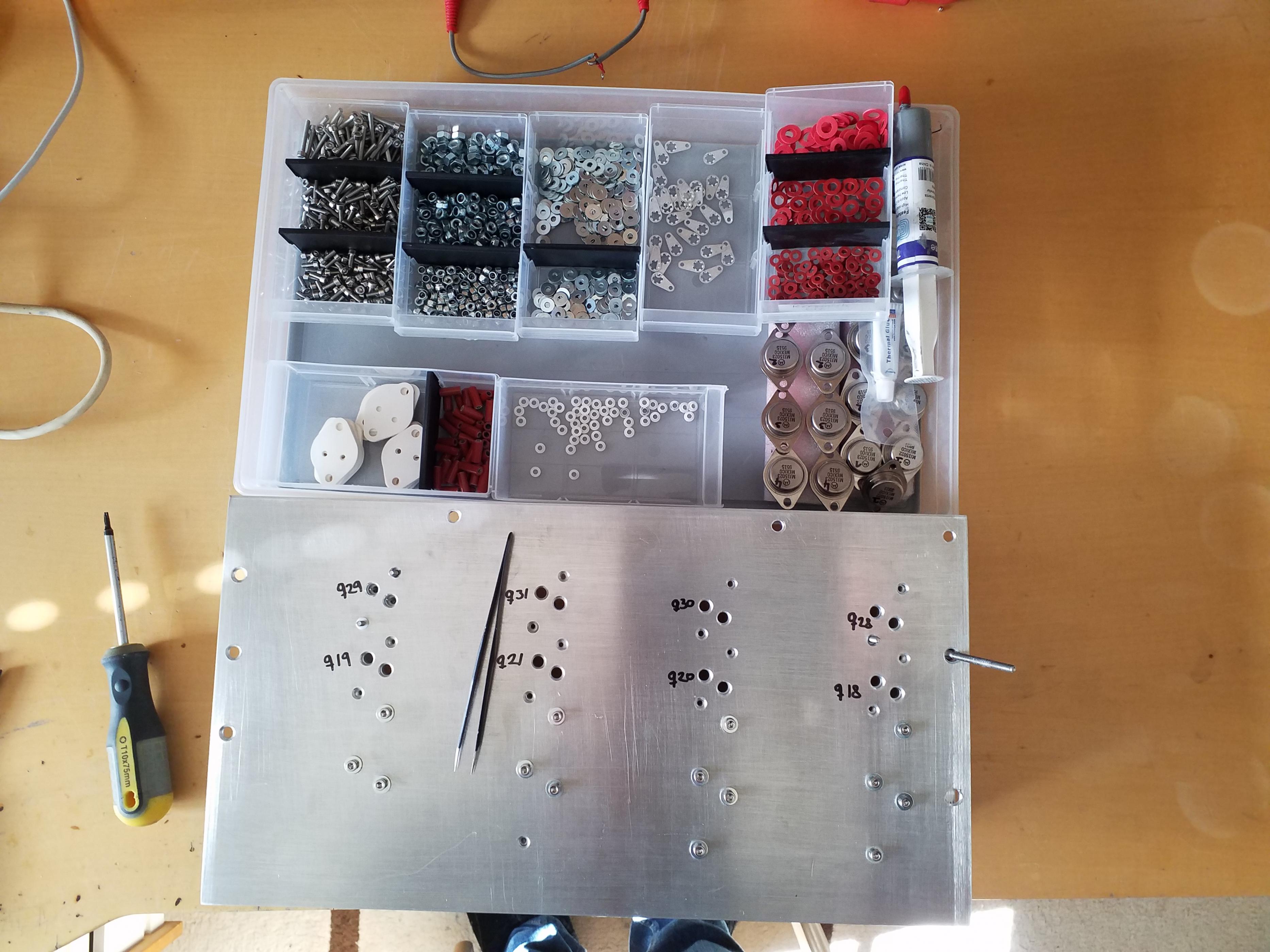

The leach superamp is what got me interested in hifi way back, so I decided to build my one one, after finishing my coffee, I will start mounting the output transistors, mine to has bipolar capacitor, the nice green ones, if all goes well I can power one channel up today.
