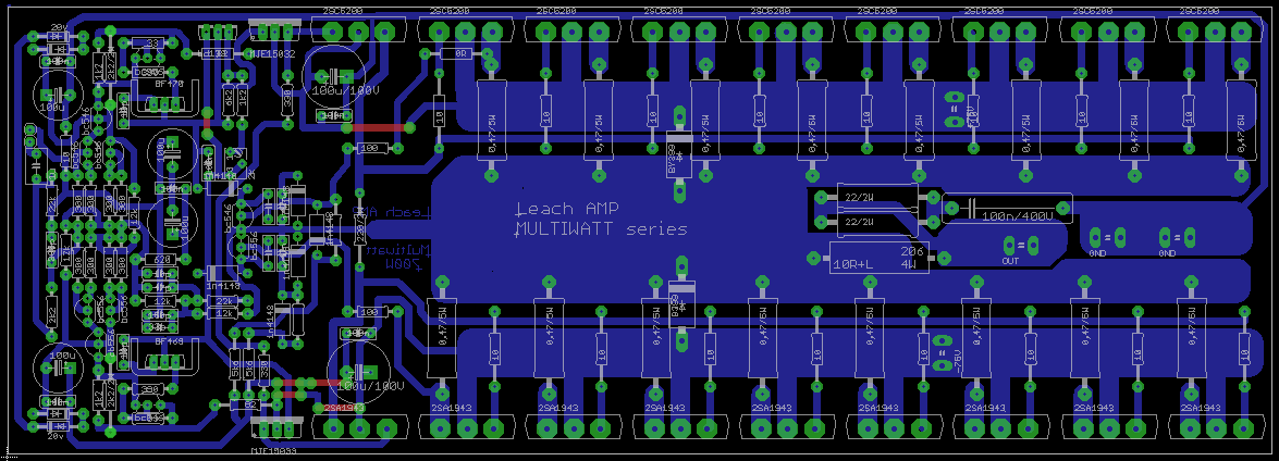

I would like to create this amp. But, i am not shure on how to go on, just copy the scheme of the superamp, then put 4 pairs of out devices in the same manner as PRof Leach did when he made the superamp from the original leach?
Dont know.. IT is cascoded, do i need to cascode again then or what?
I am a novice, yes. But i also know that some of you know how i should do to get it to work. Please share your experience with me.

The pcb that Rudi posted looks very good and also the devices used, I would follow that 🙂
You will find the author (the schematics as well?) of this amplifier here:
Zosilòovaè 700W
Best regards - Rudi_Ratlos
Zosilòovaè 700W
Hi Guys
When the Double Barrel amp was designed, there were not the range of high-quality symmetric high-voltage power transistors that we have today. At +/-90V there is no real need to cascode, although it is a traditional way to avoid secondary breakdown if the applied Vce is much lower than the full rating.
Tony suggested the MJ21193/94 pair, which is an industry standard used in the highest quality amps available today. The MJL1302A/3281A are also fine, as are all of their equivalents.
To avoid cascoding, there are two options. The first is simply to expand the output stage "sideways" with twice as many paralleled pairs. This increases the load on the driver s, so those should be changed to a higher rated type. The MJE13034/35 pair is the new kid on the block and again appears in the best amps.
If you wanted to be adventurous, driver distortion can be reduced compared to the doubled output stage by expanding "vertically" but not as a cascode. The second approach is to use the Quad Complimentary output stage as Bryston does, but not wired for gain. It is a simple matter to make QC-EF by beginning with the standard EF stage and adding collector resistors to the drivers. Then add PNP outputs driven by the collector of the NPN driver, with the output collectors tied to the output node. NPNs are added on the negative circuit half in a similar fashion. The load is now driven by emitters and collectors on both halves of the wave. Bryston's actual output circuit is more like a QC-CFP overall, allowing significant reduction of openloop THD.
In either approach, the doubled output stage not cascoded has the same number of output devices as the cascoded circuit, so dissipation is shared in a similar way. The QC keeps driver THD from rising compared to the normal EF expansion.
In all cases, emitter resistors (and same-value Rs in the collectors of the QC collector outputs) provide a means to monitor all device currents for protection.
Leach's circuit is still an industry standard for good reason. The benefits of complimentary circuitry are plentiful: the potential for distortion reduction is high; and more importantly, attaining a benign THD profile is easy.
Cascodes waste voltage headroom but can increase bandwidth, making them prone to oscillation. Leach added the base-stops to cure this ill. Paralleling many devices can also lead to oscillation problems, which are cured the same way. Layout is key to either circuit being stable.
