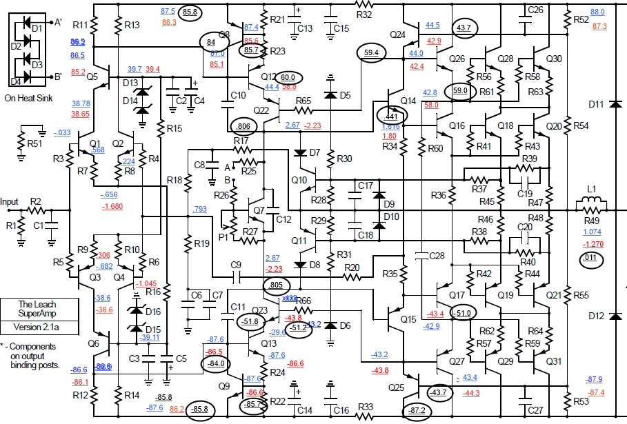

The voltages around Q8,9,12,13 look wrong to me. I'd expect to see some voltage drop across the base to emitters of around 0.5v min
Q7 has same voltage on collector as well as emitter. Either tere is a short or the transistor is defective.

Q7 is shorted with a jumper for this test per Leach instructions.
I replaced Q8 and Q9. A slight change there as a result. I changed Q12 and Q22 a few days ago with no change. As you will see I do have some new voltage readings from today which may indicate that I am getting closer. Please take a look at the new chart.
Disable or isolate VI limiter...It seems it affects the circuit operation..
I disconnected D5, D6, D7 & D8. Looks like we may be getting somewhere. I went digging through my parts drawers and could not find any replacements for D5 and D6. That is strange because I almost always buy more than I need of everything to save on shipping. So I researched the parts lists and I noticed that for the Superamp, Leach changed D5 & D6 from 1N4148 to 1N4934. I am wondering now if I have the wrong diode in there. The one I have in there look suspiciously similar to the 1n4148's that I have a bag full of. 😡
Anyway, The voltages match better now side to side and the DC offset on the output is way down. Please take a look at the circled numbers. These are from the same board that was in red before.

Hey Amptech, thanks for stopping in. I have been working on this all morning. I went digging through some more parts drawers and find a new unopened package of the proper diodes for D7 and D8. I guess I bought the right parts but must have gotten confused when installing. I understand why Leach only gave the parts that were different from the Low TIM in the Superamp docs but it made things more confusing when you were trying to fit parts. In hind sight, I should have started with the parts that were different and then did the rest from the Low TIM docs but I think I just did them in numeric number and that turned out to be a bad decision.
Anyway I installed the proper parts and it is holding voltage and looks like everything is on. With this success, I replaced the parts in the other board and hooked it up. Nope, The voltages were not right. So I changed out Q8 & Q9 but no change. Then I changed out Q13 since it was so low. Still no change so I started checking around the board for what might be causing it ans all of a sudden everything came up to voltage. Not sure what caused it but I'm going to let it burn in for a while and see if it will hold.

you can't power up the boards with missing trannies, that is simply not done..
but you can pull out Q9 AND Q8 for now, they form part of signal clipping limiting the VAS currents, the VAS is set around 5mA on the super leach.
just like the output SOA protection circuit, the amp will work even without them...

with everything connected, you should have no more than +-100mV output offset voltage, then you should be able to adjust bias voltage, these are two indicators that your amp is good, you can play music hence...anything less than these and you got problems...
problems can be wrong orientation of trannies, wrong trannies stuffed into the wrong spot, wires soldered in the wrong pads, or even poor soldering....
