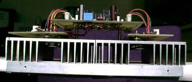

Make your own 270W Leach Superamp

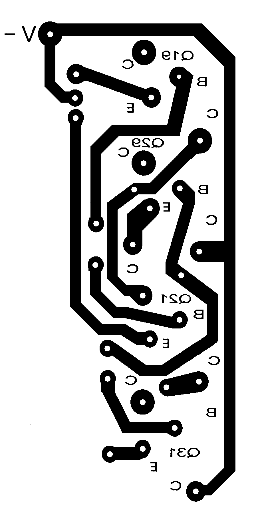

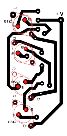

This slightly modified board lay out allows for using computer power connectors to simplify the wire connections to the heat sink mounted transistors. You may want to make an "output" board for mounting the TO3 transistors easier.
The "foil pattern" and parts placment for making your own circuit board is located on a server at my ICQ address posted here. If you have trouble getting the files, look to your own computer settings in ICQ. I cannot trouble shoot your configuration. Best time of the day to get the files is after 6PM Pacific Standard Time. This is a T1 line and the files should take about 3 minutes to download if you have a reasonably fast DSL type connection.

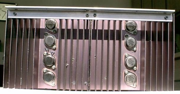

Some additional pics will be posted later showing a more complete board mounted on heatsinks and may give you ideas about how to make your own output boards.

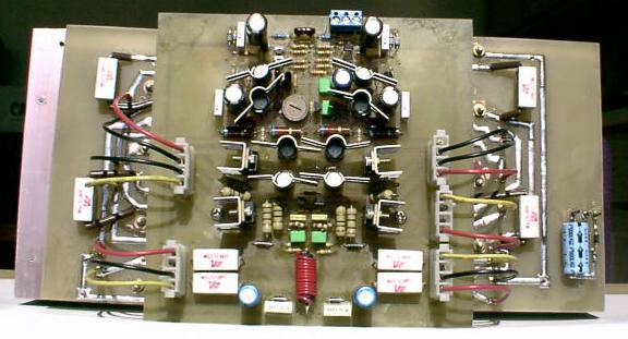

Hello acenovelty,
Arguing so eagerly in the super amp redesign thread against my new PCB layout deserves some sort of help from me to your work, that you have now presented.
First of all, we clearly don’t agree on the choice of output devises. Let’s leave it at that.
I can see some obvious problems like the lack of sufficient track width in high current nodes.
It looks like you tried to make a solution by adding solder to the tracks. This can make the tracks peel off - it might be better to add wider tracks.
The bias potentiometer could be better, I think that a multi turn type will last longer and be less prone to failure.
With all that extra board space, I would add some fuses and extra supply capacitors.
This is just my initial thoughts to help you improve your design.

Maybe it was a little harsh but maybe a bit deserved also. Jens has been attempting to improve the layout of the Leach in another thread and Mr. Acenovelty gave him nothing short of a hard time every step of the way. I also find his opening post rather condesending with a comment like:
I am sure you have seen Jens layout and it is my personal opinion that it is simply better thought out. Acenovelty's layout has what I consider some serious flaws that Jens pointed out earlier in this thread in the following areas:
The computer connectors are likely to gain contact resistance over time and cause a failure. I have seen one of these connectors melt due to heat generated by contact resistance.
The traces are not near wide enough for power and ground.
The additional solder added to beef up the traces could damage the board and lift up a trace.
Small supply filter capacity.
Two of the flaws I view as serious.

kilowattski says,
I'm kind of new to all this. Just trying to learn.
Seems the power recommended is plus and minus 85V. Maybe the current is 6 amps or more.
Is there a rule one can follow about how wide a trace should be for power and ground?
And how thick should the copper on the board be for safety or current/voltage? Since the layout is just a line drawing, I might just take a crack at fixing this if I know what to do. Maybe there's a formula or reference you could point out to me where I could google it and not bother folks too much.
Those computer connectors seem like a reasonable solution, but if they melt that's not so good. And I know there's connectors like those that are more sturdy. Could I just use soldered wires point to point instead?
And I don't understand what you mean about the Small supply filter capacity. Do the Power Supply capacitors go on this board? Always thought that was a separate thing in the box. I'm rambling on, sorry, but before I go, I was looking for the layout of Jens new board and didn't find anything. Am I missing something?
Anyway, thanks for listening and any help you can offer.
