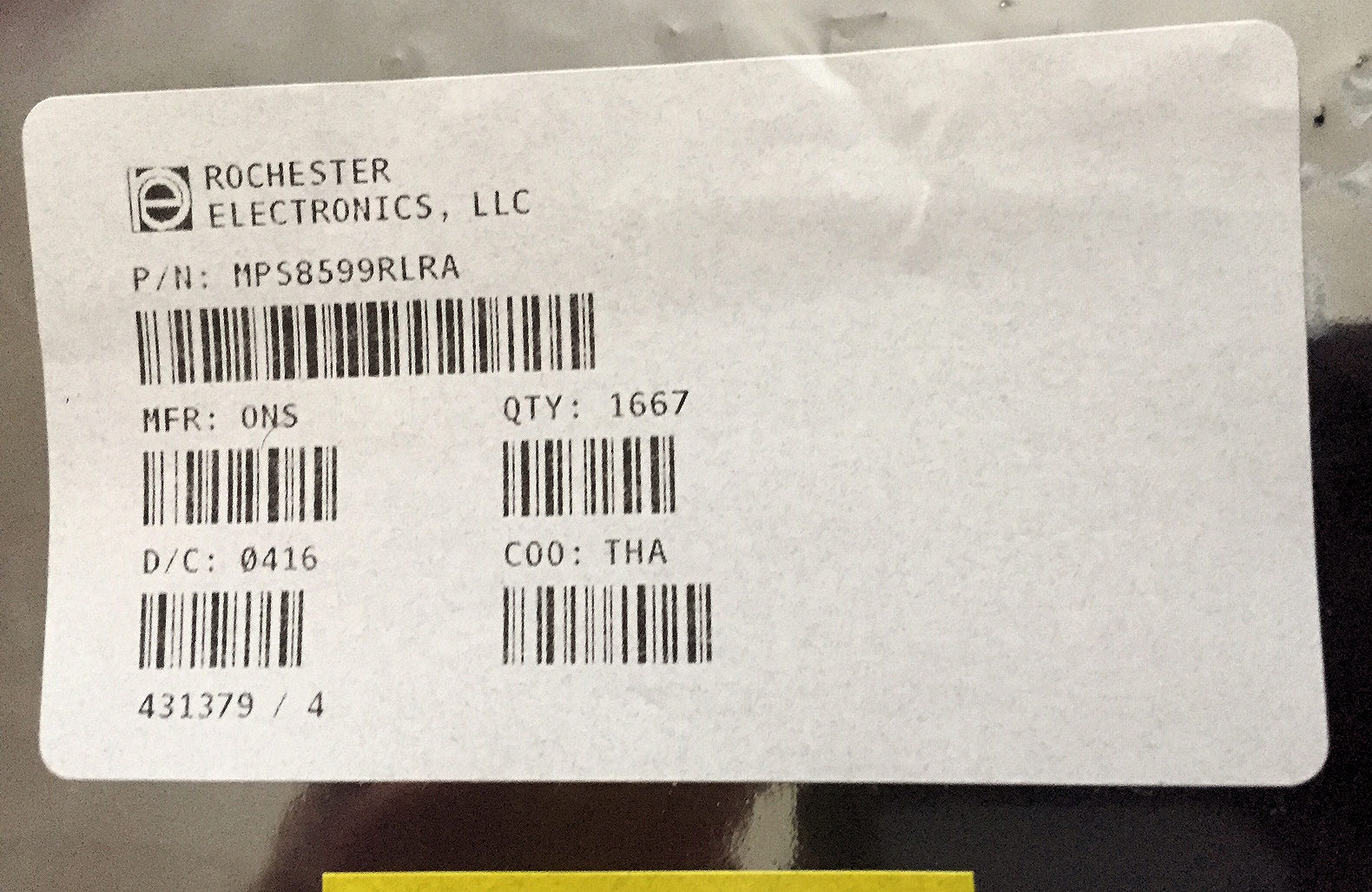

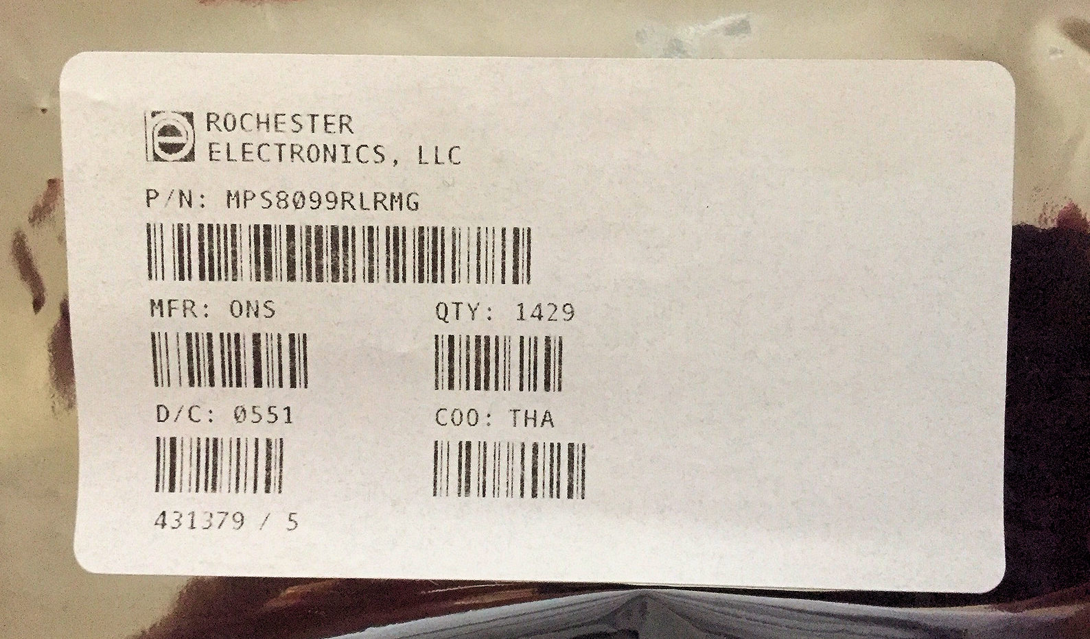

I suppose you could attempt to replicate my success from the year 2016: find a trustworthy seller of N.O.S. goods and buy some original Motorola / OnSemiconductor ("ONS") devices as New-Old-Stock.
Here's the order I placed. Pretty clearly they enforced a minimum line-item price of USD 100 or greater, except that I bought their entire supply of 2N5401 and it only came out to $42. I think they may have changed the line item min amount since then (?)
Date Ordered: Monday 14 November, 2016
Shipping Method: FedEx Ground
PRODUCT INFORMATION
Part: 2N5401 (ONS) Qty: 1417 pcs. Price Ea: $0.03 ea. Line Total: $42.51
Part: 2N5551BU (FAI) Qty: 3334 pcs. Price Ea: $0.03 ea. Line Total: $100.02
Part: MPS8599RLRA (ONS) Qty: 1667 pcs. Price Ea: $0.06 ea. Line Total: $100.02
Part: MPS8099RLRMG (ONS) Qty: 1429 pcs. Price Ea: $0.07 ea. Line Total: $100.03
Part: BC550CBU (FAI) Qty: 3334 pcs. Price Ea: $0.03 ea. Line Total: $100.02
Part: BC560CTA (FAI) Qty: 3334 pcs. Price Ea: $0.03 ea. Line Total: $100.02
I've still got quite a few of those devices and stored them in the original shipping bags; the photos below show the date codes were 2005 and 2004.
I got lucky; maybe you will, too. (??)

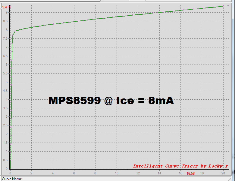

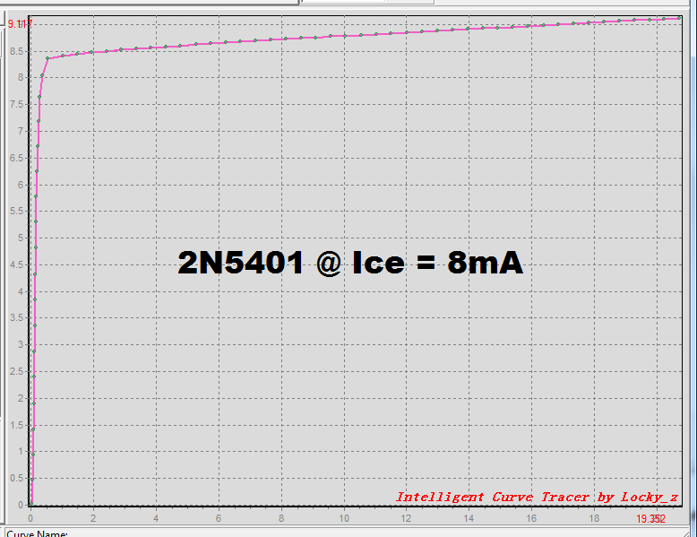

The OnSemiconductor datasheets I have, don't include all four of the h-parameters. In particular, the parameter h_oe =(delta_vce / delta_ice) is omitted, regrettably.
So I measured h_oe on a bunch of transistors, hoping to find which was the best and which was the worst. Here's the raw data for the MPS8599 and for the 2N5401, which often appear in the same positions within audio amplifier circuits. As you can see, the 5401 has got much better (lower) h_oe , therefore much higher Early voltage, which some designers greatly prefer.
{ Horizontal axis is |Vce| in volts, vertical axis is |Ice| in milliamperes. The curve tracer software insists upon displaying all plots in quadrant I. }
Best of the best measured h_oe values was the ZTX757, but be careful: it is device-optimized for a different region of the (Ccb, fT) space than these two.

5401 may be a better transistor, and C1845 better still. But how much resistance is actually sitting in the collector circuit on the diff pairs of the Leach amp? Not much, IIRC. And there are emitter resistors which further increase effective h_oe. It was designed for an era when “high performance” transistors weren’t the norm.
Matters a lot more in the VAS, where the ZTX devices are pretty nice.
