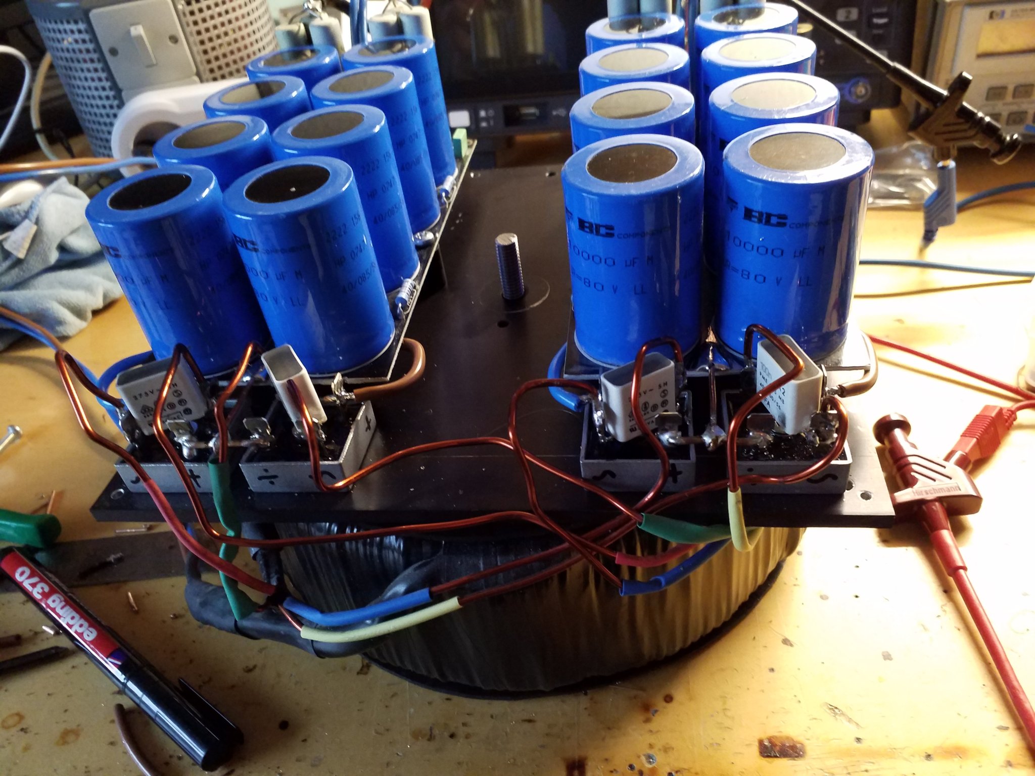

Edgr..thanks for pinching in.. no there's no connection between top and bottom.
I measured the resistance of each pair of secondarys, using Kelvin probes and my old hp,
I think theire pretty close, 712-716 miliohm 712-740 miliohm.
Same ac on primary give theese numbers on secondarys.
3.6815 - 3.6800 volt from center .. rail to rail 7.356 volt.
3.6436 - 3.6450 volt from center.. rail to rail 7.2850 volt. All unloaded.

Hi again, I did the dual bridge as can be seen on photo, but something is not as it should be, it consumes 30 watt ideling, and buzzes, but lower. transformer with nothing connected iddles at 10w roughly.
It really bugs me, I did not care for phase as it shouldn't matter, I did put some 100nf across secondarys, did not do anything, this arrangement is powered through my vario, could it interact somehow??
I watched the capacitor banks voltages, they are close within one volt, discharge time seems also close, so assume no bad capacitors?

Did you make a back-of-the-envelope-calculation on how much power all those big resistors visible in the background eat up?
20W is a lot, which should produce some heat, which could be located using your nose, fingers, or a thermal imaging camera, for instance.

This whole psu is getting on my nerves, I spend way to many hours and money, yes 20 watts is definitely to much, but can we agree that the phase doesn't matter?
What is the logic step next? Try with rectifiers only? If it's okay put in shunt resistors between rectifier and capacitor?
Certainly. Start low and watch the ammeter.
One more thought: how does the power draw share between the two banks, i.e. just connect one at a time, and maybe swap the transformer windings to check every possible combination.

I'm not sure about that, that's why I suggested putting in shunt resistors.

How do you measure the power consumption? An unloaded ps has a horrible power factor. Not all power measuring devices handle that well...
Put a dim bulb limiter on it both ways - trafo by itself and with caps. It will draw a little more with the caps - just a dull orange glow. The poor power factor will cause additional losses in the transformer and caps do have a few mA leakage. With the power factor THAT poor you can’t tell unless you’re measuring real power consumption. The bulb may be only zero decimal place accuracy but does respond only to real power draw. Maybe you‘ve got a cap in there that’s bad or needs reforming. Or maybe everything is as it should be.
And how much capacitance do you HAVE? The proper amount is 20,000uF per rail. That will make an amplifier put out full power down to 20 Hz with a 4 ohm load. R, C and F scale in the usual way, if your goals are different. Any less and power supply ripple will cause you to lose maximum capability at low frequency. Any MORE just results in additional heating in the transformer, and buys nothing if you are not using it. Of course if you WANT full power at 10 Hz, you would want to double it. If 40 Hz or 8 ohms only, you get away with half.
If youre sitting there with 200,000 uF hanging on the supply I wouldn’t be surprised at all to see excessive idle consumption. It ain’t needed and causes additional power loss.
