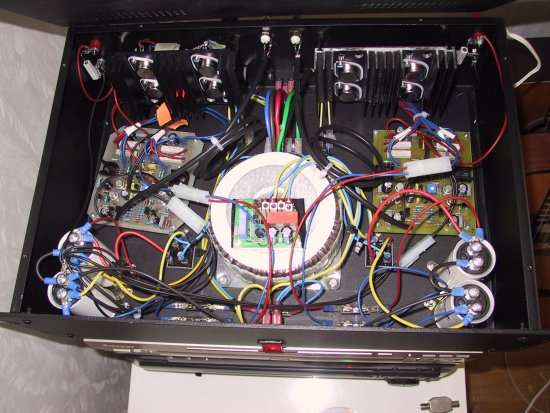

On the attached picture, you can see my trafo. It is a 2x38 volt Toroid transformer. The green and the blue cable is connected to the rectifiers. The red and brown cable is connected to ground(eg, the rats nest on the leftmost capacitor bank). All references to ground are connected there, including the ground pin on the powercord.

shadow: What you need to get is a 2x38 volt (or 2x42 volt) transformer. That way, you'll at least have a chance on getting it right.
On my transformer I connected my wires like this: (note that the colors on your transformer might be different)
This should do.

Shadow:
You probably mean this (which is not recommended for the Leach Amp):
In which case, I reallly recommend you to rewire your amp to look like mine. In your case, the V- has the same potential as ground (=0 volts).
Try and measure between the metal casing on Q15 and Ground on both your boards. On one of your boards your multimeter should read 0 volts if I understand your schematic right. On the other, it should be 0 volts between Q14 and ground. THIS IS NOT CORRECT!
I'm still amazed that your components has not yet started burning. ;=)
Try and connect like this instead:
AND!!!! Make sure that if you measure voltage across the outputs on the transformer you get the HIGHEST reading between Green and Blue! AND 1/2 the voltage between Green and Red, which should be equal to the reading between Red and Blue.

No i have measured 30V between Q14,Q15 and ground on BOTH boards.And 0.2V between Q12,Q13 and ground on BOTH boards.
OK i'm waiting now for transformer so you can take a rest 😀
Then i try to solved this mess.
