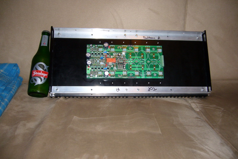

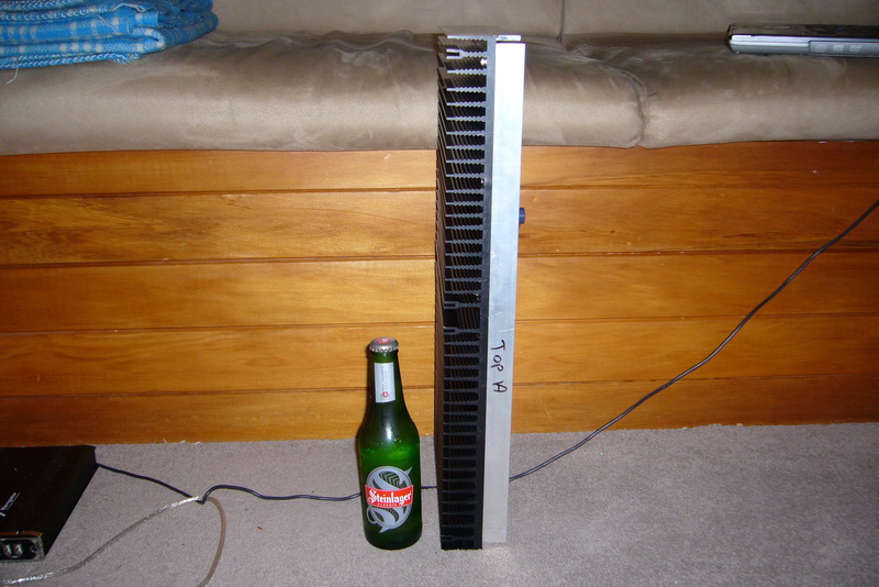

you wanted to know how much heatsink real estate I got, check this out.
Its my current UGS project. Most the metal work is done, Ive got a few more semis to place before I do the preliminary start up, check voltages etc before installing the chips, jfets and outputs.
The beer is Steinlager, an oldie but a goodie🙂
I bought four of these a few years ago for a good price and Ive not yet used them. As I dont have any monster class A's on my to do list for now, I thought I would use the other set for my Leach. Thats one reason i considered a Class A Leach.
