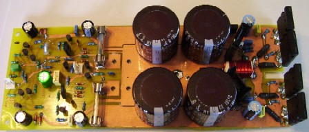

Hi all,
I have just got one channel of my Leach amplifier up and running. It seems to be fine, DC offset is 12mV, bias is stable, music is clean and free from obvious problems (o critical listening yet), no hum at all, and only a very faint hiss when my ear is right against the loudspeaker. All in all I'm very pleased... 😎
But when I turn it off, because of the filter caps, it takes a long time to discharge them. All is fine until the Rail voltage drops below 40V, when a moderate hum/hash noise is generated. It takes about another minute of this before the voltage drops enough to silence the amp. I'm quite annoyed by this, and I can find no mention of this problem.
Can anyone suggest a cause for this, and possible solutions.
All I can think of is a relay and a power resistor to discharge the filter caps quickly on turnoff to reduce the time the noise is produced, but I'd much perfer to find the source of the problem.
Adrian

Hi mate,
I guess all sorts of thing can happen if the big electrolytics are discharging at different rates - are they all OK? It's quite common to see a resistor across the last reservoir capacitor on each rail to ensure the caps drain themselves at shutdown. 10K 1W should do it, I've never seen a relay involved.
Nick
Use bleeder resistors, 2.2K 2W, on each voltage to ground. Will discharge the caps in a shorter time.
As to why your two amps are different, I suspect a poorly matched input pair in the noisy one. It should go down quietly if things are balanced.

OK. Update
On further investigation...
If the souce signal is off, then the noise is produced only about half of the time, otherwise is silent.
The noise only occurs if both the source interconnect AND the mains cable is plugged in.
Most interestingly, like 5th Element, the noise continues even after the voltage rails have dropped to 0 volts. ie I don't know where the power is coming from. It must be coming down the interconnect from the DAC (DIY DAC, the output buffer is an AD797, which can in theory deliver 50mA), or perhaps I have found a source of free power. 😕
I think more investigations are needed...
On listening, I don't think I've got any problems with oscillations when the amp is fully powered up. I don't have a scope, but the music is clean clear and detailed, no harshness, grain etc. which would be indicitave of problems.
Adrian
