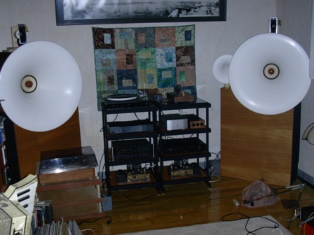

Hi guys,
Mssr. Serenechaos, yes I love them. Every day I hear more to like. The dynamics are astonishing. I will definitely see you at RMAF, and I hope yo ucan here /critique this setup after the show. I would love to hear your Tannoys!
GM, yowie, that is a big baffle. So those drivers need to be -low- Qts? Not high Qts? It definitely makes the bass horn options look compact by comparison 🙂
It's all about PRaT: pace, rhythm and timing. A horn adds acoustic loading, lowering the driver's effective Qts, or if a pure WG, it at least maintains whatever it is and since whatever it's mating to needs to match to preserve PRaT, the OB driver must have the same or correspondingly lower Qts.
GM

Robert,
You're holding out on me....
I wish I had seen this prior to LSAF, I would have followed you around like a little puppy wearing you out for the details.....
Are you still "over the moon" with this set-up? I've been secretly working on a front horn design for a couple of months. I have considered tooling up a L'Cleach front horn for my Fostex's too, and putting it on top of a " University Classic " Bass horn ( Mid bass anyway ). with a tapped sub set-up.
This may tip the balance....
Jealous John
Mightym!
I'm psyched you like the system. It sounds good but with some caveats.
The LeCleach fronthorn is unimpeachable. But everything else could use improvement. For example, the bass bins obviously require corner placement, so I'm in the process of switching them out for LaScala bins, so I can pull them closer together.
Also, I'm switching out the active EQ for first-order passive. But even then, the bass bins (and to an extent, the AER's) still require a healthy dose of digital EQ to get a flat, extended response (using a computer as the source). Still, it's worth the trouble and good to have EQ as an option.
So thumbs up on the front horn, but I'm also trying to design a BLH to get back to simplicity. It's hard to find that balance of simplicity and performance. Also, it's hard to -really- get a flat response without a measurement kit (obviously).

Hi Mightym!
I switched out the FE206E for the AER's. Very different sound. However, while the AER is brighter and crisper, I probably should have just tried rolling off the 206 and then using a horn tweeter. It probably would have been overall better in the upper octaves. But the AER with the stiffer cone has a certain crispness which is nice. Worth the extra money? I got them used so maybe 🙂
The only big defect in my system is that it's not all that horn-loaded, really. I'm depending on the Azura's clever trick of horn-loading just so much as to flatten the 8" (pretty much) so the upper octaves are just firing out of the horn (getting some attenuation). As Mssr. Serenechaos says, a horn is just "mechanical EQ".
The ported LaScala has been really popular and so I thought I'd give it a spin. In the old days, all I cared about was tone, but now, I really want dynamite imaging (in a very imperfect room). So I'm compromising in order to get the imaging, and while it will still go down into the 30's, obviously it's far, far less horn-loading than the K-horn type of bin. But at least it's still huge, ha ha.
Dang, your plans sound phenomenal and rather epic! And (unlike my random horsing around, your plans sound well-informed!) With the 200Hz size, perhaps you could do the full rollback? I wonder if Serenechaos will chime in (he's building a 5-way). He got a measurement system from Parts Express.
I am -super- psyched to hear about your Dallas progress as well!
