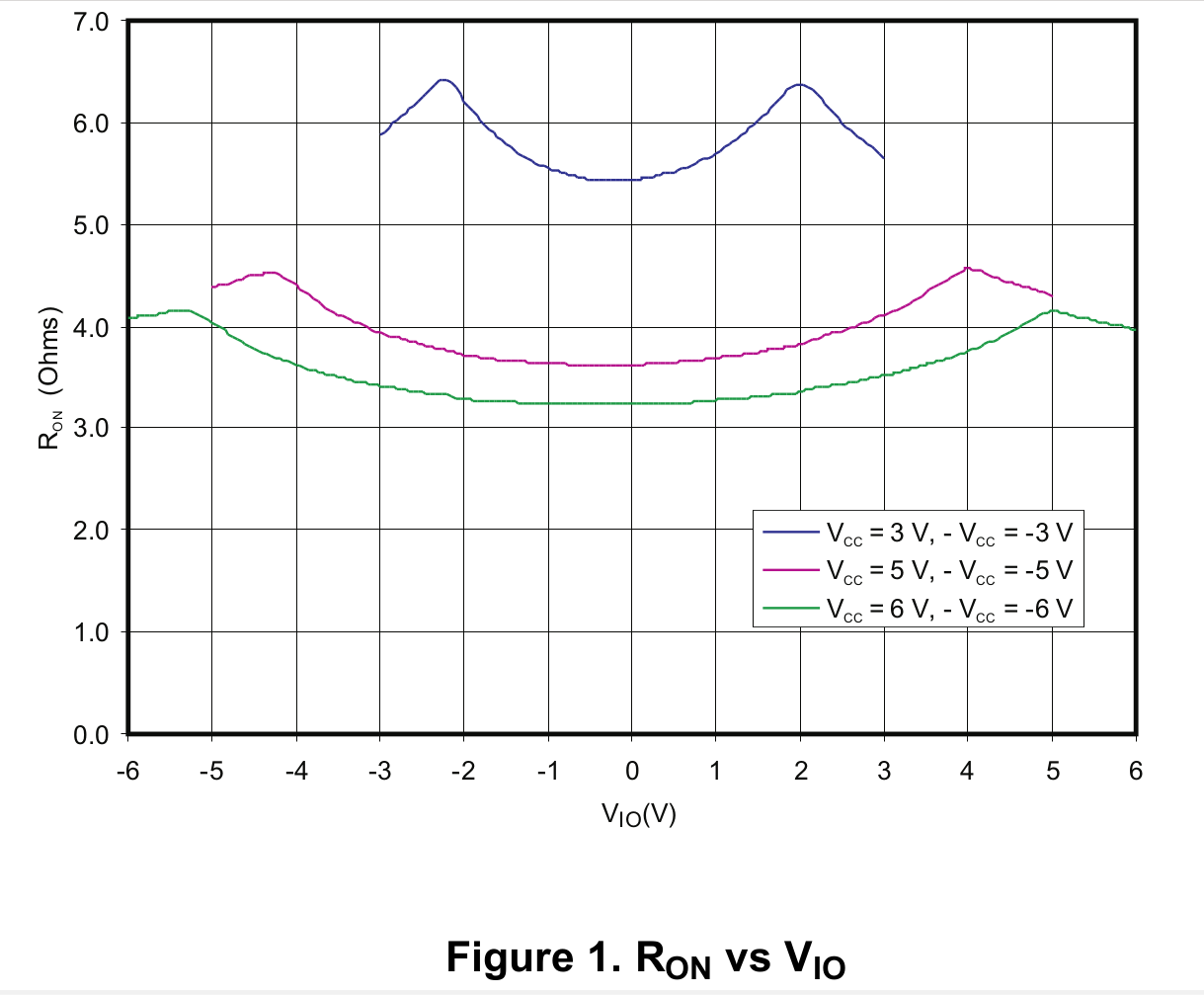

Distortion
Low noise is good. Have you measured distortion of the complete discrete attenuator?
This modules uses 28 discrete thin-film resistors that are switched using very low-noise analog switches.
We have yet to get around to measuring that. And I should explain why that is.
The topic of audio distortion gets a lot of attention around some audio technology enthusiasts and is often treated as a de facto metric for audio quality, especially on technically oriented audio forums. So much so that it gets taken for granted that anything with lower distortion is "better" than some other thing with higher distortion. And as an engineer I get the logical seduction of that notion.
And yet when I've listened to music on various systems over the years I've noticed practically no correlation between distortion specs/measurements and whether I liked what I was hearing or not.
When I investigated the topic of distortion relative to human hearing I discovered a fairly consistent body of research that indicates human beings are unable to perceive distortion below a certain threshold. One can argue the finer points of what that threshold is but it appears to be somewhere around 1% THD although some claim it's much higher.
This raises an interesting question. If you can't perceive distortion below a certain threshold, then what is the relevancy of measured distortion below this threshold? No doubt measured distortion is useful in guiding the design process and it does satisfy the engineer looking to judge how well one system performs under the hood relative to some other system.
But I never confuse measured distortion with whether something sounds good to me.
LDRs exhibit rather high distortion characteristics. They are often criticized by audio engineers as being inferior devices because of that and other reasons. Yet, when deployed thoughtfully in a volume control application I consistently prefer listening to music through an LDR attenuator compared to all other alternatives.
When we first listened to our new discrete resistor attenuator I was very curious what we'd hear. It did sound OK. But when we switched back and forth between the LDR and discrete attenuator is soon became obvious which one we preferred to use.
I have zero doubt that the discrete thin film attenuator has far lower distortion measurements than the LDR attenuator.
What would really be a distortion is to claim that the low distortion discrete attenuator is a better attenuator than the higher distortion LDR attenuator.
And that is why we haven't gotten around to measuring the distortion on the thin film discrete attenuator....yet.
I don't have any doubts about film resistors.
I have doubts about switches, both mechanical and electronic.
If you feel that THD measurements are lame, how about Gedlee metric by Earl Geddes and Lidya Lee? I suppose it would be good for comparing different attenuators.
The analog switch we use is a Texas Instruments part with a stated THD spec of 0.004% which even if off by an order magnitude is so low as to be irrelevant. It requires a bipolar +/- 5-6 V supply which is a pain but I'm very happy with the results.
I don't view THD measurement as being lame. It's a useful tool design. But I do believe it's all too often waved around without context or perspective because it's simply not directly synonymous with sound quality.
As I understand it the Gedlee metric grew out the recognition of THD's shortcomings as a meaningful metric of perceived sound quality. And while it's considered a better approach it's not exactly a simple matter to do it properly as in you can't just plug in an analyzer and set it to Gedlee mode and get an answer.
In a perfect world we would measure everything clinically, sort the results best to worst and then buy the best you can afford. For audio, for wine, for cars, whatever. Instead we get to listen, taste and drive. Imperfect yet mostly enjoyable human experiences. 🙂
