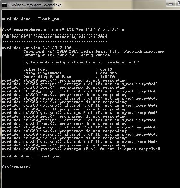

Tried to flash the arduino, since I thought there might be something wrong. Followed your proposal but was not successful. Program found Arduino but couldn't connect to it. The system tried to connect for 10 times, then stopped. Strange. So I think I killed it with anything. Any idea?

Neb, in the windows command line I started as in your document descibed. Had to install libusb0.dll. Then there was a connection established and I was on the right path, but then I got the info, the flashing couldn't be done. The procedure was tried 10x by the software automatically, but always stopped due to a reason, I forgot. This is a bit of a vague description - unfortunately I don't remember more exactly. I it helps, I could try it again. I somehow think, there is something wrong with the nano.

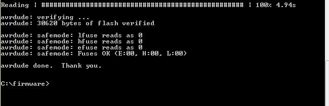

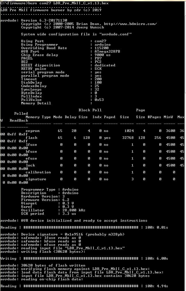

Ok, seems arduino Nano is ok agaun, but I might have destroyed somthing else with the PSU issues,I have had. I have wild clickering relays and wild blinking Display. Tried moreoften, but always the same. Maybe I shot the ICs?
Did you insert nano properly without missing any pins?
Neb, yes Nano is properly connected. The clicking relays are the three ones close to the LDR'S.
Ernst
Firmware burn was a success? Can you post the output here to make sure?
