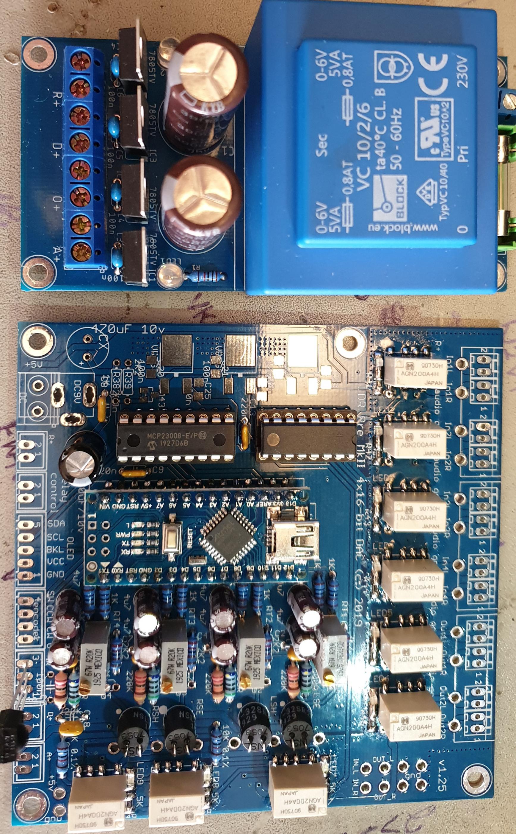

Thanks Ned
Another Q: The BOM Says: C5, 14, 15, 16, 17: 0.1u. I can't find C5 on the silkscreen. On the other hand on the silkscreen there is a C18 100n (=0.1u) which is not in the BOM.
I assume the BOM should say: "C14, 15, 16, 17, 18: 0.1u"?
hi, C5 is located between R33 and 3 pin connector for IR I assume it is there so you dont need to solder cap to IR_rec pins like in old version of LDR. I populated both. And just found out I also put a cap directly to IR-rec pins Maybe I should just remove one But it is working nonetheless. Just completed my build everything working great just need to find a case to put it in... Then I can post some of my pictures.
Looks good
A small note: there are four voltage regulators on power supply board and only three voltage inputs on main board. Fourth (O+) is to be used only in case you have issues with OLED injecting noise into D+ line, as dedicated OLED power line. I did not have these issues myself, but with OLEDs coming from China nowadays everything is possible I guess.
Looks good
Thanks Neb I will keep that in mind if necessary.

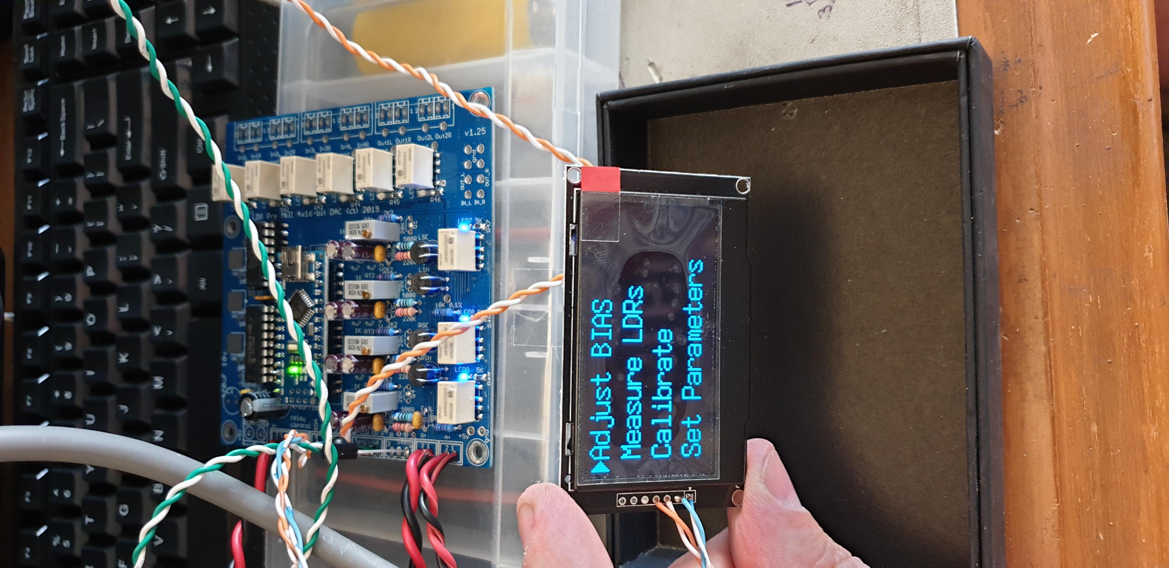

I just got it setup and calibrated, what a great device this is.
Thanks for all your efforts.
Now to get a remote....
-Dan

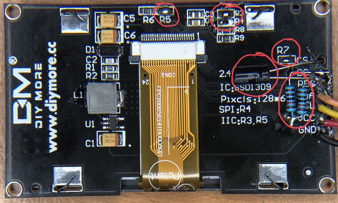

Hi Neb,
Could I confirm the "bkl" connection on the pcb
And the wiring for the Oled please
-Dan
Please use the photo in the ldr user manual on my site.
All fixed and the IR remote works ! thanks Neb
