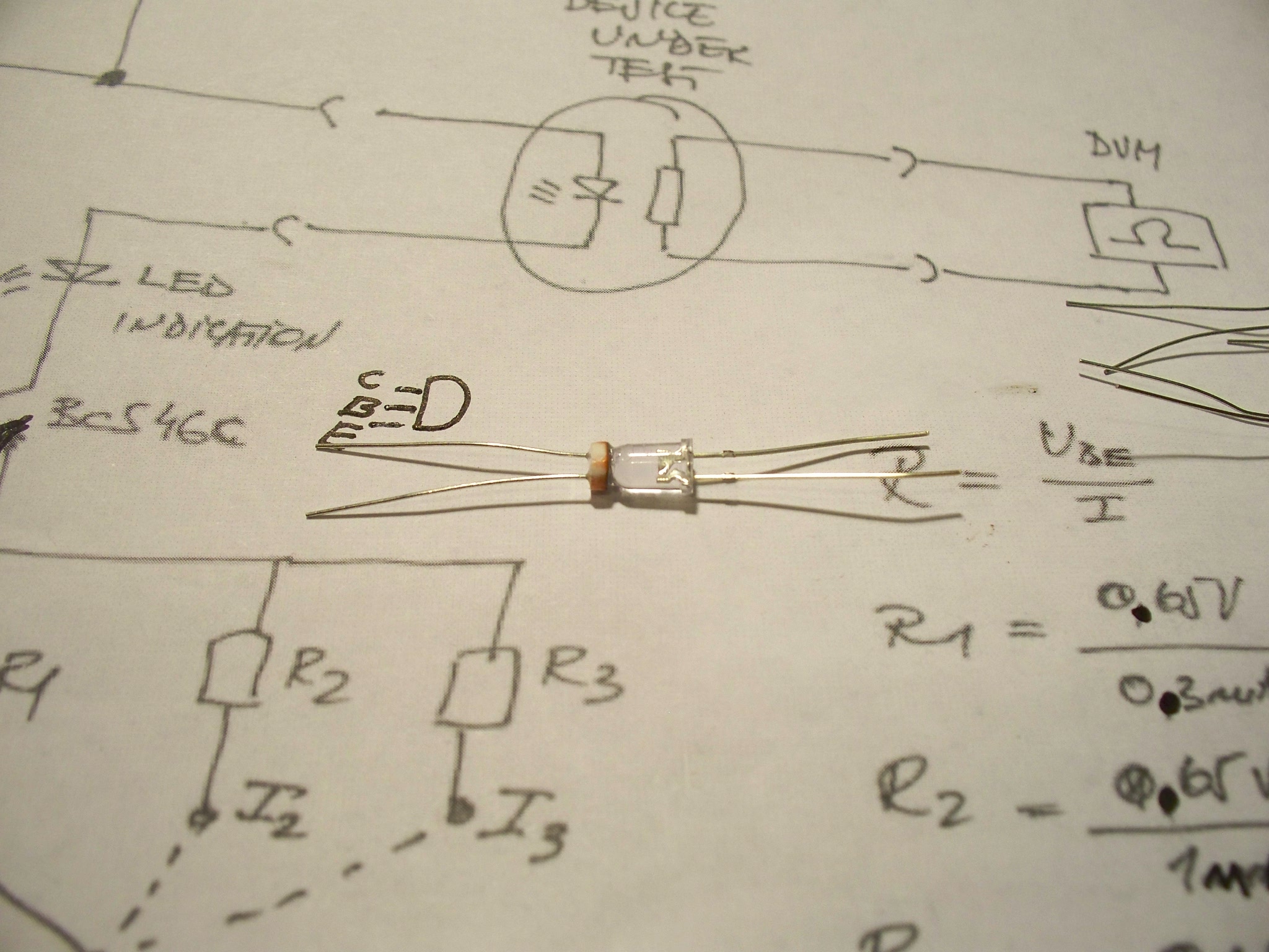

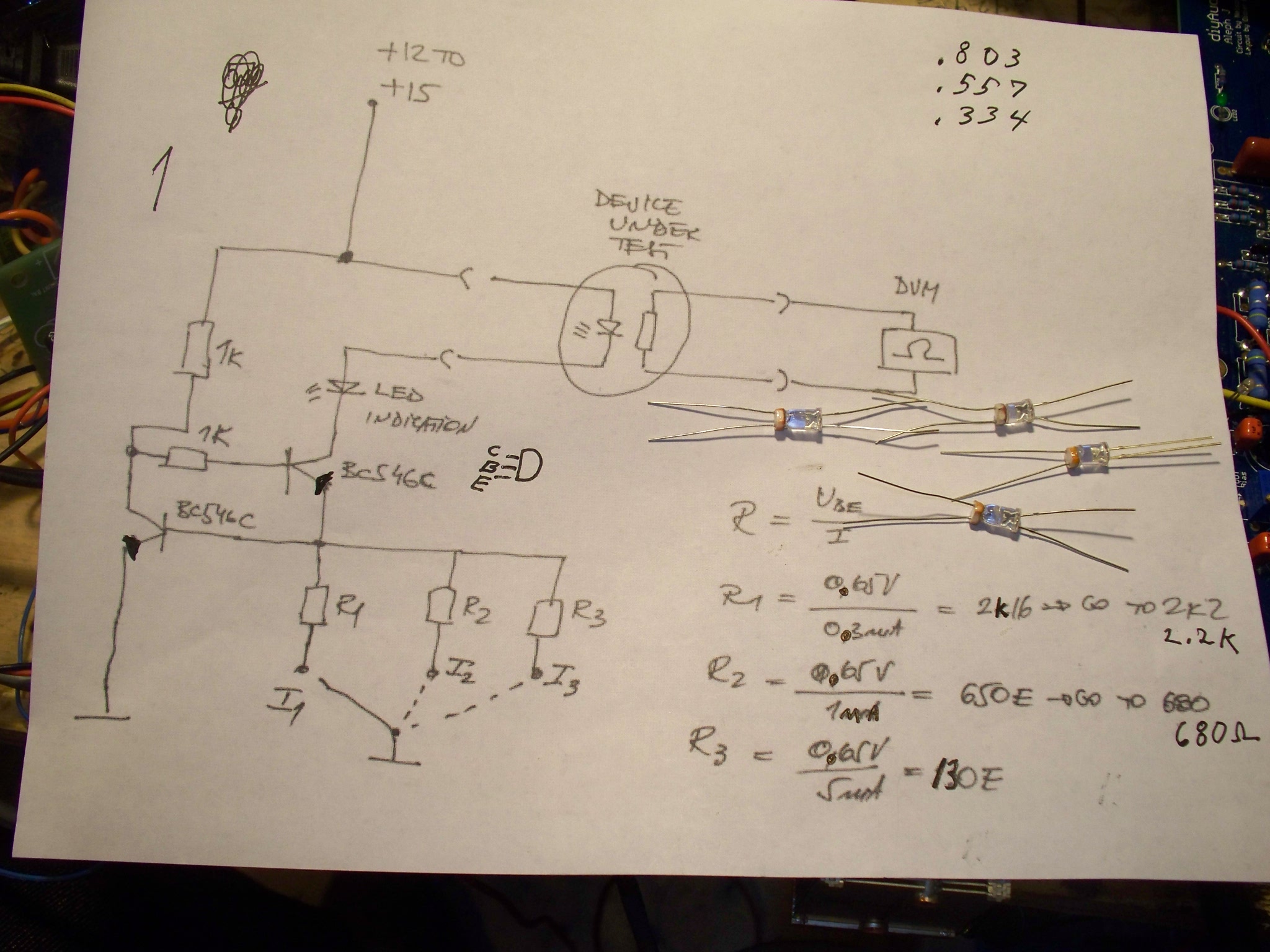

I decided to take a shot at making a ldr,so far so good ,I made some with just a drop of SG and the led to the photocell,it works better to flatten the tip of the led ,the whole assembly fits better,I checked the 2 I had made up and they were exactly the same, I made the circuit to test and only changed the ldr when testing,I made 4 more I will test and try them out tomorrow,BTW I cover the LDR when testing,when I finish them I will cover them with Black heat shrink and blk tape if the shrink bleeds light.
I found these parts on ebay 50 photocell $7.00 and 100 White LED's /resistors were $4.00. I did find some after I bought these that have a flat top,lol,my luck!
so if they hit 20 cents it's a keeper,

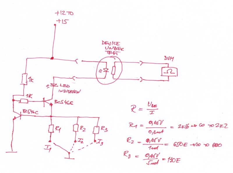

I like the test circuit I think Nelson put that up for us,THANKS ! I used push on monetary switches ,as all the rotary I had on hand where 1 to 6 ers,lol.
