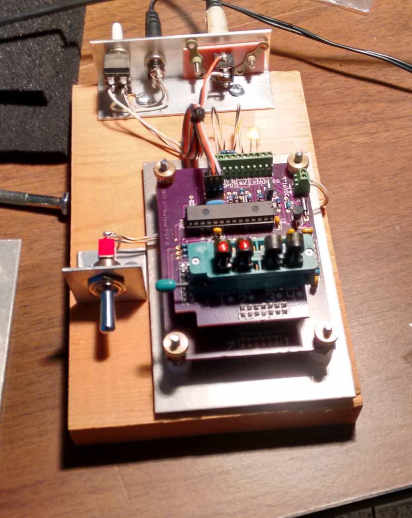

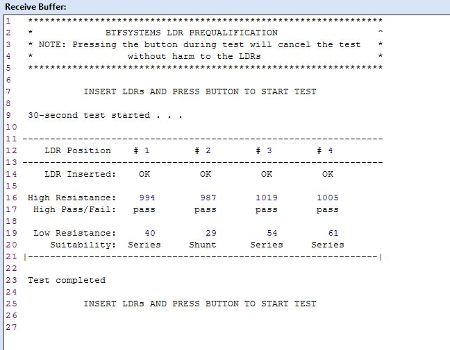

Absolutely, all my shunt LDRs achieve 40 ohms with less than 10 milliamps of current. Many achieve 40 ohms with much less current -- one in the image will go to a very low resistance at 10 milliamps which means in practise it takes far less than 10 milliamps to achieve 40 ohms.
Take a look at my automated LDR prequalification station and display. I can define the important parameters for four LDRs at a time and the test takes about 30 seconds.
The test is pass/fail for high resistance capability, and specifies the resistance achieved at 10 milliamps of drive and specifies the recommended application for each specific LDR. It's a piece of cake to separate shunt-capable LDRs from series-capable LDRs, and to entirely weed out the occasional dud which does not meet basic requirements.
The reason one of the red-dot LDRs is qualified as a series instead of a shunt in the image is that I recently changed the qualification criterion for shunt from 40 ohms at 10 milliamps to 39 ohms, and the LDR was identified under the old system but no longer passes the shunt test under the new criterion.
Interestingly, the reason for the change was that I was getting too many LDRs qualifying for shunt duty!

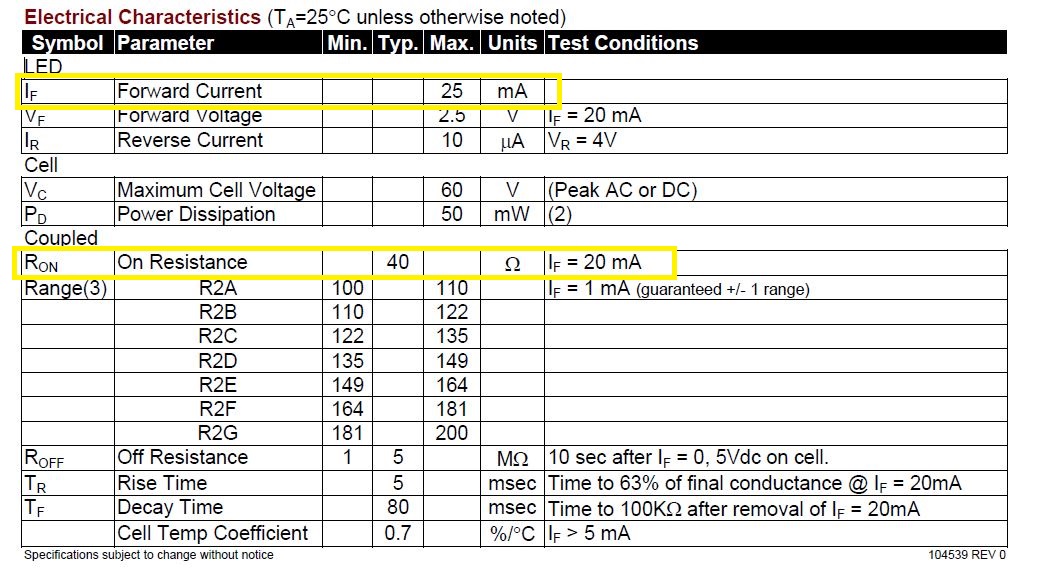

I won't argue with what you've presented.
But from my experience I've found that 20mA of led current is needed (without pushing to the 25mA safe max rating), to get the brightness need to make the shunt ldr get down to 40ohms for low level listening or background music in a medium to high efficiency system. And the specs of the NSL32SR2S confirms this also.
Cheers George
But from my experience I've found that 20mA of led current is needed (without pushing to the 25mA safe max rating), to get the brightness need to make the shunt ldr get down to 40ohms for low level listening or background music. And the specs of the NSL32SR2S confirms this also.
Cheers George
You do recognize that those figures are guaranteed minimum specifications? And you did hear me say that I separate shunt-capable and series-capable LDRs? So I cherry-pick for shunt LDRs. I can do that because I've developed a system that makes it very easy to do, and more than half of my tested units meet that criteria, and the other half do not.
So, if you don't do any sorting, then you do have to plan on driving LDRs to 20 milliamps to get 40 ohms. But if you do sort as I do, then you can make that happen with just 10 milliamps and all of a sudden you have LDRs in your system that just loaf along at less than half power and therefore stay in calibration almost indefinitely.
I can see that sorting would be very difficult or impossible for a Lightspeed type circuit because matching the resistance curve takes precedence over current at 40 ohms. In the case of my circuit however, practically any LDR can be made to precisely match practically any other LDR, so now sorting primarily by resistance at 10 milliamps becomes feasible.
This is one of the great advantages of how I make LDRs work in my systems. My design is to the point where you can just about treat LDRs as you would any other component -- it's not going to fail early, it's not going to go out of calibration, it's mostly a commodity now rather than an esoteric component that requires frequent fiddling. And size can be kept very small -- about 2.5 inches by 3 inches -- so it'll fit in many difficult locations.
Yes your system does take the matching of the LDR's out of the equation, as I have to do at 5 different mA points for all 4 NSL32RS2S's.
But I will still say there is no way with only 10mA of led current it can get low enough in volume. Which will make it too loud for low level listening especially in med to high efficiency systems.
I get 35-40ohm with 20mA which is just low enough for low level listening in med to high efficiency systems. If I were to take them to the max safe of 25mA I could get 20 -35ohms, but I don't push them that hard even though the data sheet says it's safe .
