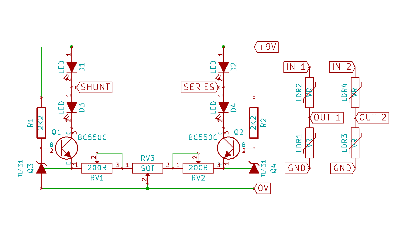

Please try mine, it's reasonably accurate, and inexpensive, run it at 12V not 9V as indicated, let me know what you think. Supply filtering isn't shown, add 100nF polyester // 1,000uF low ESR, then 33R in series to the PSU.
The control of the volume isn't log, but we know about that.

Hi "itsme",
Your circuit reminds me of Peter's 'current drive' circuit back in 2008 shown in the #1000 post in Geoege's "Lightspeed Attenuator ...." thread
Nelson did a design too that included a simple buffer with jfets (a la B1 buffer)
Jeez, that's over 10 years ago
I recently used a SuperTeddy reg as the power source for Uriah Daley's "Clone Note" (see on "Build an Amp site) and it made a noticeable change in the performance, surprising enough - it uses a fixed value series resistance (ldr) and 23 position stepped shunt resistors that George originally found to be unsatisfactory - the series ldr resistor can be adjusted (via a pot) to alter the vol control's impedance - very simple, very clever, very transparent
Yeah, couldn't agree more - I think it was AndrewT's previous comments about leds preferring 'current drive' that started this variation - Paul Hynes did some good design in this area too.

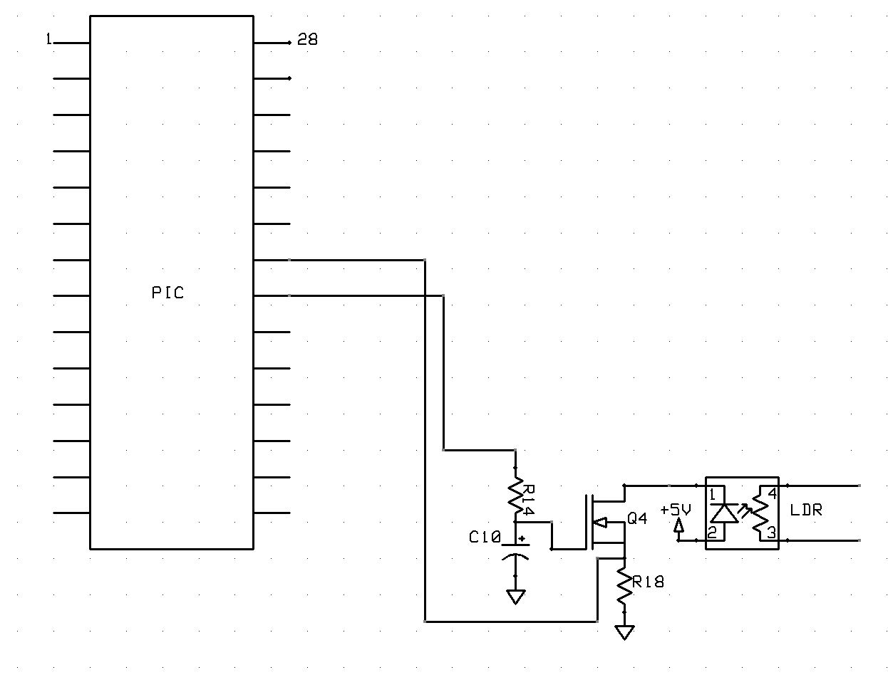

It seems to me that there is no issue here -- current control is mandatory for precision control. LDR resistance changes as LED brightness changes. LED brightness is driven by current, not voltage, and unless the current is monitored and constantly adjusted to remain steady, temperature variation at the LED will cause the LED to draw less or more current at a given voltage thus causing the variance in brightness which causes the LDR output resistance to vary.
My solution is to put a microprocessor to work to hold LDR current rock-steady regardless of temperature or voltage variation, see the attached diagram. The processor running at 32MHz measures and corrects current to the LDR at a rate of thousands of times a second when the chip is not doing some other function like changing volume level, balance, etc, when the correction drops to hundreds of times a second which is still plenty.
BTW, I calibrated my LDR volume control years ago when I first put it in service and I haven't recalibrated since and it's still running perfectly because I do not allow more than 10ma through the LED at any time.
BTW, I use proprietary techniques to give my system 12-bit or a little better, resolution. Current control is that good.
James! Great to hear my prototype is still working well for you. It's been a while and obviously the software has changed quite a bit, especially the RE control board . . .
