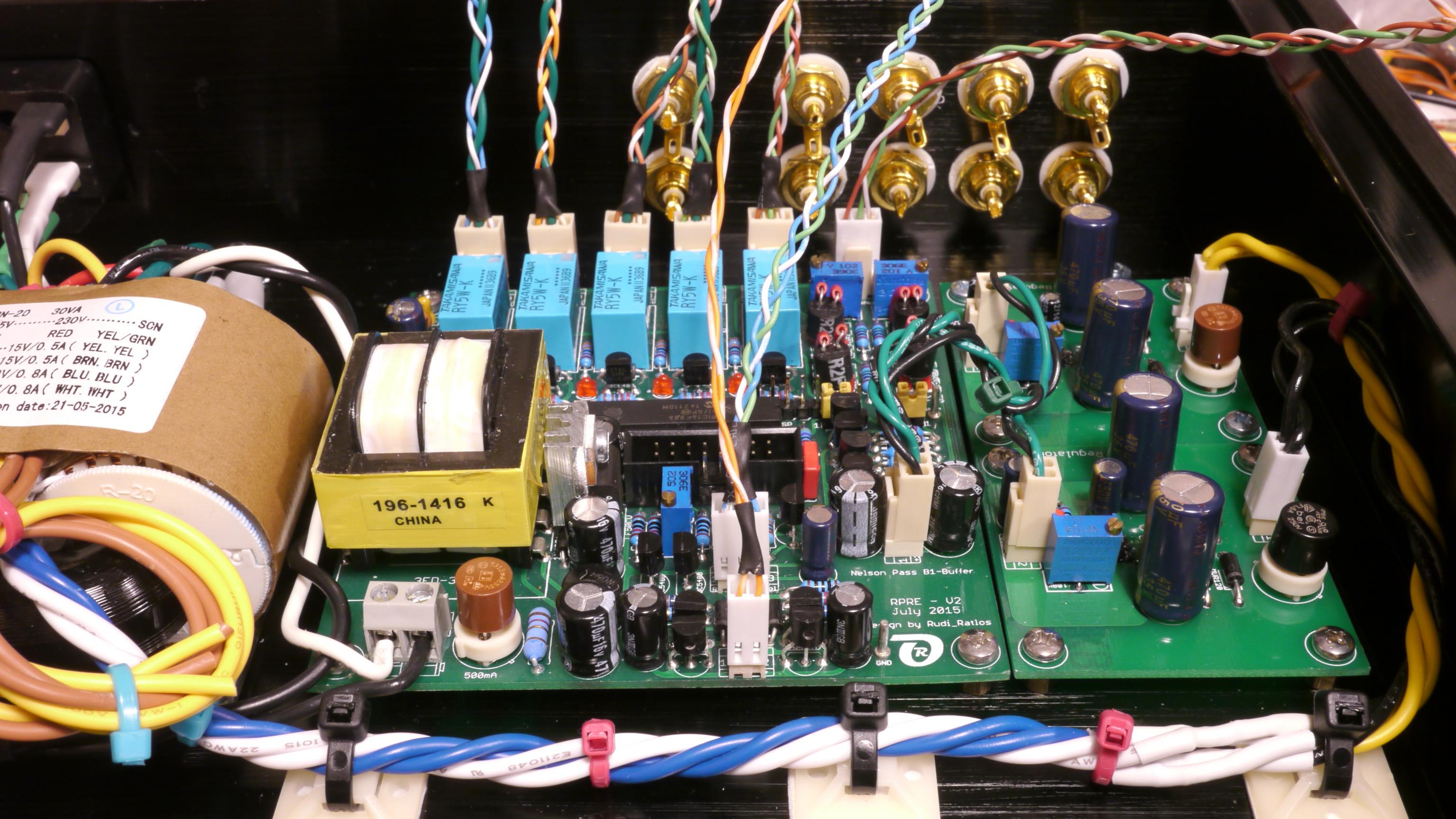

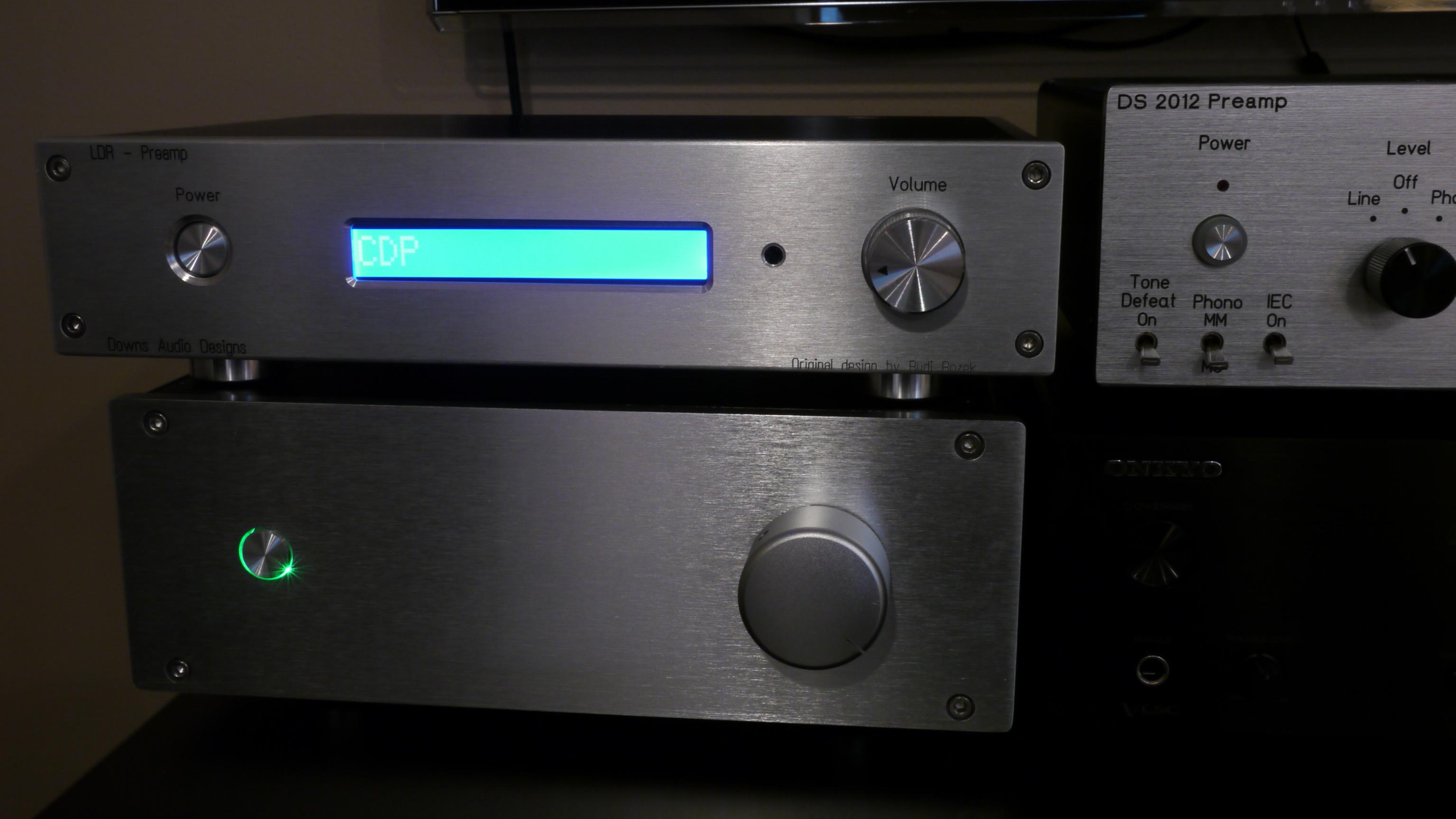

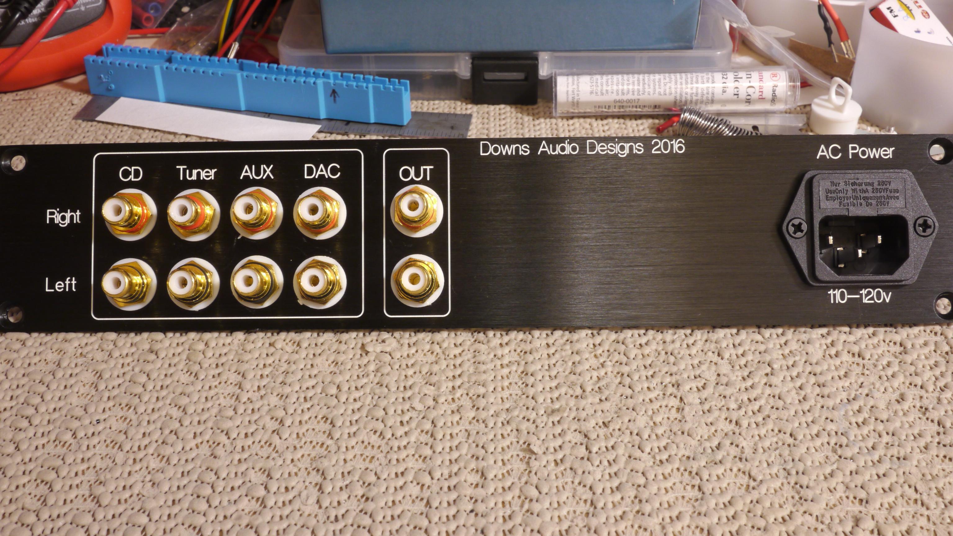

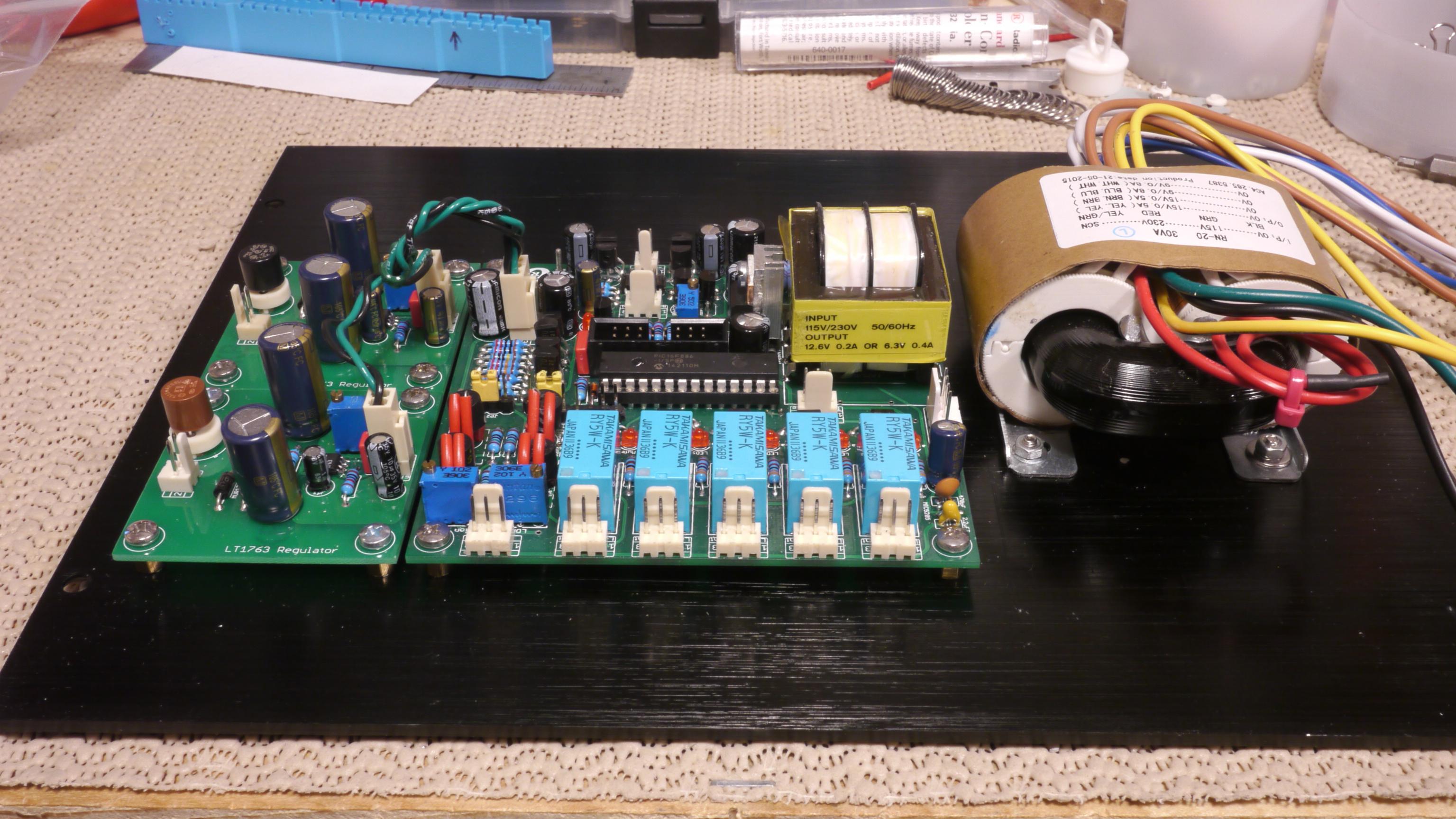

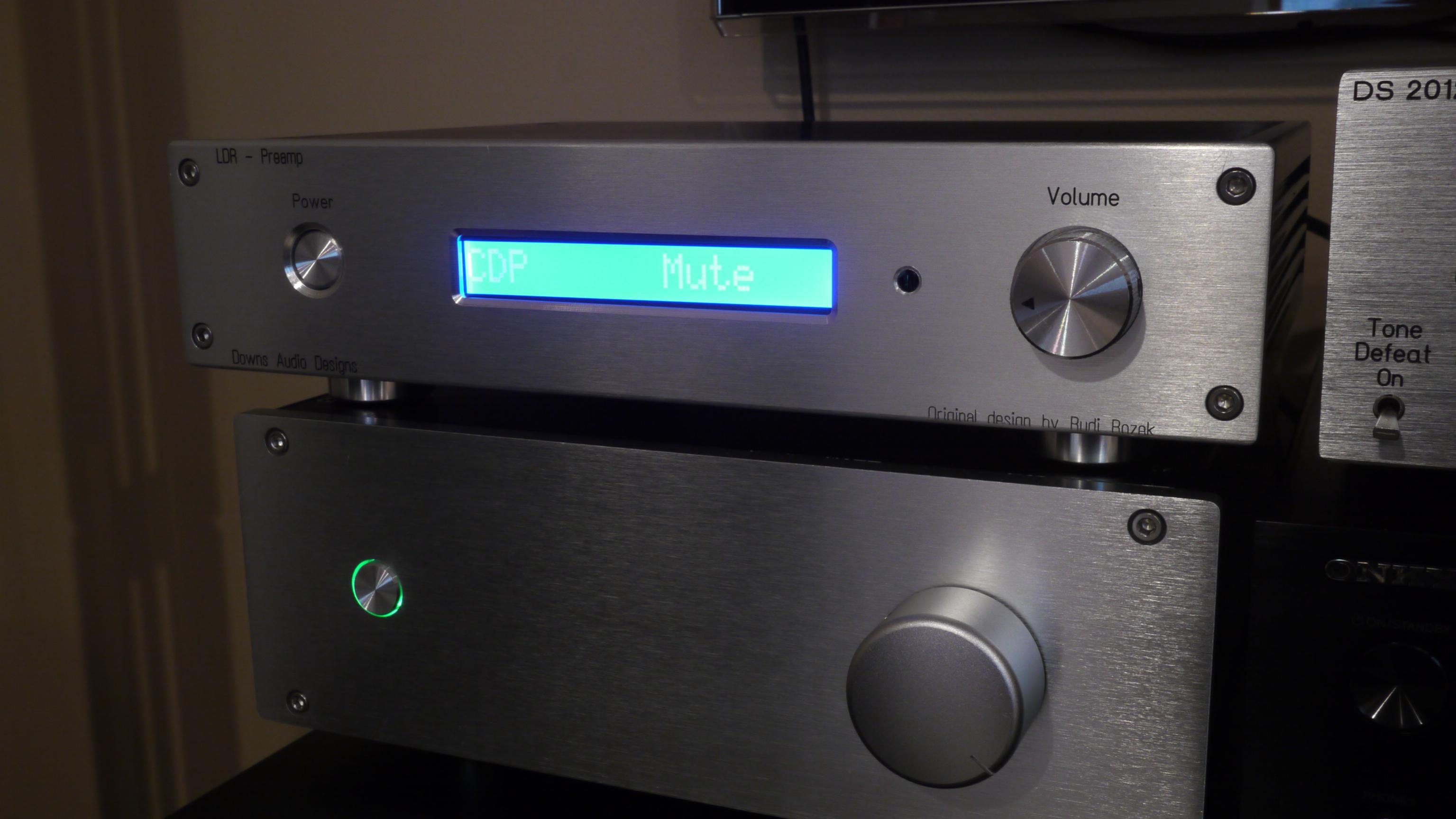

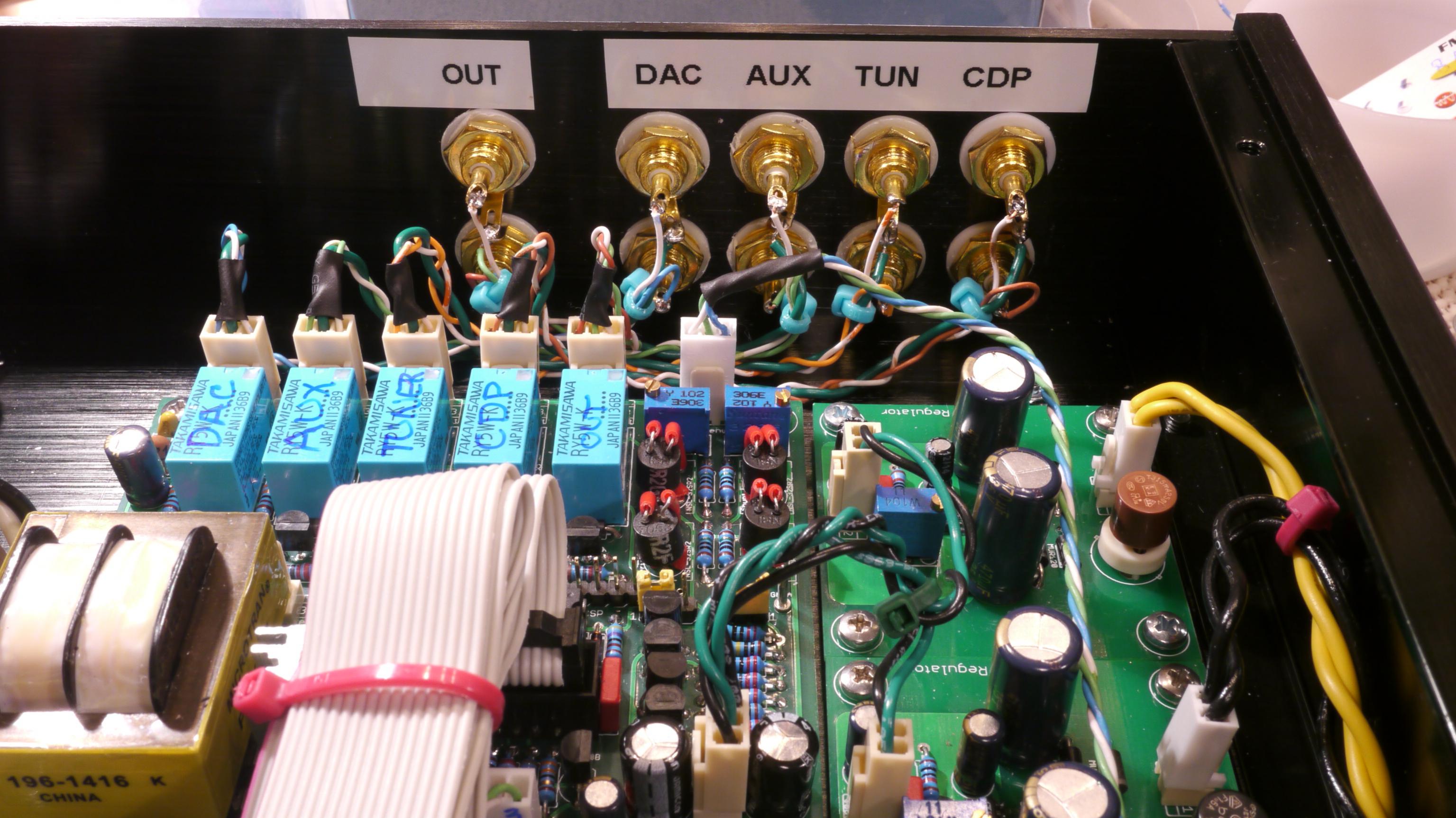

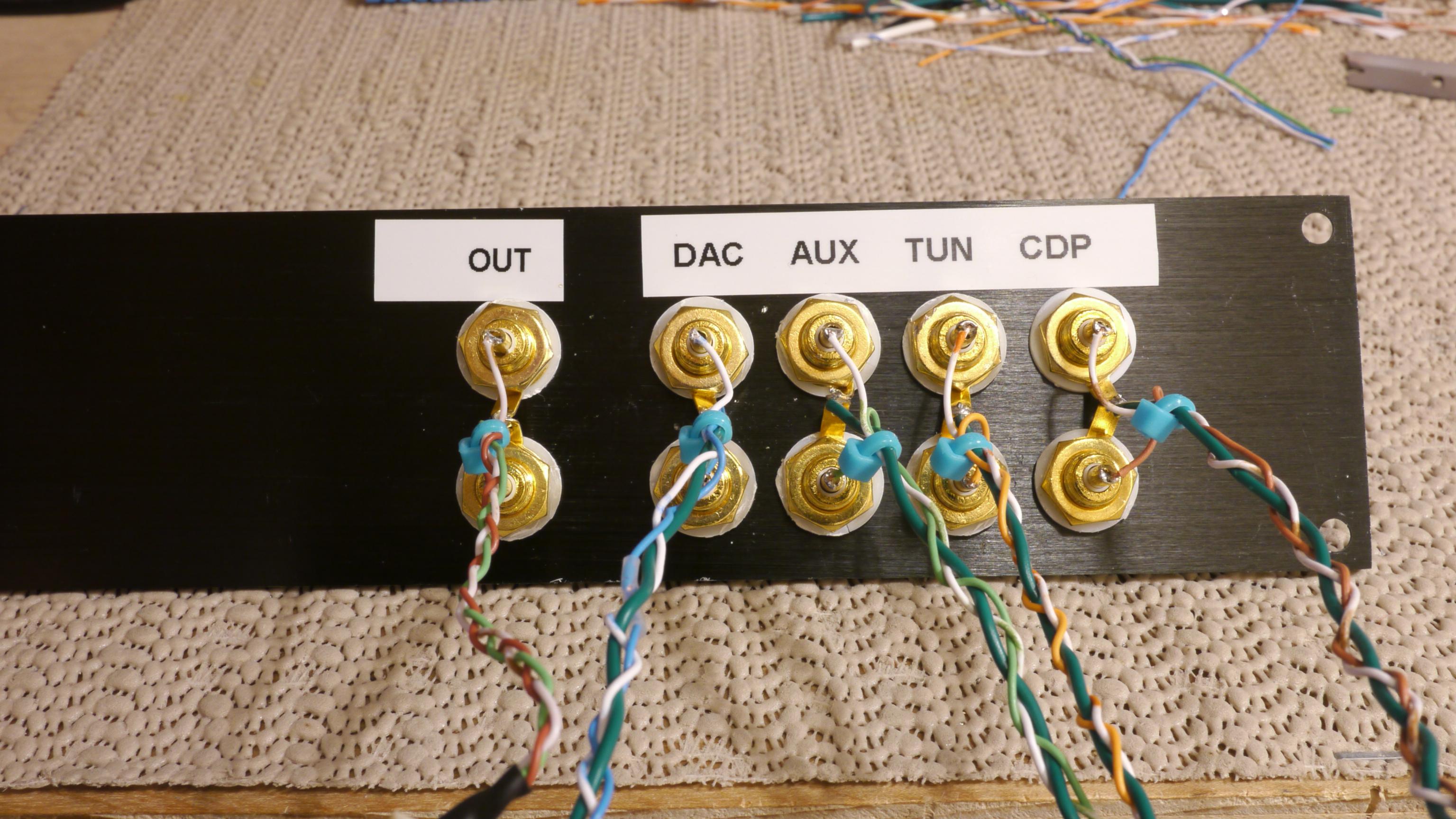

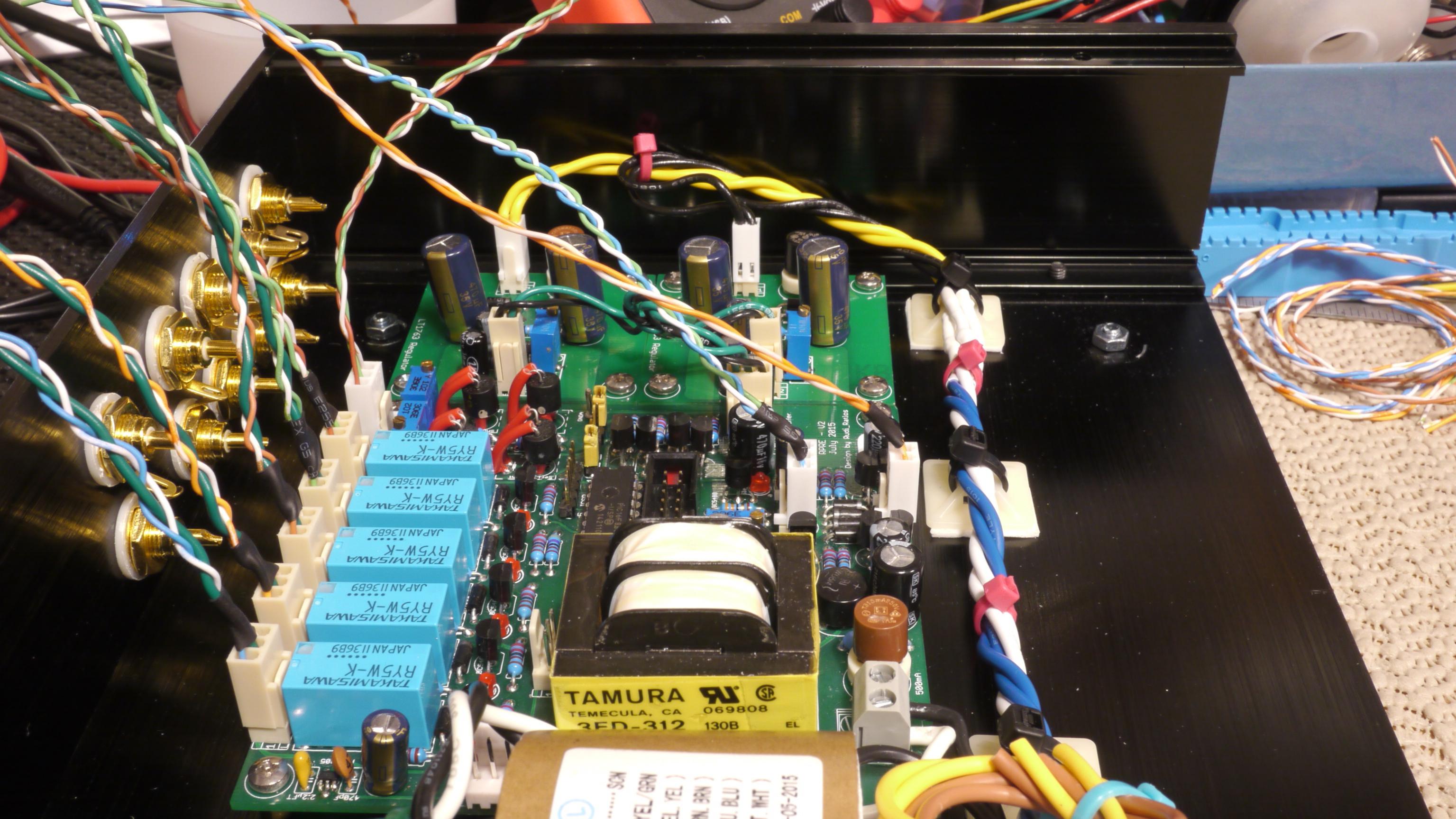

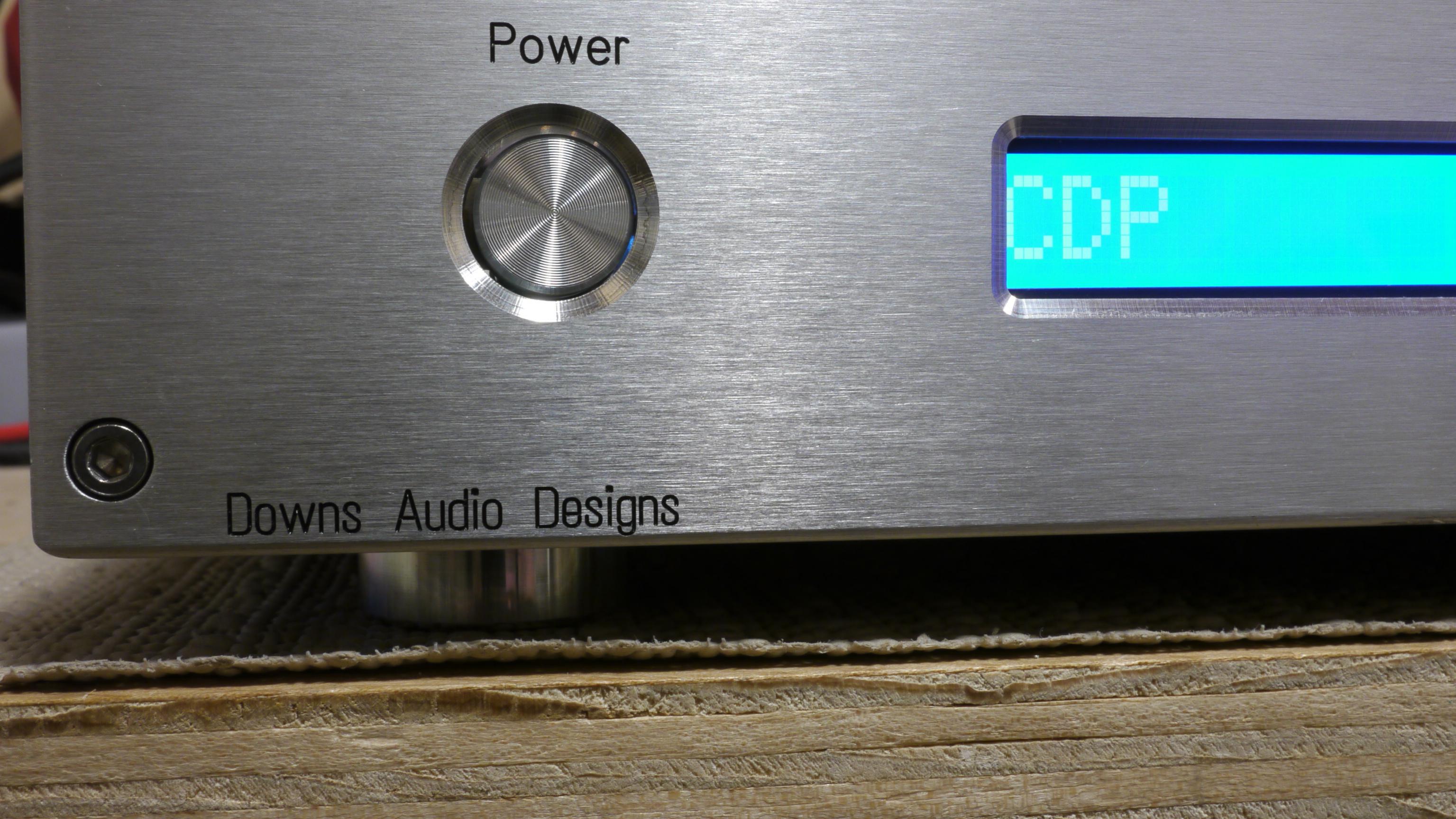

Thought I would share pictures of my latest project build - the RPre by Rudi Ratlos. This too is also an implementation of the LDR - Light Dependent Resistors. A few pics have been shared over on that thread, but I figured I could share them here too.
This project took a while to complete, just due to work schedule and life happening! Not enough time for the hobby. 🙂
I only had 1 little hiccup along the way. I had to replace the IR receiver that was called for with a smaller one that I could get closer to the opening on my front panel. Now the remote works from across the room!
I think it came out pretty good, sound terrific and is very transparent.

Thanks for sharing your project here. I'll be reading up on the project thread for sure.

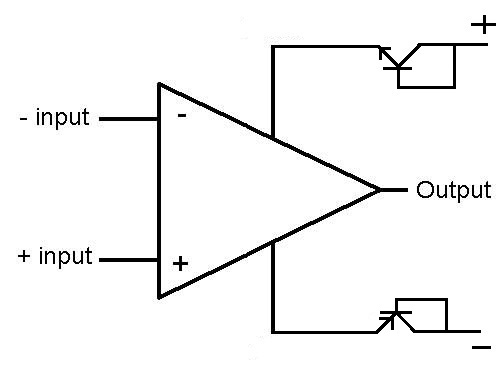

There are LDR volume control vendors who try to confuse control law linearity with signal linearity; in some cases I suspect they don't understand the difference themselves. Then there was the classic one who in his 'control circuit' tried to take outputs from the input pins of opamps, added diodes which were always reverse biased etc.; I think you may remember that discussion, as you were concerned that he would get you all tarred with the same brush!
Yes he called it a "pass transistor" for opamps (attached), total voodoo. He's now in cahoots with a N.Z. shyster (entrepreneur) making $2.5K- $4k LDR VC's and calling them Latte, Mocha, or something to do with coffee. They tried to get a Kickstarter con going for it but it seems to have died away along with the "pass transistor".
Cheers George
