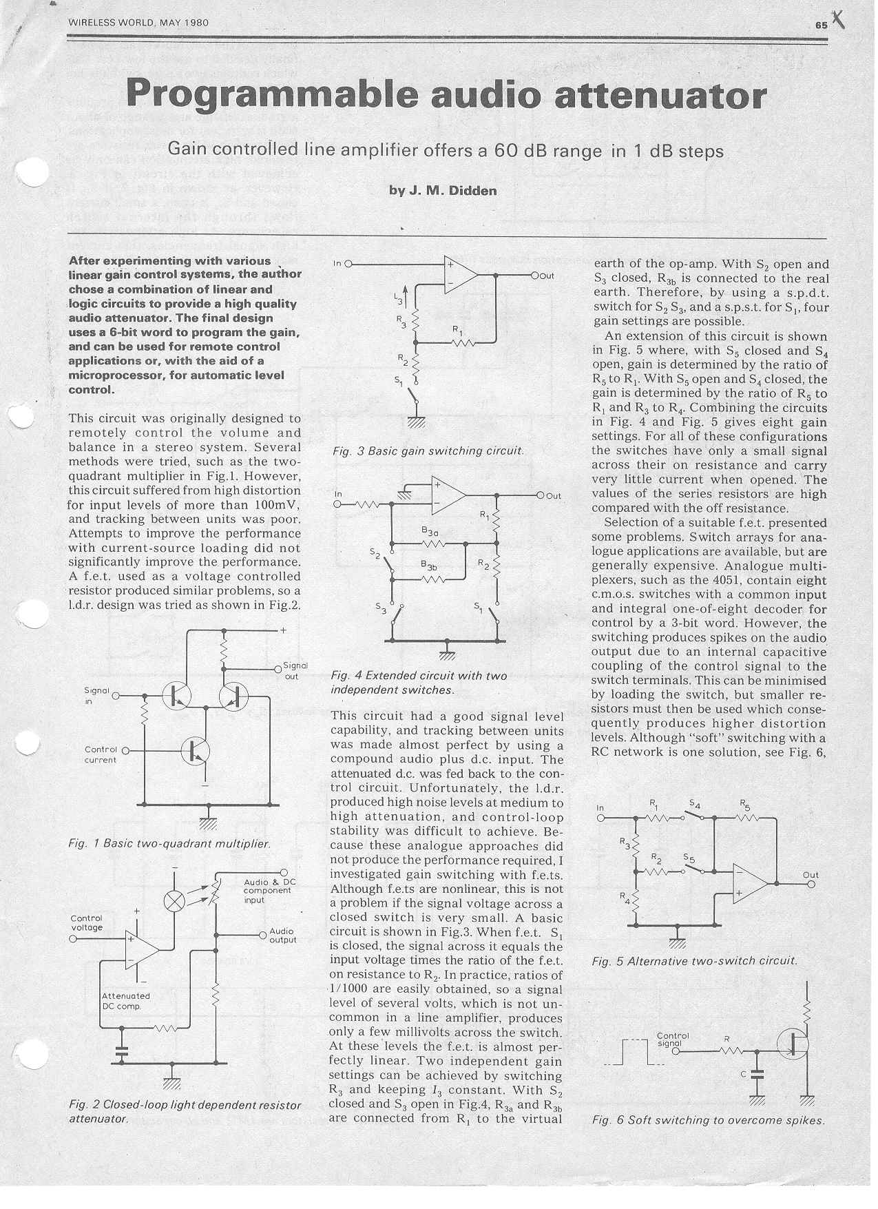

I vaguely remembered doing some tests with LDRs many decades ago. I dug out the first page of an article I did for (then) Wireless World, see attached. 1980. According to what I wrote then I decided not to pursue it due to .. too much noise.
Jan
Jan
Jan
