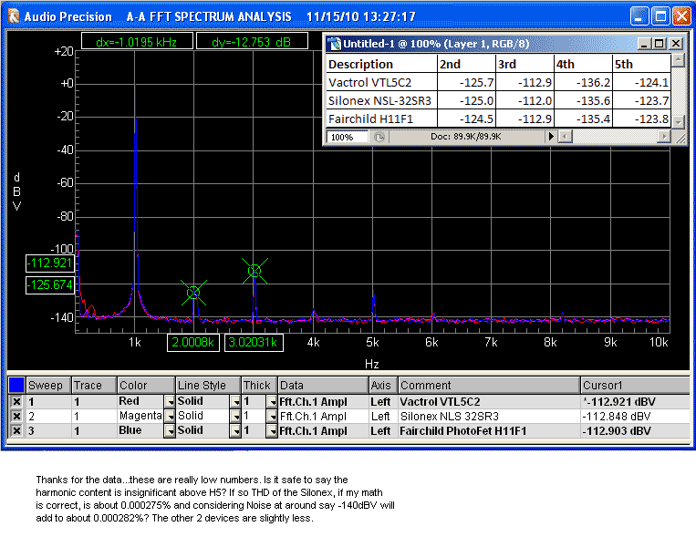

For the forensic scientists, what I'm saying is even with the lesser NSL32SR3 (thanks to jackinnj for his 2010 AP measurment) the 3hd is very low and the 2hd can over shadow it if the ldr is over driven, which in normal redbook instance will not happen, and yes the circuit has to be changed one day,🙄 keeps builders on their toes.
Cheers George
Cheers George
Cheers George
Thanks George.
Those H2 and H3 numbers are exceedingly low at over 100db down. No wonder I cannot hear any of it.
