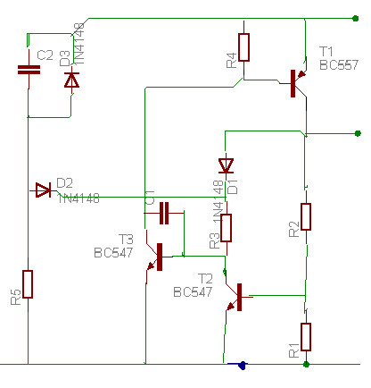

low drop out regulators
With one PNP transistor as Passing Device
and 2 NPN to control the voltage
it is very easy to build a low drop regulator
I use a capacitor and some diodes to give a start up pulse,
because I want the reference to be feed by the regulated voltage.
With normal TO92 you can build a regulator with 50 mA output
and a drop out below 0.200 volt
In principal you can use Op-amp style without output buffer
or a simpler variant where reference is set by the 0.65 drop of the feedback receiving transistor
I built one for 5.00 volt which only consumes 500uA and have drop of something like 0.150 volts (25mA output) and have fairly constant output voltage precision

Thanks for the reply, but could you possibly post a rough schematic of your concept?
This would help me greatly work out the principal behind your idea, sometimes it takes a while for things to settle in my head😉 🙂
okay I will try to draw it
It must be perfect - or the opponents will attack me at once
I am not so good with this "Eagle.cad" I downloaded
I will get me a scanner and use pen and pencil and calculator,
like I always do.
But I have no scanner, so I try to manage with Eagle
a lowdrop regulator, principally

I am quite satisfied, it was not that hard to do. 😉
R2-resistor can be exchanged
for some LEDs and/or diodes in series to set the voltage.
R1 sets an almost constant current flowing through R2 or LEDs
Halojoy,
Why doesn't that circuit oscillate?
It is 3 inverting stages with gain in a loop, with two dominant poles: the output pole (I assume there is a capacitor from the output to ground) and the pole from the Miller cap.
Looks like you have to be careful with the design so that the transmission zero from the Miller cap happens before the unity gain frequency, otherwise it will sing.
-- mirlo
mirlo said:
Halojoy,
-- mirlo
Well, build it and see if it oscillates.
I guess you know how to stop it.
I usally can make it stop. If it likes to swing.

mirlo said:
Halojoy,
-- mirlo
I do not know why my circuits,
which are in use, doesn't oscillate.
😱 Maybe some magic voodoo 😕
