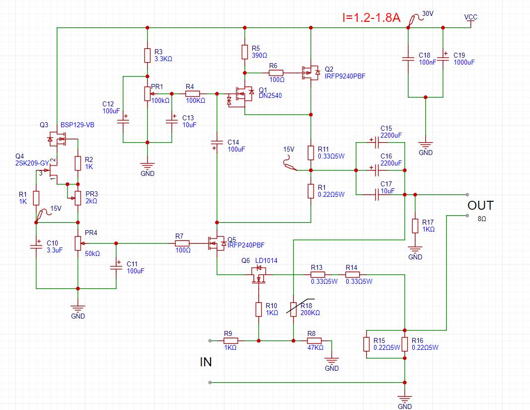

第一次发主题贴,什么都不懂,由于语言问题无法具体叙述。敬请大家谅解 !
Translated by https://translate.google.com:
This is my first time posting on a topic, and I don’t understand anything. I can’t describe it in detail due to language issues. Thank you for your understanding!
现在的问题是要不要加2路反馈,或者只保留一路负反馈,实验时很难把0.22欧姆这路反馈調好,个人意见?是不要该反馈。特向大家请教 !
The current question is whether to add 2 channels of feedback or only keep 1 channel of negative feedback. It is difficult to adjust the 0.22 ohm feedback during the experiment. My personal opinion? Don't give feedback. I would like to ask for your advice!
