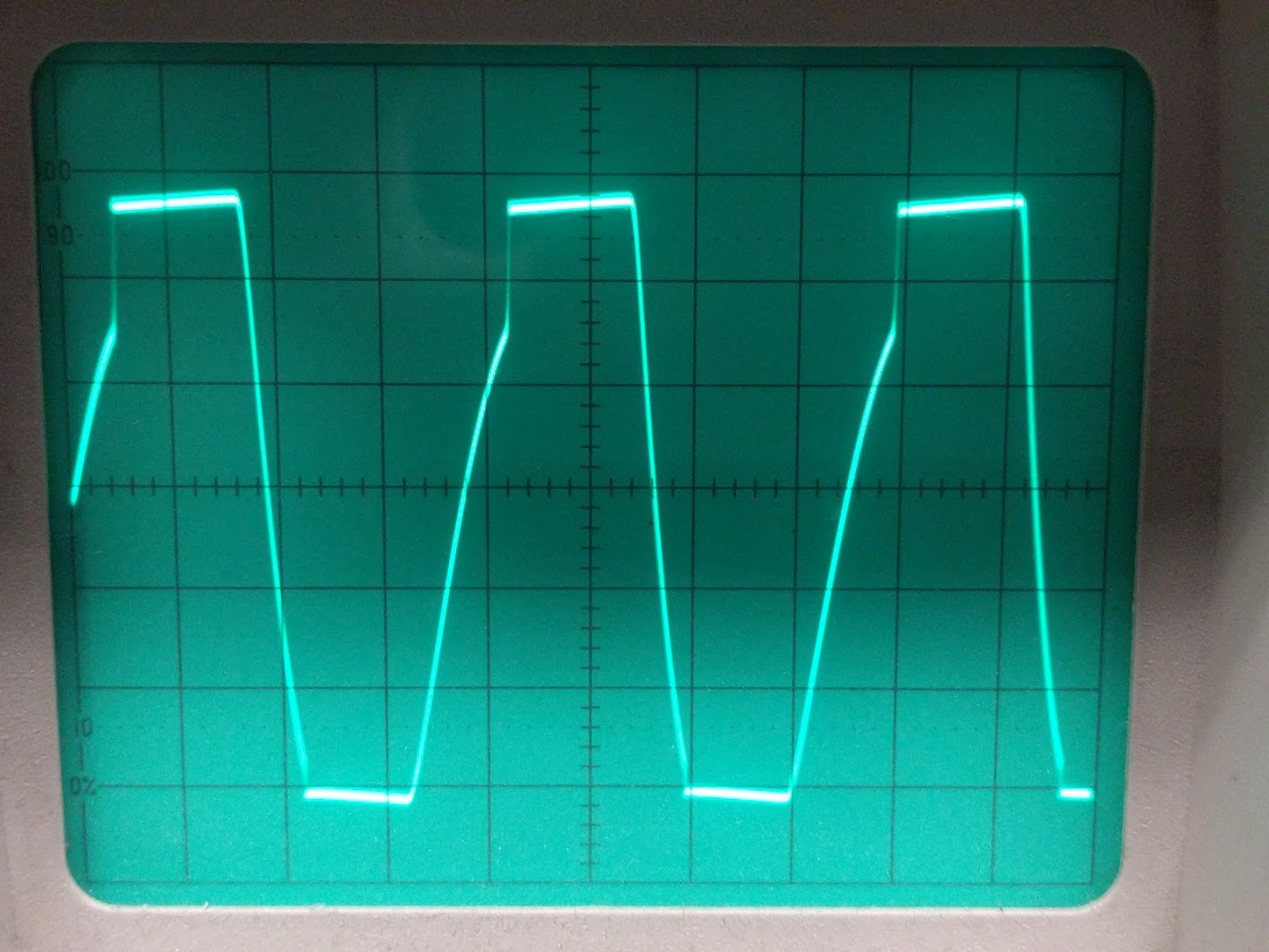

..my solution on a LD-XS200 (same PCB, same broken Parts..)
renew both C7/C8 with 250V/680µf (up to 1000µF is possible, max. height is 32mm, dia. max. is 35mm)
renew both ST13005A (not MJE13005!!!)
renew both PZT2222A..
renew both C4138 (BU2527AW works fine..)
check/renew C10&C12 (100µF/16V)
check/renew C11&C14 (1nf/1kV)
check symmetry as shown..(warning! an isolating Transformer is necessary!!! and use a 100W Bulb also.)..

Having fixed several of these amplifiers till now the main culprits are the two 100uF /16v capacitors C10 and C12. When these tend to lower their capacitance with age or as they start to dry up the oscillating frequency which should be around 20Khz starts dropping until with too low a frequency the transformer will saturate and the transistors blow.
Remedy, I fit a 100uF/ 50v rating cap instead of 16v I also use a good quality one here with low ESR. When frequency starts dropping all sorts of faults happen even the IRS2092 will lock on protection for no reason. Just changing these two capacitors cured this problem. Believe me I spent hours trying to find whats wrong on the amplifier side and at last finding the smps oscillating at around 12khz. I change those capacitors and the fault on the amplifier disappeared.
