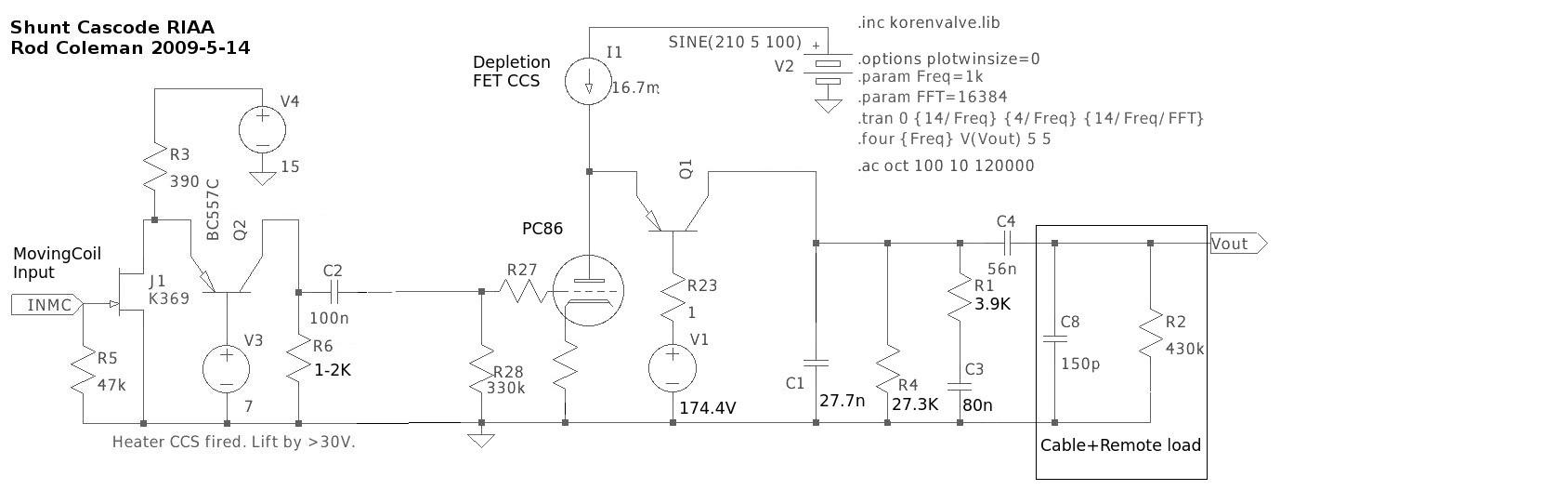

Hi Silviu,
If you prefer balanced, it should work fine.
Some other checkpoints:
For MC input, a low-noise JFET front end is recommended, unless you have a transformer already: see attached serving-suggestion, for the front end MC stage, this is what I use.
Please consider how the volume control will work, if the output of the RIAA stage is balanced.
You could use JC's circuit - but I can't say I like the 25000µF cap on the source resistor. Beware also that the 2SJ74 has gone out of production since the circuit was posted, and as a p-channel part, it is not easy to substitute.
OTOH, You can parallel multiple N-channel JFETs, in the circuit in post #43, if you have an LOMC.
One important point: bipolar transistors as the cascode element (NPN for series cascode, PNP for Shunt cascode) measure better than series cascode with triode as the upstairs device, and to my ears, sound better too. It's all about gm in this position.
Hi Rod,
The thing is I have a lot of 2sk117gr, 170bl and 2sj74...
I'll go your way since transconductance in BJTs is unbeatable.
My cartridge is Ortofon MC25FL... I don't really know much about it.. It came with my Thorens LP player..
Thanks for the support.
Silviu

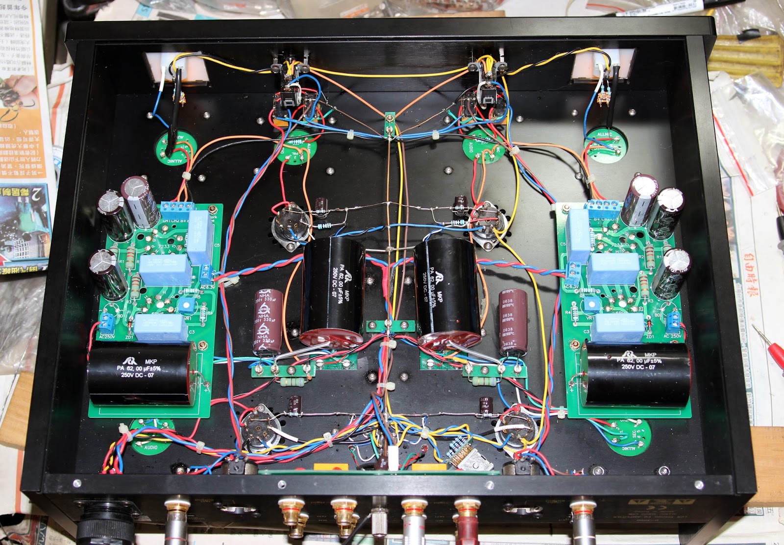

Very interesting I saw an internal picture of Allnic H-3000 without any prevention.
