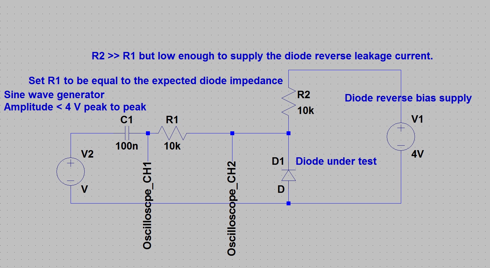

You should be able to power your diode in reverse bias through a large resistor, then apply your LCR meter through a capacitor to block DC. If this capacitor is (lots bigger) than the diode capacitance then the diode capacitance should be read on the meter. With 0.5V signal I agree 4V reverse bias should give a reasonably consistent reading.

I don't have access to an LCR meter. If a signal generator is available it's possible to use a series resistance and an Oscilloscope to measure the impedance. I have just used the technique to measure the high frequency impedance of an 8 ohm load.

Morgan Jones in Linear Audio - Volume 5 measures and discusses diode capacitance. For measurements at frequencies above 200 kHz a function generator and oscilloscope was used. Figue 8 shows the test set-up and also states 'the cost of an analyser that measures >200 kHz is prohibitive'.
I am afraid Morgan Jones is incorrect...there are many designs of "voltage network analyzers" which can be built for under $100. It's not Agilent/Keysight/HP but close for our work -- using off the shelf components.
