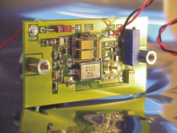

Lars, just a question, why didn't you just "sniff" the oscillator signal at the emitter and via an emiiter follower (BJT or JFET) feed the signal to the HCMOS gate?
Peranders: As you might have noticed i did that in the first version of LClock 1. However i found that the noise at the xtal directly is lower, so you can get a better performance this way.
Lars Clausen said:And here the photo of the LClock XO from the above schematic.
That's the one I have.😀
Maby with some very minor differences.

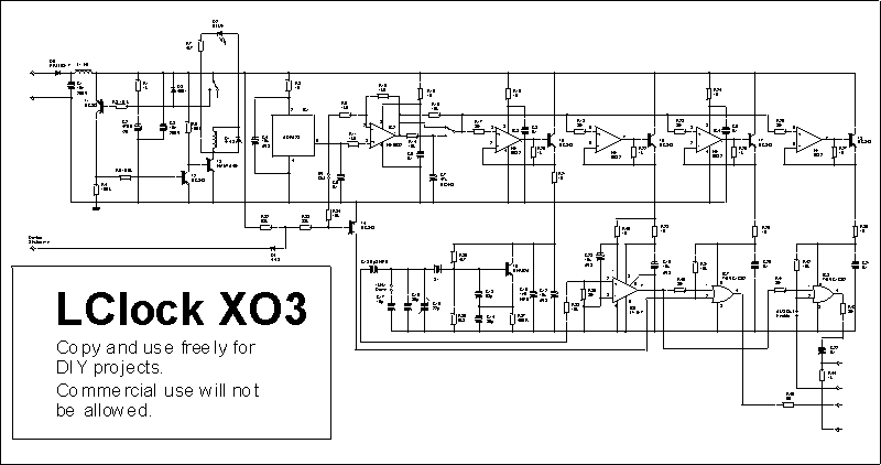

Here are the schematics of LClock XO3.
If you attempt to build it, please bear in mind, that full performance level can only be expected if the clock is built on a 4 layer PCB.
The drawing is a bit blurry, but i think you get the idea of the circuit anyway.

Thanks for the schematics.
Since you are concerned about the supply noise, you might use lower noise opamps than 5532. I’ll not make a problem if I’ll see next year you use this advice for the commercial purposes.
(I saw one supply that, I suppose, has lower noise because it uses lower noise opamps and slightly quieter voltage reference… Elso uses it for his own DAC, ask him for the schematic…)

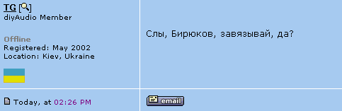

PS: Would someone say what does mean zavjazijvaj? And what is that font?
