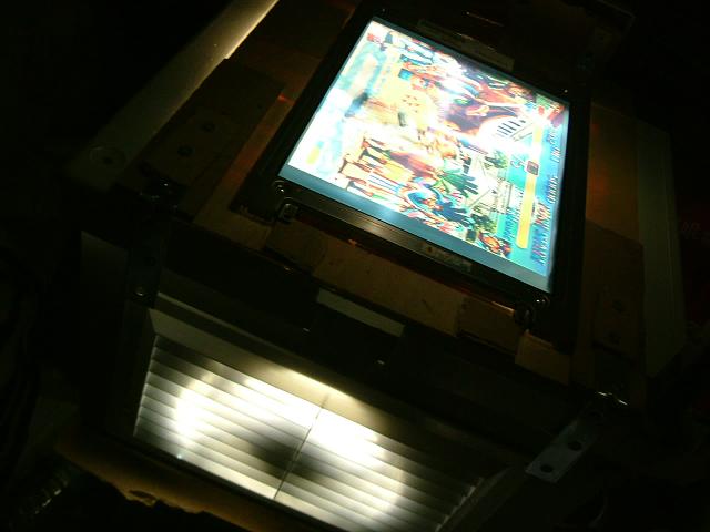

this is the lcd its a 640x480 ctx? 540 something like that. with adaptor etc already taken apart. no dead pixels (maybe one) works nice. small scratch on screen. but i really dont knowa bout shippping to canada
