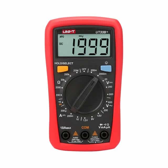

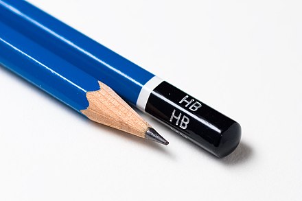

I use these two devices. I interface them with a thin-format flexible sheet made of fibrous cellulose. This stuff is amazing - you can make permanent or semi-permanent marks on it, and its self-datalogging! What will they think of next?
There are a whole bunch of symbols I've learnt that can be used to describe concepts, numbers, even imaginary stuff.
Anyway, once you get to grips with manipulating the pointy stick to make marks representing the symbols on the flexible sheet, you can record the information off the measuring device, then put that all into some dampware I've developed over the past 60 years to run the diagnostics!

That's what I thought, at the moment I have two multimeters hooked up to make sure everything is on the up and up. As the tubes age and settle down, I would like to avoid getting out of hand particularly with expensive tubes so having an LCD showing the status would be nice.I think there is definitely a market here for some green thinking that would require the sort of monitoring described in this thread. I am thinking of two useful adaptions to the amplifiers I have:
