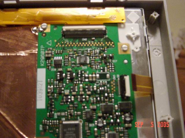

Any suggestion how to extend these two cable from LCD screen? as you can see the cable is right on the top and right I can't move them to anyway either top or right .... I need some input from you guys how to play this now...

I've never done a cable extension, but I'm quite sure its the small cable to the right in that picture that you extend. You raise the pcd board to be at 90 degrees from your screen, and then the extension would loop from the board to the side of the screen without interfering with sight.
You'll have to find the type of cable you have to extend (the number of connectors and the space between each ) to get the right cable. lumenlab.com sells some general ones that might be what you want. In order to take the cable out you'll have to either raise the little door that is holding the cable against the board or see if its two tabs on each end holding it in. Try to find an little triangle on whats holding the cable down. It should tell you wich way it opens.
