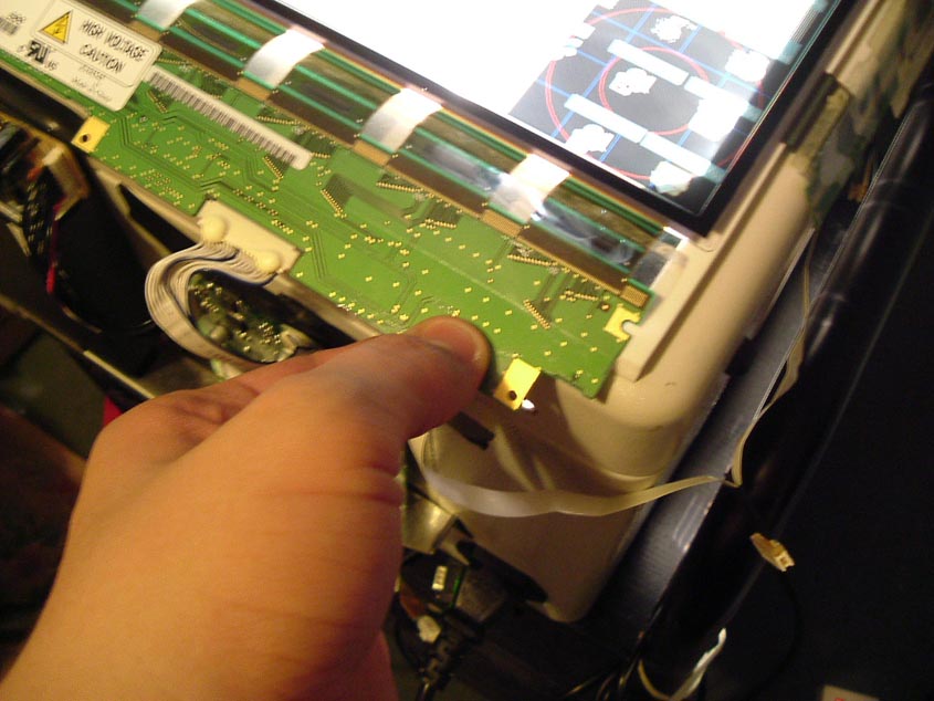

I had a search around but I didn't find anything that was quite like my problem. I've got a problem with contrast with the panel from a Samsung 152V.
The problem appeared overnight. I've attached a few photographs to show the problem (excuse the not-so-great quality). Basically, I the contrast of the image is very poor until I squeeze around the FFC ZIF on the pictured board. As soon as I squeeze the right area, the picture comes back to life. The harder I squeeze, the nicer the picture.
However, if I do this with an insulated object or while wearing gloves (to insulate myself), squeezing has no effect.
I've checked the FFC connections with a multimeter and they're fine. I've also checked for broken traces on the board with the ZIF and I can't find any. I can't find anything that looks out of place.
I'm a bit puzzled as to how to fix this problem. Any help would be much appreciated!
Matt
Attached picture: Squeezing the ZIF area

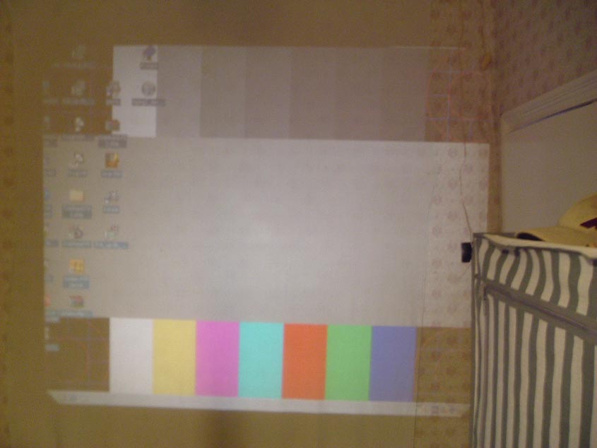

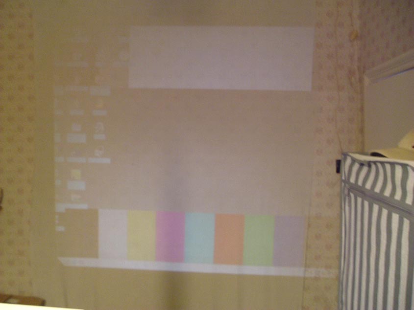

...and a picture of how it looks when I let go.
(One thing to note is that sometimes the colours could be considered "inverted" when there is a lot of white on the screen - the Windows 2000 startup screen, for example, looks inverted).
All sorted. Turns out that a certain pin was getting less voltage than it needed (had 0.97 when it needed at least 1.5v to look good) so I tapped a suitable amount off a nearby pin.
I suppose I should really work out what caused the voltage drop, but... Nah.
