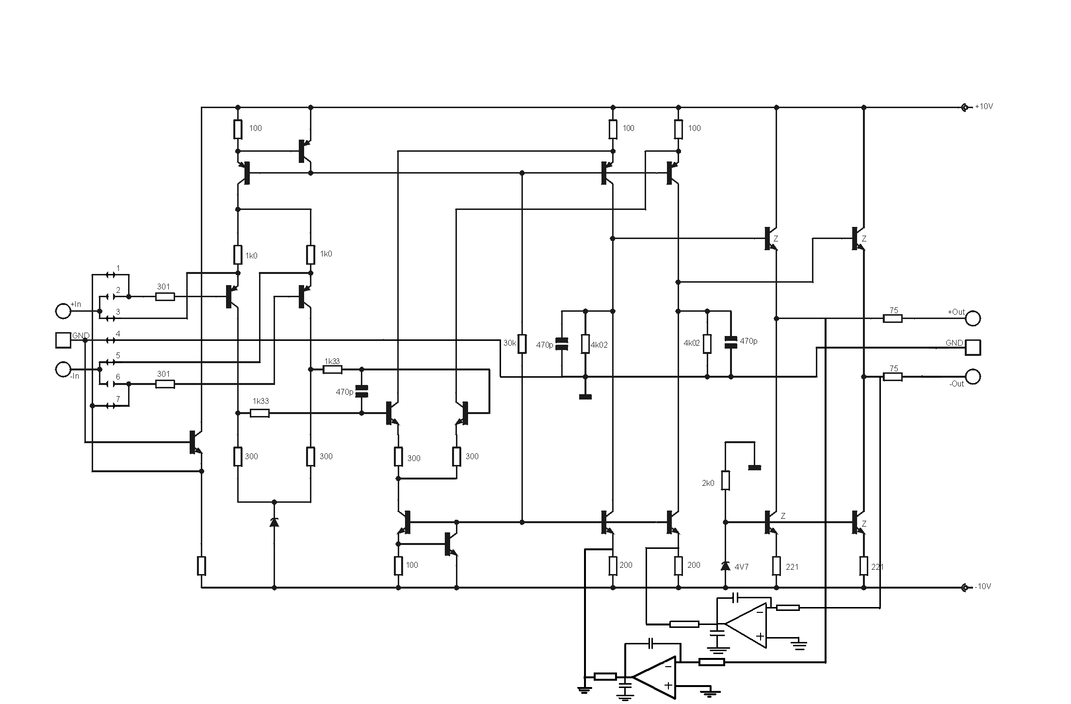

Has anyone used the ZAPfilter from LCAudio to replace the opamps in a CD player or DAC? Is this any good? See http://www.lcaudio.com/zapfilter.htm

Do you know if the BJT are mathed. What is there parameter they are working after if they match them?
Im not trying to stop you but that's maybe the reason why they publish there designs!?
In the old work they did for High Fidelity in denmark they did mentioned that you would get a higher performance by matching the BJT. Why should they have changed there point of view.

They were Zetec or something similar for memory. circuit below with dc servo included.
Cheers George
