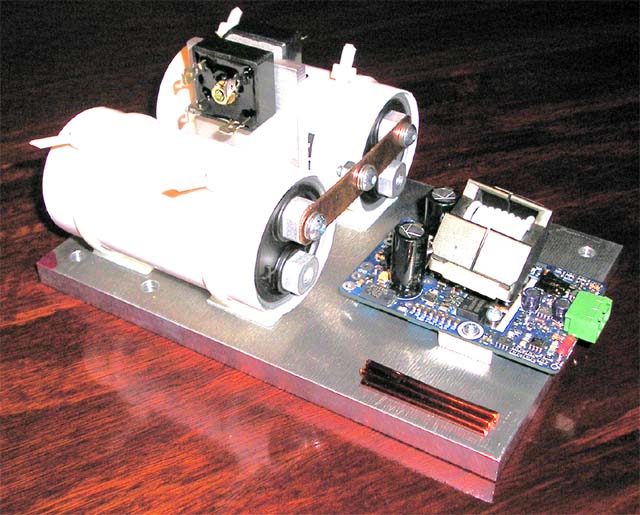

Some time ago I tried 2.2SE modules with electrostatic speakers with quite impressive results. The modules outperformed a reputable class A amplifier convincingly.
Would you recommend (any) modification of the Zap's when used for driving ESL's considering their highly capacitive & reactive nature?
To narrow down the load conditions let's assume Quad ESL63's 😉 (988 and 989 are quite similar). Their impedance, phase and equivalent RLC circuits are readily available on WWW.
Zvon
Zvon: The ZAPpulse modules specialize in driving highly inductive or capacitive loads with no problems.
You should not have to modify the modules at all.
I can only recommend using short leads between the modules and power supply, to minimize the sonic influence from inherent power supply pumping, found generally on half bridge Class D amplifiers.
All the best from Denmark 🙂
Thanks Lars,
The module photo is attached.
The power supply leads will be 3mm dia. copper wire (filed on one side to fit the ZAP mounting holes).
The wire length will not exceed 25mm (1").
Double oridnary bridges (35A/400V) with 22nf across each diode.
Power supply capacitors are 22,000uF/63V RIFA's, will bridge them with a smaller high capacity films or ELCO's.
Regrards,
Zvon
