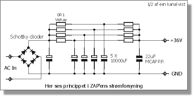

Just wanted to add the schematic to our solution discussed. So easier to follow.
Sorry the text is in Dansih language, but the schematic should speak for itself.
The resistors ensure that the charging spike is equally distributed over the entire capacitor bank, and also equally discharged from all 4 capacitors to the amplifier.
I will just emphasize one point, so everyone in here can understand, also Fred: Only the positive side of the power supply is shown here on this schematic. There need also be a corresponding negative side of this power supply circuit to make it work properly.

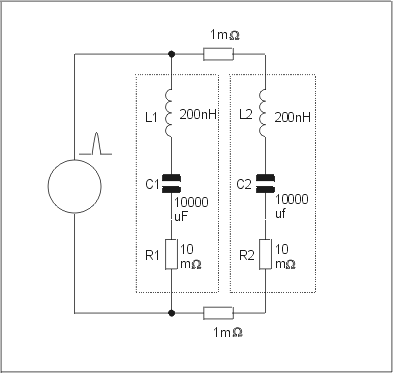

Nelson: Then consider this setup of the two capacitors in parallel, when you view it as the capacitor's practical equivalent circuit.
As you know every capacitor consist of a capacitive part (obviously), an inductive part and a resistive part (last two from wire leads and internal windings of the aluminum foil). There is also a fourth part a parallel resistor, but it has no significance in this discussion.
When you have one capacitor it will act as a series filter with it's lowest impedance at one specific frequency. But when you parallel two caps, they can interact with each other's internal circuit. Especially if the inductance or capacitance is not exactly matched. (Which they can never be in a real-life scenario).
Consider the possibility that C1 might form a parallel resonance with L2 and vise versa. Might occur if the parallel connection resistors (here 1 milliOhm) are low enough. I think that anyone can see that would be a problem in your amplifier power supply.
In the V4P circuit shown above, the problem is eliminated by breaking the circuits apart into separate series filters.

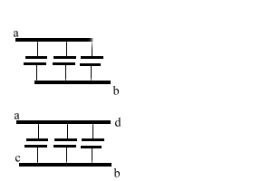

What about the following solution? The upper one is frequently
recommended as "the proper" way to connect PSU caps in
series to even out the lead impedances. The schematics are
intended to reflect the physical PCB layout.
Now, what about extrapolating from this to the lower figure,
where I intend the bridge connected between a and b and
the load between c and d. I don't think it will even out
differences between the caps (too late to think properly now)
but at least it evens out the lead impedances and you get
rid of the extra resistors. These may be beneficial on the bridge
side, but hardly on the load side, or...?

But do you really gain anything from parallel caps instead of
a single bigger one i this case since the resistors add to the ESR?
