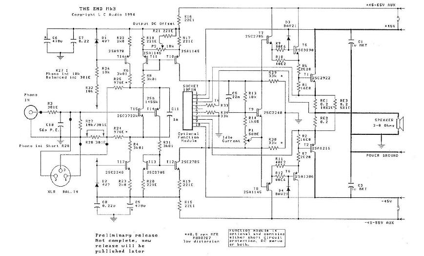

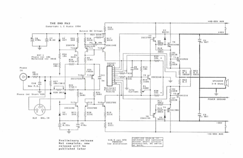

rellum said:Hi Olsen,
I'm a "millenium XP" owner and I don't have an end 3.1 schematic. Are those 301R the serial input base resistors ? If so, don't replace them. It will be of no help for gain setting. You should rather look at two resistors wich are in // with the inputs. Or simply measure resistance between each input and ground with a dmm. If close to 2K, those will have to be increased.
Best regards,
Francis
Hi again!
Yes it is The End Mk3.1. I dont know what serial input base resistors are
Thank you all for your quick response 🙂
Olsen
Hi Olsen
I just found the attached schema wich seems to be the one you refer to. And it's way different from what I expected. It has no differential input stage and isn't suited to be feeded passively on it's xlr input. I can understand your feeling of lack of gain. I guess you want to increase R27/R28. You can try it, it will help but 10K won't suffice and will alter the log behaviour of your attenuator. Use rather Andrew's recommended value : 47K. Offset shouldn't become an issue if loose connection, as the base currents should cancel nicely.
Last thing, the way it's done on the End MKIII, driving the xlr input without a low impedance buffer, you will loose most of the common mode noise rejection provided by the use of R24/R25.
Best regards,
Francis
Best regards,
Francis
