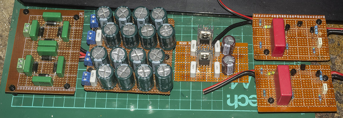

I'm building a PSU for a phono preamp and am unsure how to arrange the various stages.
Obviously, the transformer comes first, then the rectifier, but how to arrange the next three stages - capacitor bank, then voltage regulator, then ripple eater?

Mains > switch (live) > fuse (L) > EMI filter > inrush > transformer > rectification > inrush/surge control (caps) > reservoir caps > regulator > filtering (various types) etc
Put crowbars, fuses, current limiters and filtering as needed.

Very much dependent on the pre circuit. If it is an opamp like LM833 or discrete transistors, which need more and low noise filtering.

I didn't mention the socket, switch, fuse and filter as those are prerequisites and it is the portion downstream of the trafo I was concerned with.
I already have the various parts built, I was just not 100% sure what order to place them in.
The circuit to be powered is a Boozhound phono preamp.
Is it? It's just a pair of 7818 regulators using the circuit from the datasheet, I happened to have the ripple eaters, built them years ago and never used them, so I figured this was a useful application for them.
