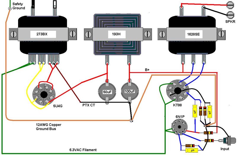

I have attempted a layout for the SE KT88 monoblocs I'm planning. I used TubePad and some things, such at the TXs and choke are not to scale but the idea was to organize the general layout and keep the AC away from the signal.
Comments requested.

Thanks to everyone for their feedback. This gives me a good idea of how to proceed. I'm thinking of using 1/8" aluminum plate to mount the components and Corian for the base. It does appear these will be large- maybe 14"x10" each.
I'm actually trying to decide if it would be better to turn the OPT or the PT but you are right- one of them needs to be oriented differently!
Good catch! I had written 50uF on my planning sheet and I've been going with that value. I checked a couple data sheets and you are right. I'll definitely back it off to 40uF.
I wrote 6N1P on the layout but actually used the pinout of a 6922 I believe. I'll double check that. I'm waffling between a 6N1P which is in the original schematic, a 6922 which I have in my bin, and a 6DJ8 type.
alejo said:I think you must to rotate 90 degrees the OPT (1628 SE) transformes to others transformers. to prevent Humm....
pedroskova said:I'd back down on the input cap, IIRC, max specified first cap for a 5U4G is 40uF.

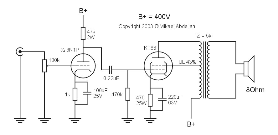

jane said:Seems to me that the grid on GN1P is not connected to earth?
