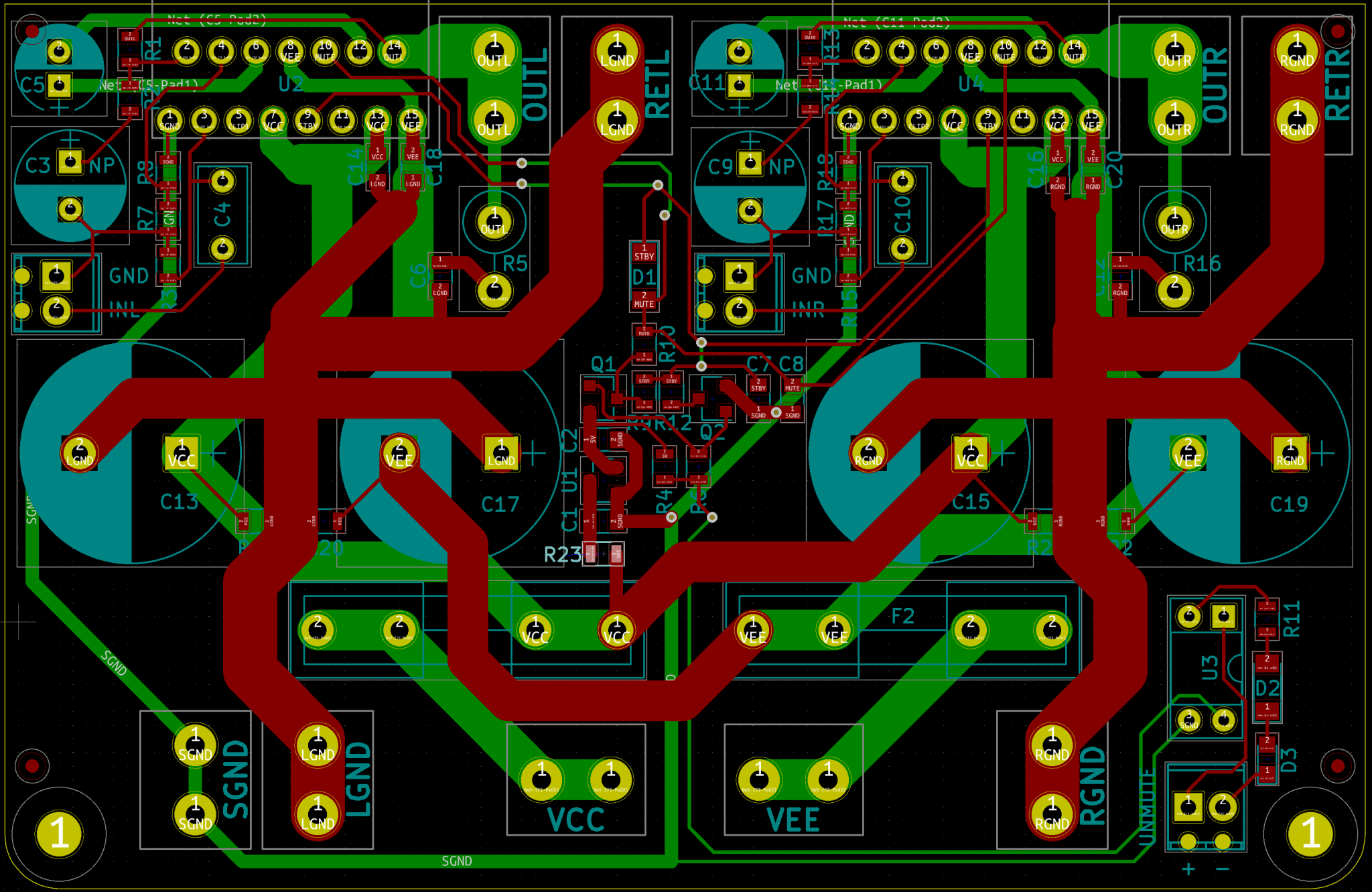

Hi all,
I recently made some stereo TDA7293 boards and am now working on a Rev.B because I realise, in hindsight, that my grounding topology is not particularly great (this is unrelated to my previous post about hum). One constraint I face in particular is that, for reasons of space and packaging, I need to build multi-channel (at least 2ch) boards and I have no more than 50mm of PCB width available for each channel. Most of the small-signal stuff is SMD, so that helps a little.
One major problem I have is no means to measure distortion with any accuracy so I am somewhat working in the dark with respect to trying different topologies that I've seen people recommend. A couple of features in particular I have seen on other power amp boards are:

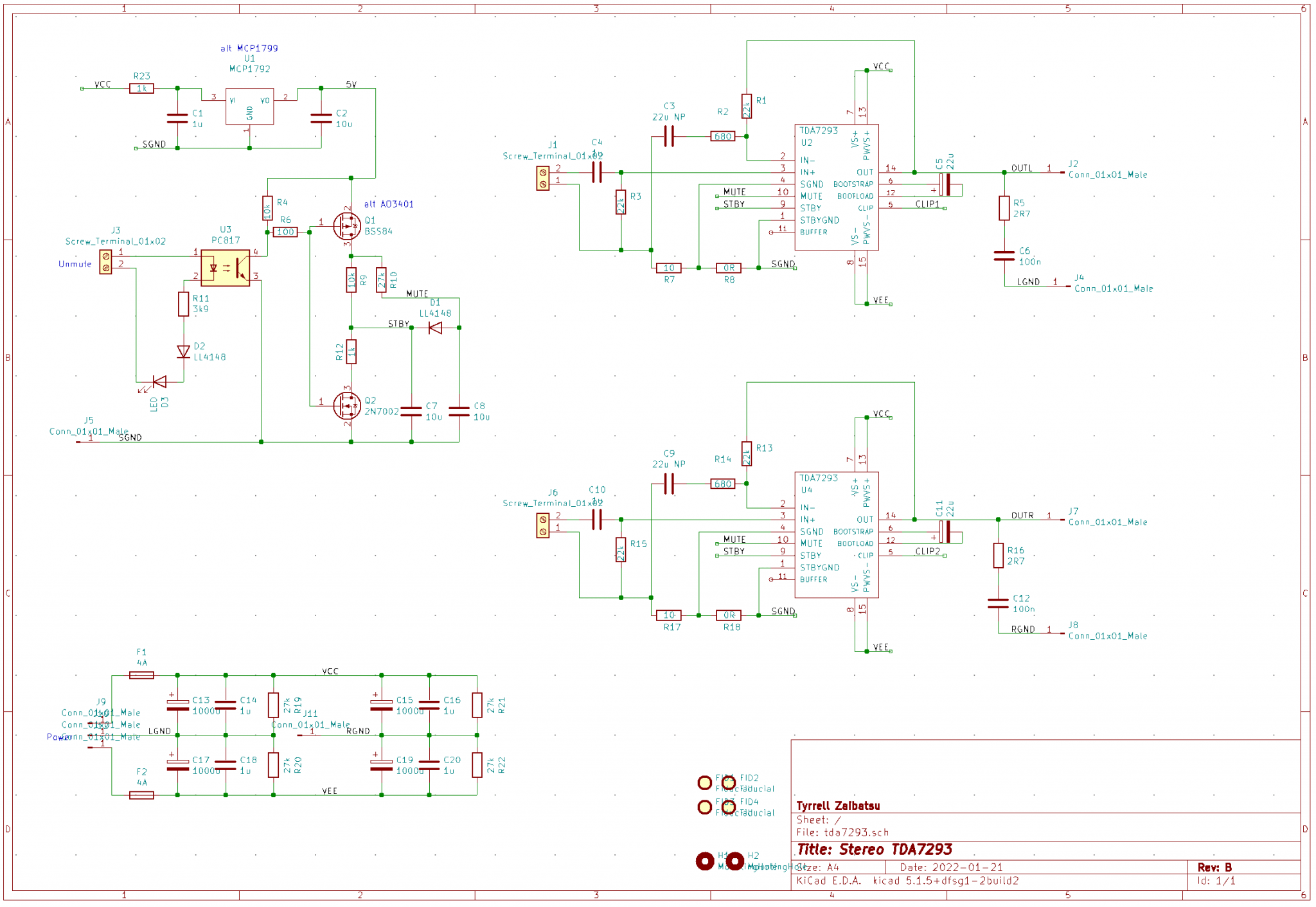

The reference design does not use hum-break resistors, and doesn't say what the SGND pin actually does. Should it be a stable local voltage reference? Should it align with the local system ground, or should it follow the virtual ground in the feedback network? What should the relationship between SGND and HBR be?
In terms of the speaker returns, I can see the benefit of not having a small copy of your output signal appear in PGND due to wire impedance, doubly so in terms of cross-talk on a multi-channel PCB. However, does it really matter if that noise on PGND is present if the whole amplifier feedback loop and ground reference are independent of PGND due to a separate SGND run? Yes there's direct cross-talk in the outputs from the shared PGND cable (200mm of 2.5mm^2 => 1.4mR => -75dB into 8R?) but that should be about it?

- 7293-a shows a single power supply (probably OK), no decoupling to SGND (correct I think), and with SGND/pin4 on the input side of the hum-break resistor (who knows; probably wrong?)
- 7293-b shows a split power supply using diodes (not sure), decoupled to SGND instead of PGND (probably wrong because of the diode, but maybe right if the Vs supplies were completely independent of the PWVs supplies) and with SGND/pin4 to actual SGND, with only the negative feedback path being on the input side of the HBR (who knows; probably right?).

OK I totally get not wanting to wade through my wall of hypotheticals. Maybe someone with concrete experience in power-amp PCB layout can critique a screenshot of a specific proposal... I've got both options in there wrt hum-break resistor; one of them will be a 0R.
(ignore the stuff in the middle, it's just UNMUTE-control circuitry).
