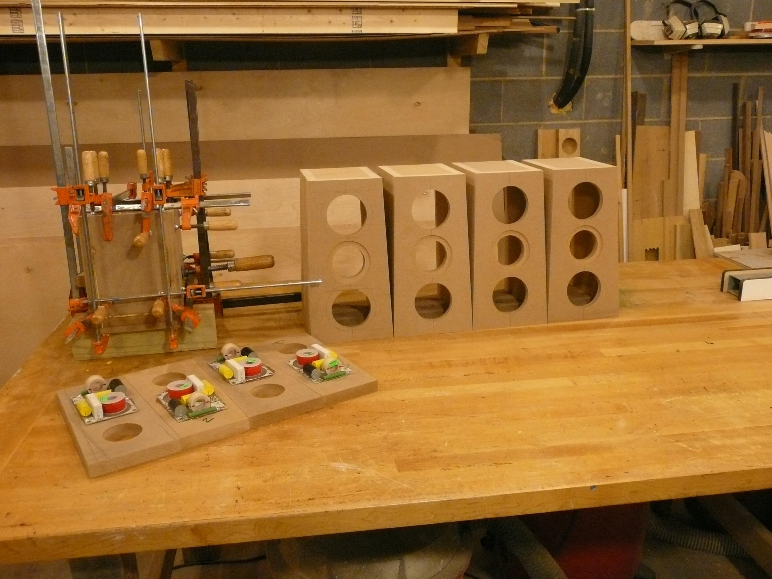

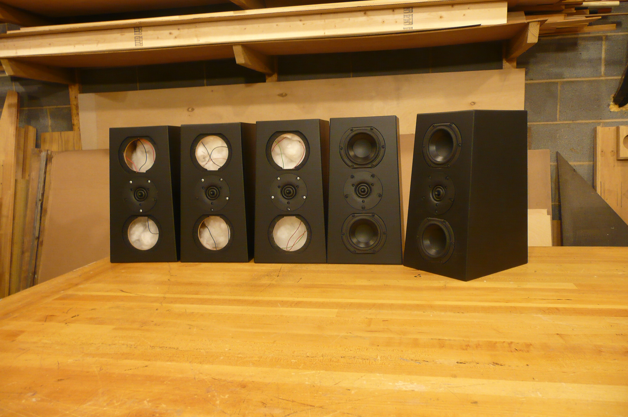

The center for my friend’s HT, we used a base reflex two-way, Peerless 5-1/4” woofer, #1591 and again the Morel tweeter. It’s a shame they stopped making that driver, that little driver can go down to 40 hz. I’m still using them in two listening areas – pic attached.
