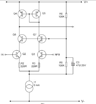

Assuming you addressed me? Thermal distortion comes from slow heating of the device which changes the parameters. Cascode keeps the device voltage wrt ground constant but not the device Vce, and not the Ic. The graph I posted showed that there actually is a reverse effect.
A bootstrap keeps the Vce constant and that appears to work much better, as shown.
The transistor doesn't know whether we call something 'Vas' or 'pupukaka' so that makes no difference ;-)
Jan
Hello
Could you suggest a practical circuit of a bootstrap cascode input ?
Maby something like the circuit in my image, does this circuit would have less memory distortions ?
Thank you
Bye
Gaetan
Hello
To everyone, for bootstrap cascode input, maby something like the circuit in my image, does this circuit would have less memory distortions ?
Thank
Bye
Gaetan
