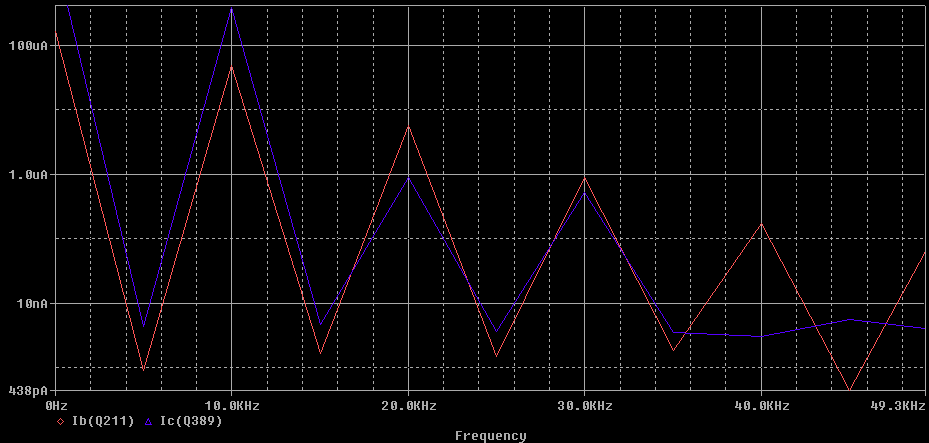

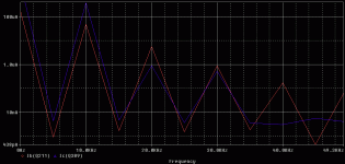

Edit: see attachment, vas currents to output currents, distortions from vas ~47 times lower.

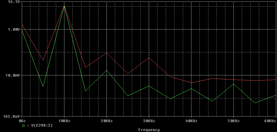

I am not talking nonsense, attached is FFT-plot from sims. Simulated is complete amp, no virtual fake devices, open loop
Red = normal amp, no extra loading
Green = same amp, vas loaded with 2x47k+ 2x330pf to ground
Red has 5.8 times higher distortion, 6 times higher gain.
Both have exactly the same outputlevel. (10.7v)
Openloop distortion, 1.0% to 0.17%, 5.8 times less work for the feedback.

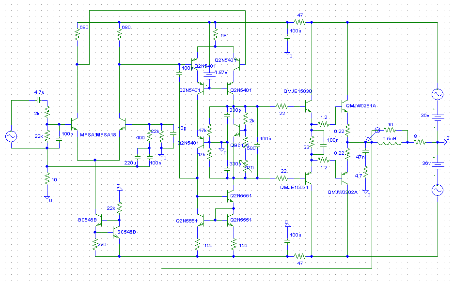

mikeks said:
How exactly did you simulate your amp open loop?
Schematic please.
Mikeks, i simply cutted the feedback path, and shorted the feedback node to ground.
With some trying/calcing i set the correct input signal and ran a normal transient analysis.
For the amp without the vas loaded, i had to increase the 22k at feedback node by 20ohms to keep dc-offset below 1v. I did not want the dc-offset to influence the result.
The cascode to the vas is a bit simplified, but doing it correctly does not change much.
The signal sources in the powersupply were inactive.
Mike
