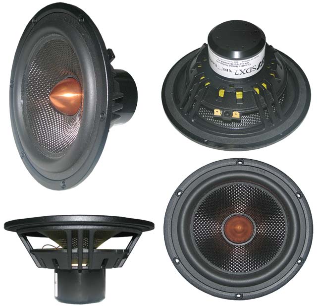

Add a pair of SDX7 and build aperiodic vents into the connecting band and away you go -- 1 would fit nicely as purely sealed... i keep looking for bowls here, but so far i'm striking out.
dave
I was thinking more of a standard vented project, but for the sake of information, what are the SDX7s?
SDX7 is best put into context by considering it to be the new & improved Extremis 6.8.
I love that it works sealed in 7-21 litres... the large end with careful room placement should balance very well with room gain, to get you into the 20s with minimum group delay & critical Q.
We are just now working up the 1st box -- a 14 litre sealed with a 2.1 plate amp to be mated up with µFonkens.
And a whole host of designs in the queue.
The full data sheet should be done later today and off to Bob for final approval.
dave
